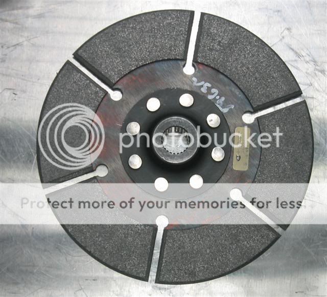

Luismj June 29th 2010 21:12
wally,
One friend use this clutch (made usa) in one drag beetle with 900+ HP.
He said it was very good. What do you think about this?

JK Fab June 29th 2010 22:26
That is a black magic clutch disc. A lot of higher HP vw guys use that disc with a stage 1 plate.
vdubzack June 29th 2010 23:29
I love this disc!!! Used to drag with, and can be freshened up by media blasting after a few runs. Almost like new. A little harsh on take off, but locks right up. Less harsh I found if hydralic clutch is used. also check out the Gene Berg dual friction disc.
Wally July 1st 2010 05:16
What is better than one black magic disk?
Two of them...:rolleyes:
Apperently kennedy use these to make their double disk set-up.
This is what came in yesterday:
http://i174.photobucket.com/albums/w...windisk003.jpg

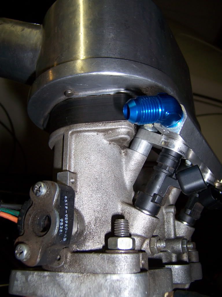

FPR and -6 AN upgrade:
and of the fuel rails (drilled and tapped for 3/8 NPT):

paul_f July 2nd 2010 07:25
Where do you take your MAP from Wally, have you drilled and tapped the manifolds?
Cheers
Paul
