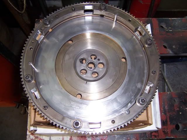

Machined flywheel for the twin disk set-up just before it went in:

Engine runs again and the twin disk seems to engage pretty easy and gentle. Much to my surprise I must admit. It only rattles from the center plate like an old Ducati when the clutch is depressed. Oh, well :)
Tomorrow test drive to work I was thinking :D
Wally July 18th 2010 06:41
Test drive went fine: clutch engages really not different than the former one, which is great!
