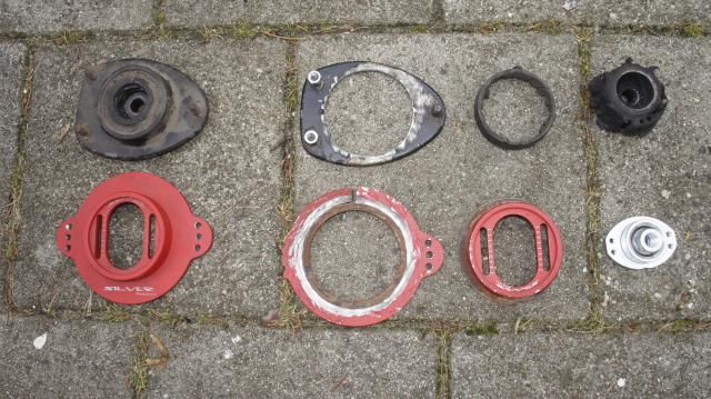

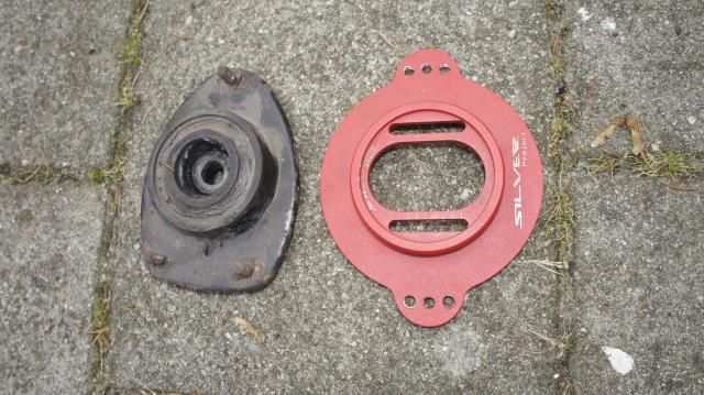

I got a set of camber plates for a mark 1 vw Golf from Silver Projects on Ebay. They are made from steel and can be easaly adapted to fit a superbeetle.
Original next to Silver Projects VW Golf camberplate
http://i129.photobucket.com/albums/p...c.jpg~original
Cut up to join the 2 together
http://i129.photobucket.com/albums/p...f.jpg~original
Finished adjustable camberplate and Original
http://i129.photobucket.com/albums/p...3.jpg~original

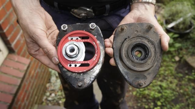

So, I contacted the guys at Silver Project to see if they could just add camber plates for Super Beetles to their line of products based upon Blizzard's idea above. They're going to. I talked back and forth with one of the project team members to determine what was needed. In the end, I sent an early style upper strut mount to them in Poland and they received it today. I should know soon how it comes out. Stay Tuned.....

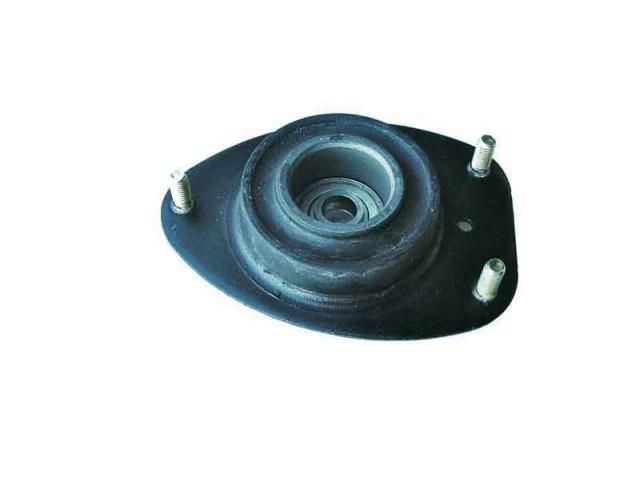

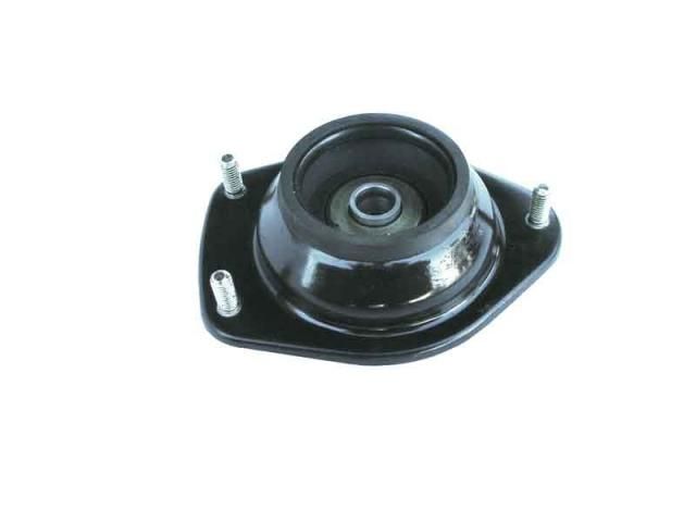

The diameter of the early Strut Bearing Mount, up to 1973 is smaller than the later Strut Bearing Mount for 74 to 79 Super Beetle. The hole in the body is also smaller. I have a '75 1303 so the hole is for the wider diameter Strut Bearing Mount.
The outside diameter of the Silver Projects Mark 1 golf camberplate is to big for the hole upto '73. So if you use the Silver projects camberplate based on the Mark 1 golf in a super upto '73 you have to make the hole in the body bigger to fit it.
> 1973
1974 >
http://i129.photobucket.com/albums/p...1.jpg~original

The Silver Project guys came through. Here's is the new camber plates for 1303s
http://silverproject.eu/en/shop/susp...eetle-1974-79/
I'm must admit I'm a little confused. I SENT him an early upper strut bearing for the bolt spacing, and because the rubber/steel section is easier to remove from the early mounts (the later mounts are pressed from a single piece of metal). Perhaps its due to the fact they used the adjustable section from their Mk1 Golf mount and it fits into the hole on the later chassis cars (and according to Blizzard, above, does NOT fit through the hole on the early cars)(in fact, in one of the pictures, you can see the exact upper strut bearing I sent to him). Anyway, the price seems very reasonable to me. I will be buying a set asap.
