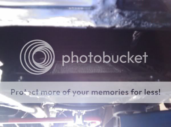

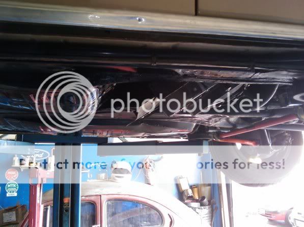

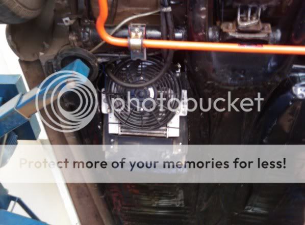

Luismj February 23rd 2011 12:11
Hi Paul!
im try to some solution here...
http://i712.photobucket.com/albums/w...2.jpg~original
http://i712.photobucket.com/albums/w...7.jpg~original
I dont measure the heat yet. T1 2300cc turbo...
fahrvergnugen February 23rd 2011 15:12
Originally Posted by Luismj (Post 79782)
Hi Paul!
That sure looks familiar, let me know how it works:goodjob:
Paul.
