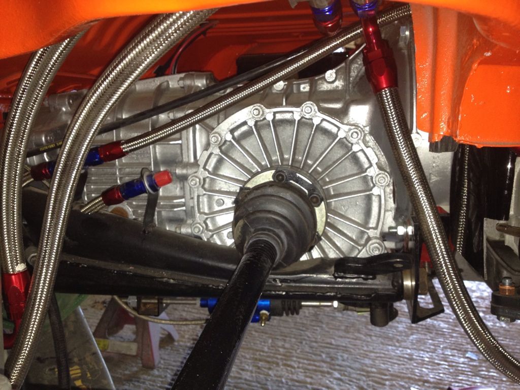

will ive made a bit more progress on the bug and is ALMOST ready to MOT......but the bug obviously wants to stay off the road a little longer.....
all the oil/fuel and breather lines are done - just need tidying
http://i1104.photobucket.com/albums/...3.jpg~original
http://i1104.photobucket.com/albums/...0.jpg~original
http://i1104.photobucket.com/albums/...2.jpg~original
http://i1104.photobucket.com/albums/...5.jpg~original
http://i1104.photobucket.com/albums/...7.jpg~original
just need shocks now and engine setting up by RNJ Morotsport.......however the bug spat its dummy out last week
the new hydraulic clutch set up (although is now 4 years old as the project has been going on for so long!) decided to ditch all the the fluid inside the tunnel of the chassis :( ive flushes the tunnel as best i can and looks to have got away with minimal paint damage. I took the cylinder out (which it turns out i can only JUST manage with the body on!) and is scored.....so have ordered a new updated kit from saco performance.....which will be with me in 2 weeks!
soo now its just clutch and shocks......... :)

Dean, did you just get the MC from Saco or a rebuild kit?
I keep looking at alternatives to the Saco for in the tunnel and they are not too common. BMW 3 series or one from CBSonline are my current choices. And if you don't mind me asking how much was it with post and tax?

Looking very good! Pity about the saco unit.
dub_crazee June 13th 2012 03:18
Thanks for your kind comments again guys......it has been a long old road and a busy few years for me (not just with the car) just cant wait to be cruising around in it!!
it is a shame about the saco unit but after doing a search quite a few people look to have had issues with them. unfortunately saco dont do a rebuild kit for my MC a mine is one of the first ones and now they sell a cnc machined item (mine was cast) also the cylinder was lsightly scored.
lets hop their new kit last a bit longer!!!!
the MC alone has come to £117 shipped to the uk (il have duties on top of that)

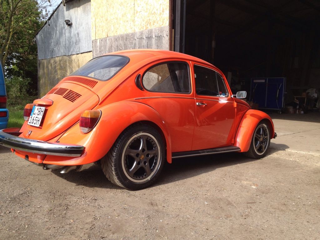

Well, i went to spa...but the bug didnt.....ended up going in my rustbox bay!
http://a6.sphotos.ak.fbcdn.net/hphot...51129221_n.jpg
whilst ive been away the bug has been with rob at rnj motorsport.
motor is all set up - its mot'd but developed a couple of gearbox oil leaks........il be picking it up friday so il put some pics up!
i cant tell you how excited i am to have it back.....its been off the road for 3 years and 11 months (last time i drove it i took it to le mans)!!
:D:D
dub_crazee August 24th 2012 03:04
It,s on the road and great fun to drive!!! Going to have the gearbox rebuilt though as it has lots of leaks...... Which now means I have a lot of cleaning to do too!

judgie August 24th 2012 04:02
glad your enjoying it and no there never finished as you will allways see another car and think yeah that would work on mine lol.
Wally August 24th 2012 04:21
Looks awesome! Maybe a little lower in the back, but other then that: georgeous!
al_kaholik August 25th 2012 10:50
Hope you're happy Dean. Looks good, but I do agree with Wally. I'm not so into rake either
dub_crazee August 25th 2012 13:51
Thanks guys. Yeah the back end will be coming down about an inch, maybe bring the front up half an inch, with a small amount of rake. A lot of rake doesn't suit German lookers IMHO. Want to run some spacers on the front too. Got to fit my gauges and make some rear tin over the exhaust. Hoping to make it to the Volksworld 25 year anniversary party at brands hatch!!
