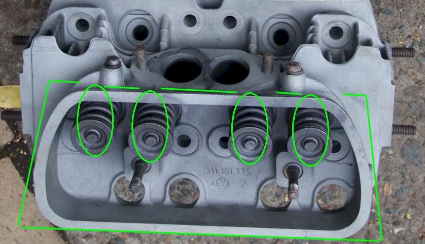

I talked to FAT performance and they also recommended replacing the valve springs considering they are almost 20 years old now. They may not be broken but could be fatigued by remaining compressed, which I guess is debatable but I'd rather just replace them than drop a valve and blow my engine up. So now I'm looking into valve spring compressors for the 914 2.0 heads with the 3 studs. I found this one on CB performance which claims to work with T4 heads, but does that mean it will work with 914 2.0 heads?
http://www.cbperformance.com/Product...oductCode=6504
Anyone else have a tool they use?

Anyone? How do you get your valve springs out? If you have a good argument for why I shouldn't replace them, I'm all ears.
Steve C April 26th 2013 03:41
When I worked in VW shop we had valve spring tool that bolted to the head using the rocker studs and compressed all the valves at once. I've half made one I will post a photo soon
Steve C April 26th 2013 04:02
I just did a rough drawing of the tool I was talking about. It had a hole for the rocker stud to poke through. To take strees away from the rocker stud I used 5/8th bolt with a M8 thread tapped into the head of the bolt, the bolt was fitted hex end against the rocker post and 5/8th nut was then used draw the tool down.
It worked in car as well if you put some compressed air into the cylinder.

Steve C April 26th 2013 04:05
Actually looking at my drawing I see errors in my post.
The tool needs to fit inside the rocker box on the top edge and the sides so that it can wind down far enough to colapse the springs.

Steve C April 26th 2013 16:35
As far as I know the 914 head use the same rocker gear as any Type 4 would and as the tool locates on the rocker shaft posts I cant see why the CB unit wouldn't work, plug location is different and there is maybe differences in chamber shape.
The thing I like about the tool I tried to describe is that its very controlled as everything is bolted down securely.

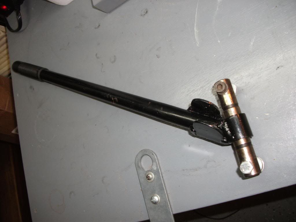

NO_H2O April 27th 2013 07:43
I made one out of an old rocker shaft, an old jack handle and some scrap 3/16 flat steel cut and ground to a radius. Bolt it to the heads and it works well.
Bugged April 28th 2013 19:22
NO_H20, do you think you could post up a picture if you get the chance?
NO_H2O April 29th 2013 16:37
Here you go.
Bugged April 29th 2013 23:54
Awesome, thanks! What did you use as the cylinder to go around the rocker shaft? Old rocker arm? I will be headed down to the porsche yard this weekend to get some shafts and rocker arms.
I started thinking though... Should I not just take my heads off and use an easily available spring compressor? Will a spring compressor that I can rent from (autozone, oreilly, checker, etc) work with the heads off? What are the downsides of completely removing the heads? other than needed new gaskets.
Other notes, my V2 DTM stage IV kit showed up at my door today. Very happy with the fiberglass quality.
Gotta get started on the wiring.
NO_H2O April 30th 2013 04:41
I used a section of pipe for the rocker shaft pivot. If you don't have any head leaks, no need to remove them. Use the tool to compress the springs. You can rotate the engine to almost TDC. Then stuff parachute cord down the spark plug hole. Rotate the engine a bit more to snug the cord against the valves (don't force it too much). The cord will keep the valves seated while you remove the springs. Remove the keepers, retainers and springs and replace what is needed. Double check the keepers. Rotate the engine back to remove the pressure on the cord and pull the cord back out the spark plug hole and move on to the next cylinder.

Just did this on my engine, for all eight sets. If you have an air-compressor, I highly recommend trying to find a spark plug hole adapter that allows you to put 120psi of air into the cylinder to hold the valve up vs. the parachute (nylon) cord. It's a pain trying to get enough cord into the cylinder. I managed, and did all 8 in about two hours...but it would have been easier/faster without that cord.
Bugged April 30th 2013 19:08
I will try and find one of the spark plug adapters when I do it. I'm still torn as to whether I even need to replace the springs, but just to be sure I think I will replace them. The consequences of not replacing them if they are bad outweighs the cost of replacing them.
