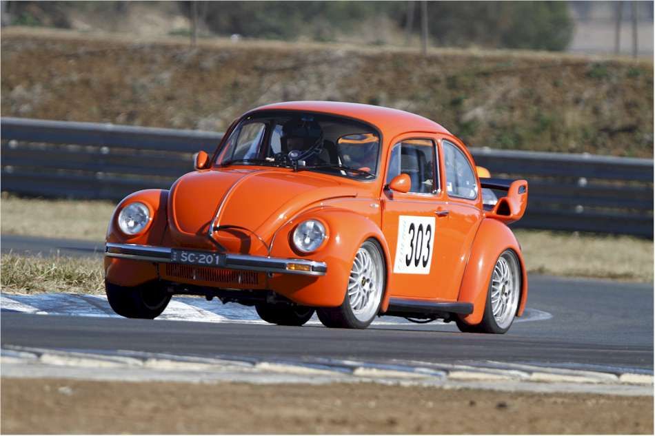

what type of exhaust system m
Yeah buddy, nice. Your ride did not sound Suraru,what type of exhaust are you using.
effvee September 9th 2013 06:59
Yeah buddy, nice. Your ride did not sound Suraru,what type of exhaust are you using. Those rear fenders I tried to have the company that make them, make me a pair in 3 inches wider,but they declined. They give your ride coolness:)
ricola September 9th 2013 11:49
Looks good with the stock decklid Steve, bet you're glad to have it back together again! Did you take the opportunity to do any other changes?
Steve C September 9th 2013 17:21
I can now start on the interior, just going to make a twin bucket seat up for the rear and some carpet.
I bought some heavier rear torsion bars but I haven't fitted them yet
effvee Those fenders are pretty wide already, I'm running early 944 aluminium rear arms and 18x9 with about a 53ET.
The exhaust is stock ported STI headers and 3 inch all the way through, I've changed the dump pipe a bit since this photo was taken.

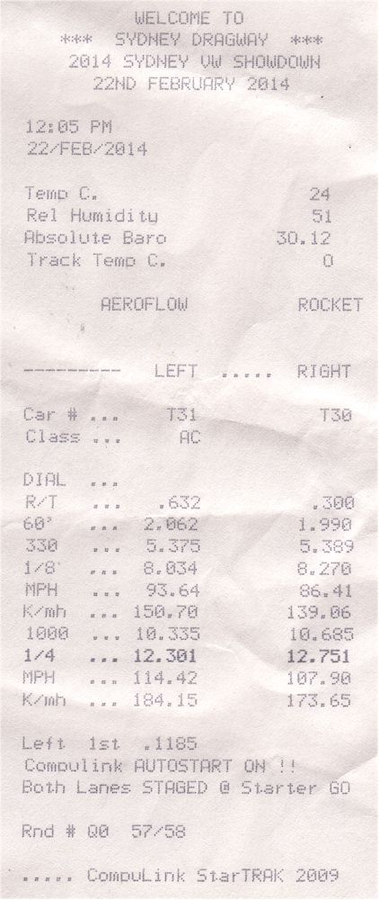

this time slip was my best run
http://i1184.photobucket.com/albums/...4.jpg~original

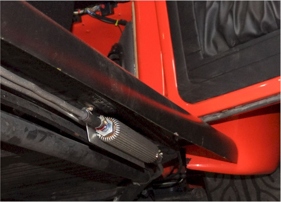

I've been having some issues with heat soak into the fuel system. I just fitted some aluminium fuel lines and a cooler on the return line, seems to be working.

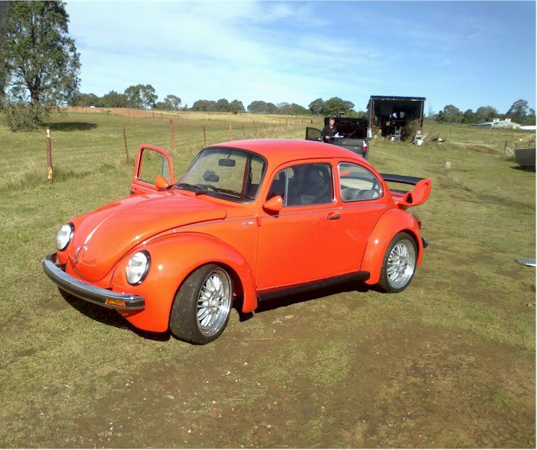

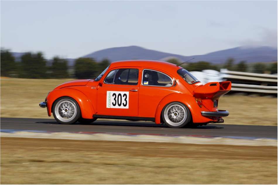

Steve C May 27th 2014 22:41
Just fitted some 30mm short sway away rear bars and some Bilstein rear shocks to my bug, they ride quiet well and seem to have taken the squat out of my rear end

Steve C May 29th 2014 19:54
It handles pretty well, I was chucking it around at first trying to get heat into the tyres, people watching said its not squatting like it used to, the spin was from trying to get more speed onto the straight.
I don't have the ability to say what the suspension needs next, so next track day I would like to get someone else to have a drive and get some advice.
I have pretty old Konis in the front. I'm thinking of going for some coil overs with an adjustable base for height, at present the only way I can set ride height is by putting more tension on the coil spring which is not ideal

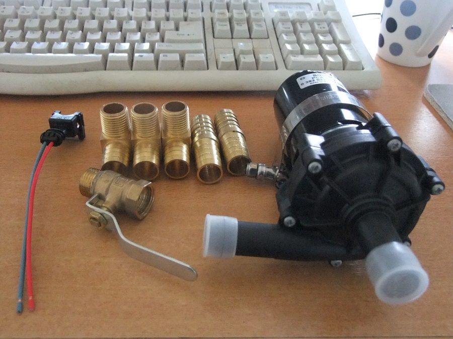

And some more parts turned up today from Frozen Boost.
Ice water reservoir and water to air intercooler pump, this pump is designed by Bosch and Ford specifically for water/air APPLICATIONS and is used in supercharged Mustang Cobras and supercharged Mercedes.
