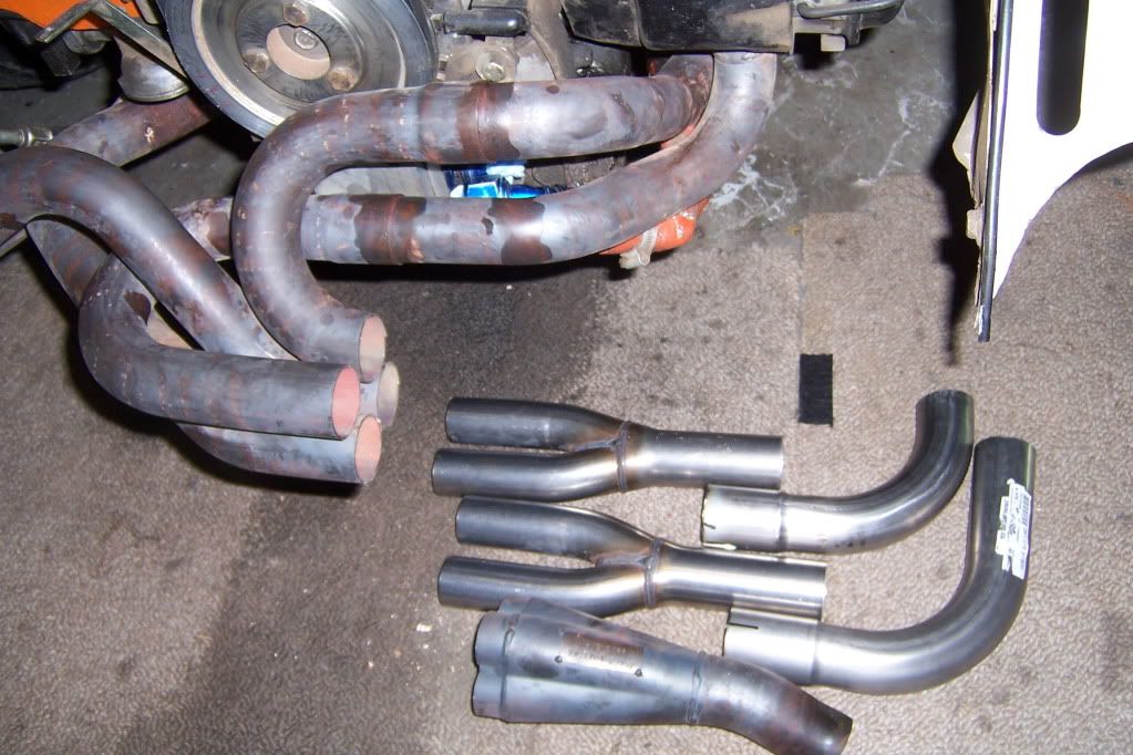

Started building the twin scroll header out of the exiting one:
Unfortunately 1 and 3 (and 2 and 4) are positioned not beside each other but diagonal (sp?) across... so the primaries have to be adapted some more.
Plenty to do before the new turbo is completely connected.

Hi,
Is this an illusion from the picture or will this header never fit under the bodywork?
Seb

-> Illusion: this header already did fit under there, I just cut it off behind the collector ;)
My 'remodelling' might give a little more room too. Thats very welcome as it is very tight now (G50 gearbox made the engine go back ~3-4 (?) cm) indeed.
