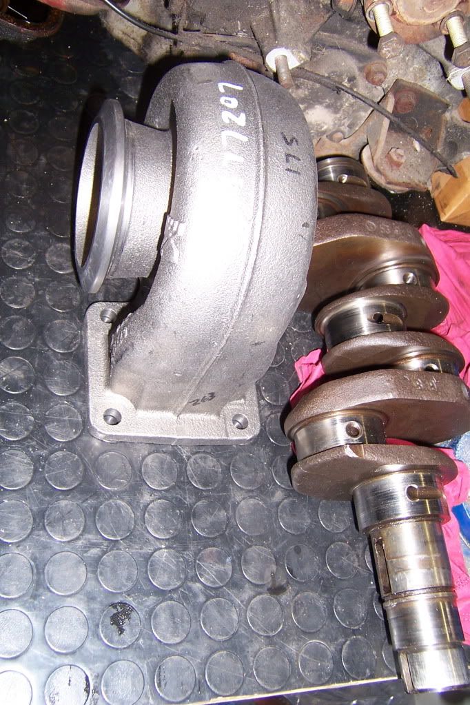

In the meantime, I figured this turbo needs a bit smaller A/R for this little engine and it came in today: 0.91 instead of 1.00 A/R: Just looks as big as the other one :lmao:
MX67 February 23rd 2011 01:21
Downsizing is cool these days :D
