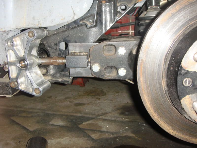

vw1303 November 26th 2011 21:37
Hey Dave,
I was also working on my rear spring plates this weekend.
http://i7.photobucket.com/albums/y25...6.jpg~original
The double shear mod you did looks nice and strong. With the plates you put on your trailing arms is there going to be enough room for your wheels? Also what rear coilovers are you going to run?
