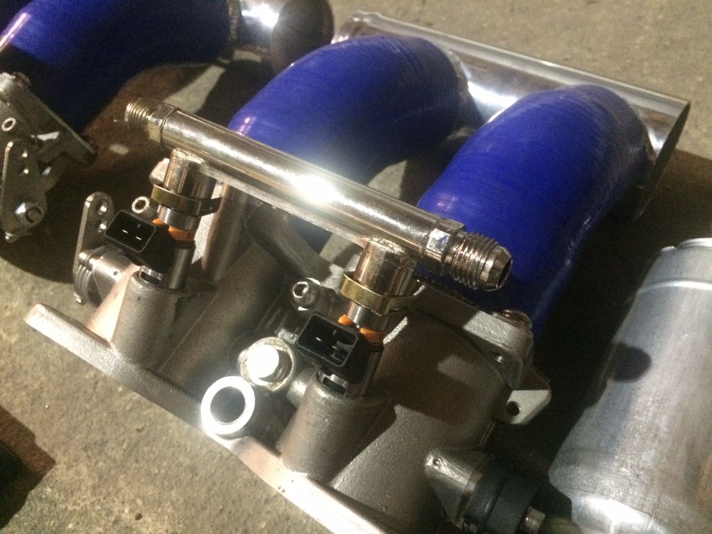

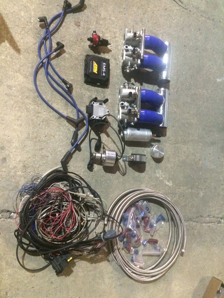

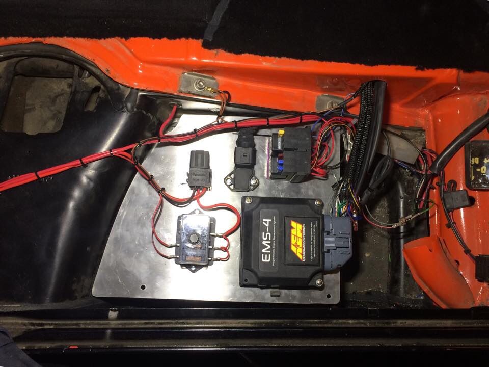

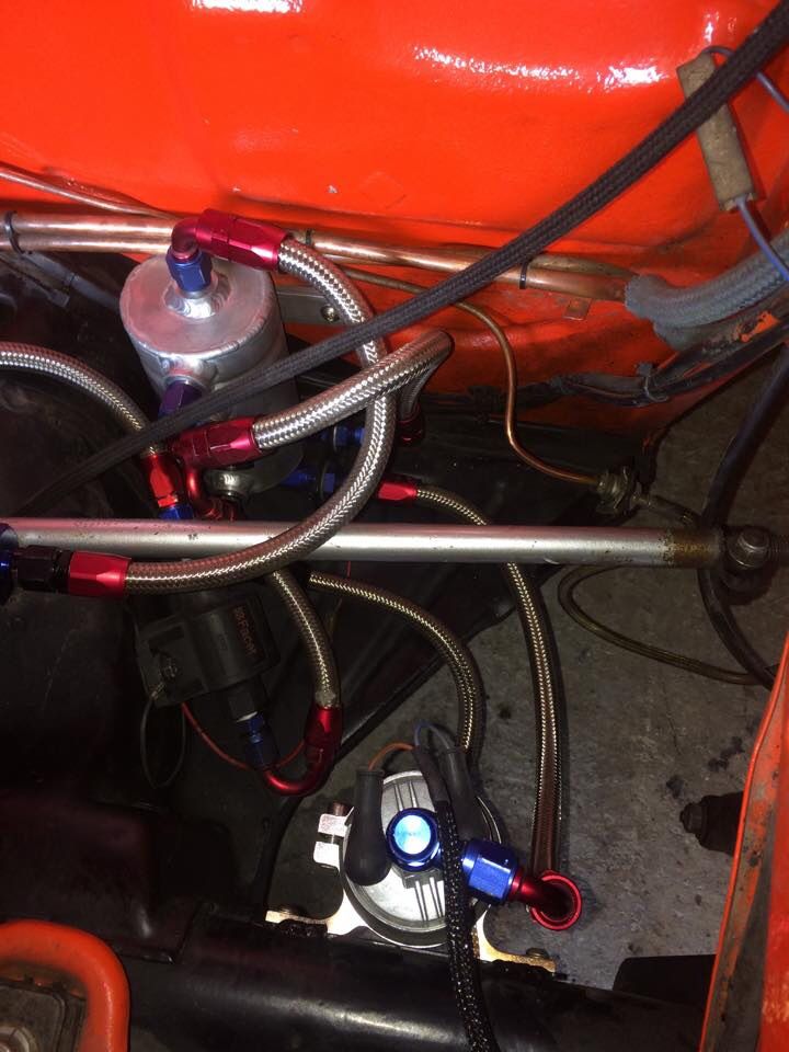

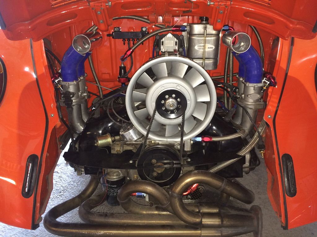

Good......I managed to install my efi kit!

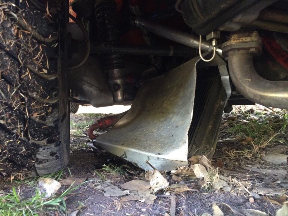

The ugly......I ripped off my cooler 200 miles from home
http://i1104.photobucket.com/albums/...1.jpg~original
http://i1104.photobucket.com/albums/...b.jpg~original
Still tinkering getting things better and I've also started making my shopping list for turbo conversion this winter!

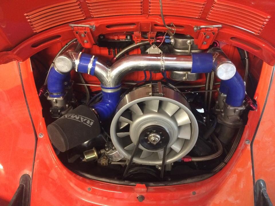

dub_crazee January 14th 2019 15:20
Well a lot happened between my initial Rolling road but long story short my engine got run up with my dry sump tank tap turned off (not by me!) anyway after engine rebuild and turbo rebuild we finally got some decent dyno time. The results were ok! 231hp at 6000 at 18psi. It was great fun to drive but as you can see in the graph it all came in very late (turbo too big). It also didnt take long to kill it, I dropped a valve seat after a few weeks of driving :( One thing I learned is that boost is addictive and there arent too many cars that can beat a beetle wtih that sort of power - BMW m4 couldnt make ground on me).
Anyways, my engine builder informs me that the valve seats were put in too tight and caused the ally to rupture and squeeze out the seat, So im now shopping for a pair of heads. Currently in talks with FAT performance.
Ive also had my turbo rebuilt with a much smaller exhaust housing (55 AR down to 38AR). Ive swapped out my coil, changed for a turbo smart waste gate and I have some other small changes Im making and hoping to get back on the rolling road before the spring!

Wally January 14th 2019 17:04
231 hp at 18 psi with such a combo is a little disappointing tbh?
Or very very conservatively tuned?
There is surely room for improvement! ;-)
dub_crazee January 14th 2019 18:02
I agree wally, something was amiss, I do wonder if I had valve issues before hand. I was hoping to make 230 sub 1 bar. Let’s hope the changes and new heads help out.

dub_crazee April 27th 2019 05:19
It didn’t take long.....I killed it! I *think* it was mapped with a slight leak on the MAP sensor. The hose popped off and I pushed it all the way on. The ECU then kept reading overboost and IGN cutting. Kept dropping the duty cycle on the boost controller but I obviously spent too much time dropping small increments, over heated the heads and dropped a valve seat!
Anyway this gave me the opportunity to make a few changes. New heads (went a size smaller on inlet valves to leave more meat between the valves. Turns out my CR was super low and were now up at 8:1. I’ve also had the exhaust housing and turbine changed much smaller. Combine the upped CR and smaller exhaust housing I should see better numbers off boost and much faster spooling. All in all I’m hoping for much nicer driveability and similar numbers at lower boost. Going to the rolling road on Monday so we’ll see. Will map to 1 bar and see where we are at. Been looking into water/meth injection, anyone else running this? For relatively little cost it seems a good way to help limit heat which I guess is the big killer of boosted aircooled motors.

Everything above 0,5bar boost or so (imho), you'd want some sort of intercooling. Water-meth is very efficient in doing so. I run Aquamist in the past and just received their newest version, but haven't installed it yet.
dub_crazee June 13th 2019 13:06
Thanks Wally, it’s taken me 10 years to get it just where I want it!!
I’ve got a charge cooler in place at the moment but long term I was looking at the AEM water meth kit. It’s fairly priced and seems like a good option to cool things down a bit!
I finally achieved my goal!!! 264hp at 16.5psi!!!!!
Makes 188hp at 11psi with boost controller off.
Figures haven’t changed too much lower down despite the considerably smaller exhaust housing and increase in CR which is a little disappointing.. The weather has been aweful here so haven’t had the opportunity to drive it since!

Wally June 15th 2019 06:59
Thats a bit weird indeed. Pity your dyno didnt have the boost pressure in the graph.
It will probably feel very fast anyways 😉
Wally June 15th 2019 07:04
What engine combo is it now in this form?
Cam, cc’s, heads/valves thanks!

It’s 2056, 38x42 with a web cam 118 turbo grind iirc
Wally June 15th 2019 09:03
Ah, so its 1 bar at about 4400-4500 rpm. Thats not too bad for basically a 2 ltr engine.
Maybe the compressor wheel is a big big for this hp? Compressor wheels determine spool almost as much as the exhaust wheel.
What turbo is on it atm?
This combo could/should do a little better as head size and cam seem ok for 300hp at 18 psi with these low inleg temps. Maybe timing has been kept a little conservative?
dub_crazee June 15th 2019 14:58
I do think maybe the turbo isn’t the best for my motor. I’ll drive it for a year or so and then maybe consider changing the turbo for something a little more modern. I’m running a Garrett t3/4 hybrid at the moment.
So at the moment it made max 264.9 at 16.5 psi, another couple of psi would be around the 300 mark I guess.
After the woes I’ve had with it over the last year I didn’t want Greg (the chap mapping it) to push too far as I don’t want to kill it again. I put 100 miles on it today mostly back at 11 psi and had loads of fun! Hat the boost controller on a few times and it was great.
In your experience Wally what sort of boost can you run to with stock head studs?
Wally June 16th 2019 17:15
I’d say the head studs can handle way more then you’re now, but its the stock heads that trend to worp a bit, causing leaks.
Even stock engines saw this problem. Especially buses..
Anyways, never torque the head studs more then stock in an attempt to make it seal “better”. It gets worse with more torque on the head studs then stock torque settings.
Thought I’d mention that again, for others that might be tempted 😉
