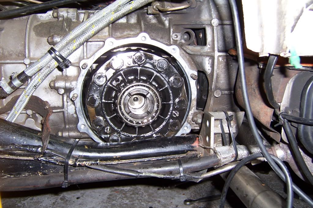

Tried to remove the diff, but after quite some work, the bl**dy tranny fork is still in the way, so no LSD this year :mad:
http://i174.photobucket.com/albums/w...e.jpg~original
Will have to be done over winter time then when the engine gets out anyways to make room for the 1200T T1 project.

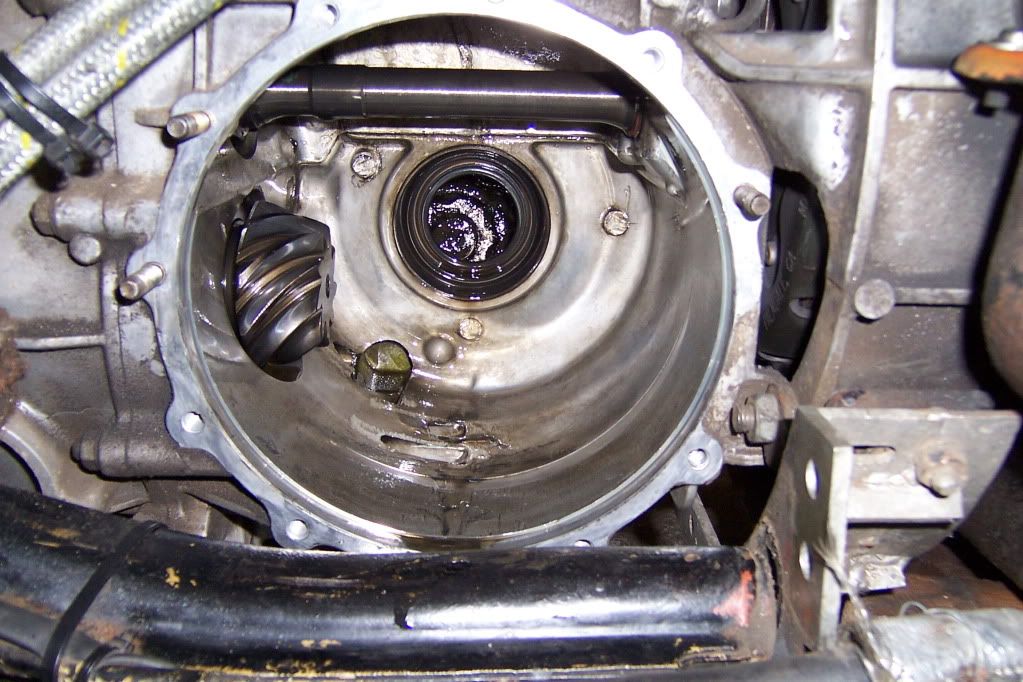

Wally September 12th 2011 17:02
Pulled my finger out of my.... and put some work into it and raised engine-tranny combo a bit.
That proved just enough to pull the diff out :)
