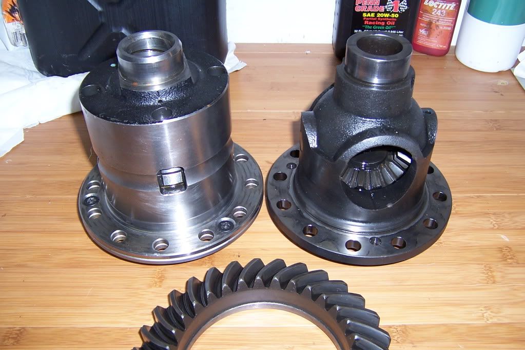

Just removed the ring gear and bearings so both could be compared in detail.
All the important measurements that would impact ring-gear distance are extremely close (beyond my accuracy anyways), for all practicle purposes I would say they are the same. Lets hope I am correct...
The only thing I really need, is a set of new ring-gear bolts ($$ no doubt) as the flange of the LSD is 2mm thicker (to the direction that doesn't impact ring gear distance of course ;) ).

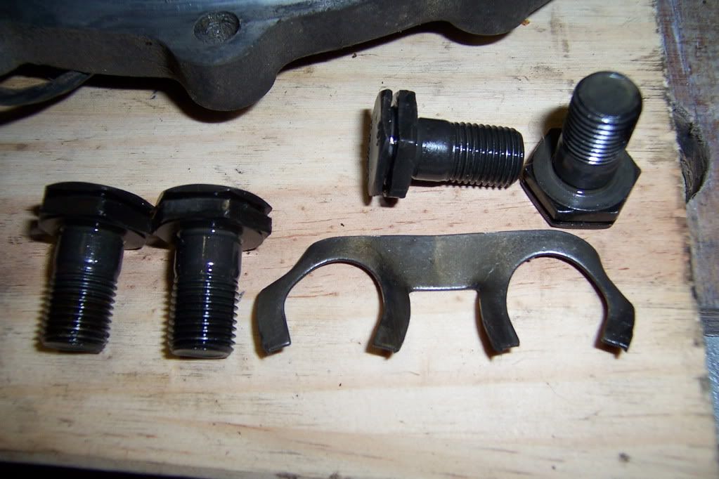

I am still looking for the correct new (longer) bolts I need for the swap over of the ring gear. Its a M12 x1.25 bolt in 12.9 grade, but would be nice to have the part number. Mittelmotor don't list inner diff parts. I'll look at auto-atlanta in return ;)

I had an issue accessing the 996GT3 catalogue but the 996 catalogue list two possible options for the ring gear bolts (with LSD).
999 217 152 01 or 996 332 276 00 depending on which diff (can't quite read the full number in your photos).
The GT2 catalogue lists the 999 217 152 01 bolt for use with the 996 332 083 9B (40/65% GKN) diff. The bolts are M12 x 1.5 x 22,5
Hope that helps.
999 217 152 01 or 999 332 276 00 depending on which diff (can't quite read the full number in your photos).
Hope that helps.
Thanks Bruce, that helps surely, but I looked into the catalogue also and the 999 217 152 number seems to be the partnumber of the regular open diff (although a pic of a lsd was used, the general title of that section is 'Differential') as opposed to the 'Limited Slip Differential' section, where the 996 332 276 00 number seems to come from...
You wrote 999 332 276 00 but I am sure you meant 996 as first 3 digits for this one.
I could open de 996GT3 as well as the 996GT2 and both list the same pic and part numbers for that 9B diff..
I do indeed have that GKN diff however, so I am a little confused now which one I need... Could you check if your assesment is still correct, pls?
Bruce. September 14th 2011 05:56
The 996GT3 catalogue is perhaps clearer (i got it to open at last).
http://www.porsche.com/all/media/pdf...T3_KATALOG.pdf
Like the GT2, it lists the LSD (the only diff) as part number 996-332-083-9B. It is hard to read from your photo the last two digits but could this be your diff (or does it end "00" or "01").
The GT3 & GT2 use the 999-217-152-01 bolts (only option listed).
(also corrected the part number above for the other bolts, as you mentioned)
Wally September 14th 2011 08:42
Thanks Bruce, the diff number ends with 9B, so its spot on.
I'll order the 999.217.152 bolts then ;)

Wally September 14th 2011 15:26
Easy: drill 5.0mm hole in top above ball-spring, tap with M6 tap and install M6 bolt with lock nut. Install with loctite ;)
These are/were the original bolts: 22.0 mm shank length. I need 2mm more (i.e. 24.0-24.5mm).
I do hope the ordered bolts are the correct length, but how could they not be?
