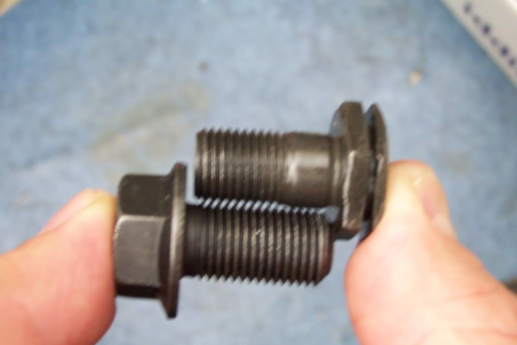

Steve:
From what I can gather, that is the "street" LSD.
Wally's LSDiff is the motorsport version which is tighter than an inappropriate simile
Hi Bruce
I thought that he was after the part number for the bolts.
Bruce. September 15th 2011 04:51
Hi Steve,
I looked in the same place as you, the 996 carrera catalogue but the optional LSD for the 996C is different from the "motorsport" LSD used in the GT3/GT2 and the bolts specified for each are different.
Hopefully, the bolts will fit with the G50 Crown gear. It is difficult to see how they wouldn't.
Steve C September 15th 2011 10:19
Its a shame that Porsche don't have a "Lack & normal tellie" section like VW where you could look up bolt and other part numbers by description.
Wally September 15th 2011 10:22
Picked up the correct bolts for exactly my differential and got a mail from Paul to use 120 lbs.ft and a drop of red Loctite.
There is a difference in length, but not exactly as much as the difference of the flanges.
Anyway, it will do fine I think.

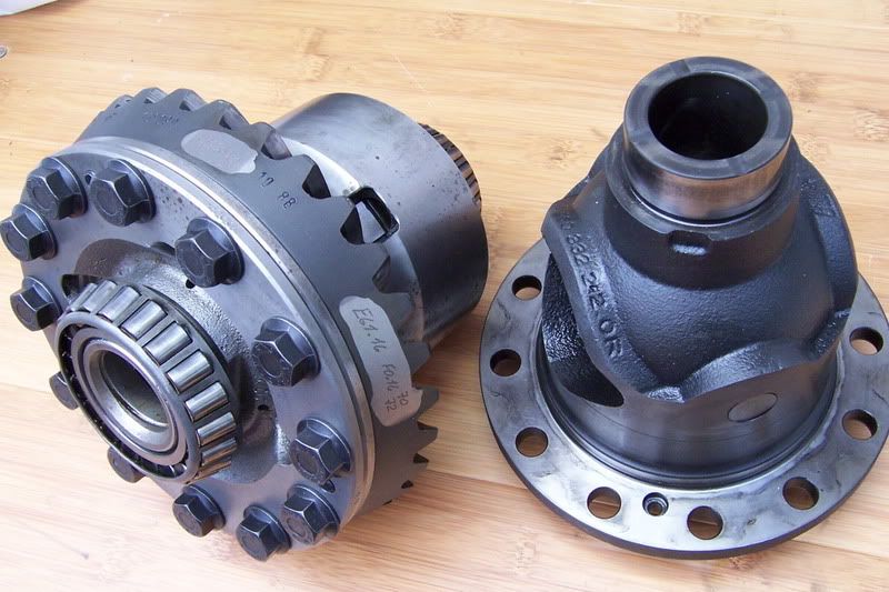

Wally September 15th 2011 12:00
Just reassembled everything and very happy I got the spacers and bearings pressed on again without any trouble. Ring gear was extremely nice and tight fit on the much later dated diff housing. The machining on these parts is amazing!
Wally September 18th 2011 16:29
After a lot of work pulling the engine forward far enough to get the thicker diff back in, I got the engine back in its place again. Filled tranny with new synthetic 75W90 Valvoline and reused the O-ring n the side cover (even though I still have a new one from the gasket set). If you turn one wheel, the other one turns in the same direction as it should with a LSD :D It turns nice and smooth by hand.
Got the engine running again and went for a test drive.
No extra noises, all seems just fine and dandy. Did a deliberate lighting of the tires in second gear (cold and damp road) and that felt different somehow, more aggressive in a way, but not out of control.
Car is still stupid fast and seemingly effortless at doing so.
At home, tranny is still bone dry as before.
All in all, this was relatively easy sailing, though I didn't know that up front..
Gotta love orginal parts ;)
