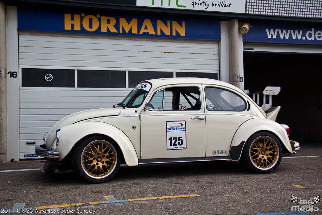

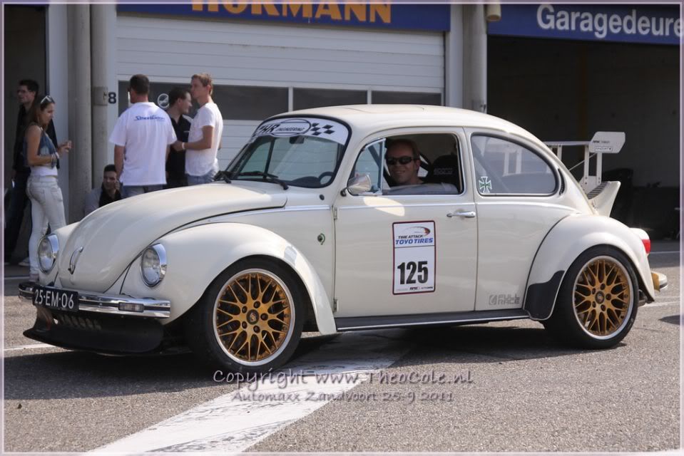

The rear wing is ugly from the sides, but I already knew I need to make nicer stands or buy something:

Did the picnic table have any effect on the intercooler?
owdlvr September 29th 2011 00:42
The wing doesn't bother me. Form follows function, until optimum function is figured out...then yes, make it look good ;-)

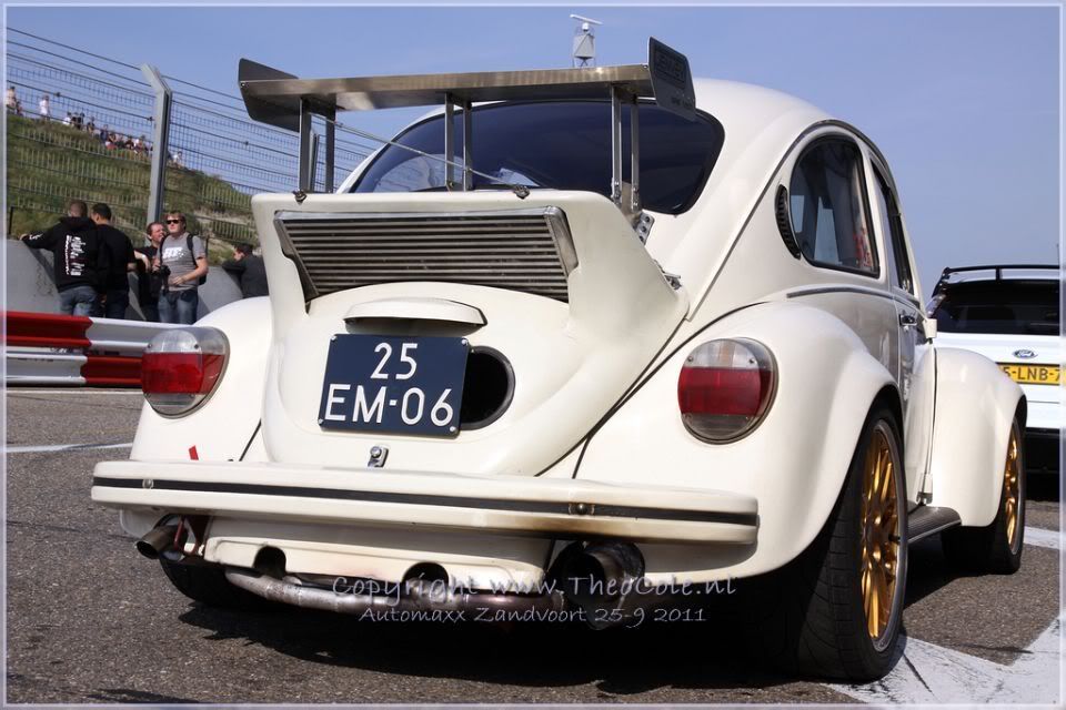

But no, it doesn't as I did deliberately positioned the wing so the gap was big enough that the air following the roof line flows uninterrupted towards the intercooler.
It IS functional in that respect. Any roof lips or other roof spoilers however WILL effect intercooler efficiency imo.

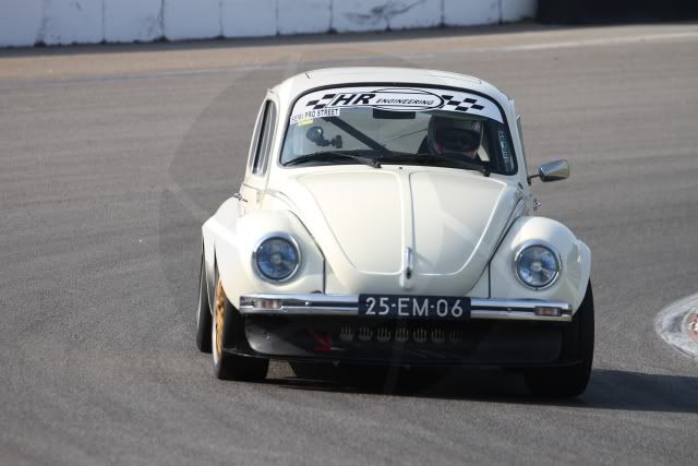

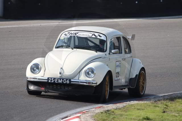

Wrt 'looks' of the rear wing: its also depending on the angle how you look at it I think:
http://lh3.ggpht.com/-nFa9t9eOsD8/To...%252520196.jpg
http://lh4.ggpht.com/-YRpWO8qd42c/To...%252520198.jpg
http://lh3.ggpht.com/-gklweqzDrDc/To...%252520276.jpg

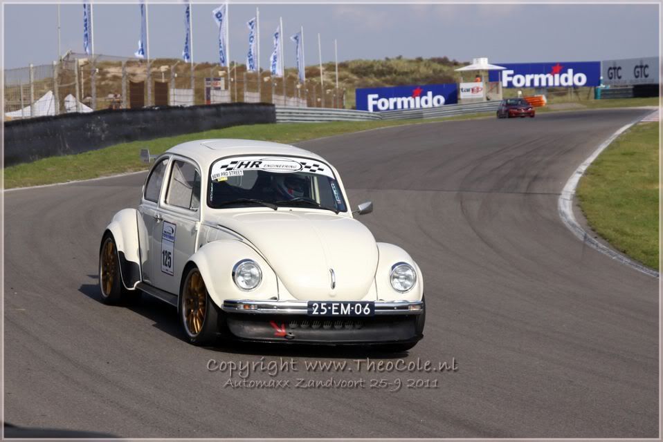

Braking at the end of the straight:
http://lh5.ggpht.com/-0Ov0nTwwmIo/To...%252520298.jpg
http://lh6.ggpht.com/-KqzIdK0JJUQ/To...%252520316.jpg
ha ha, nope doesn't look good from any angle. :D ;)
However the car still looks fantastic and more importantly, totally under control on the track.
You might want to consider a much wider wing, that extends to over the rear wheel arches and out from behind the main cabin. This would get it right into the air flow and increase the effect a fair amount.
70Turbobug September 29th 2011 05:38
Maybe you could build a diffusor that bolts up to the rear bumper mounts inside the fenderwell? Then you could do away completely with the spoiler and have full effectiveness of your IC.

Bruce: I really wouldn't want any bigger. I also think it makes the whole construction less stable if its wider then this. As Rob experienced, if the wing gives too much down force, the metal under the rear wing can give in (and probably gives more drag also), so too much wing is not wanted either I feel.
The center pod on the wing is already my own addition, which I found necessary (even when the wing was in its original low position, that was needed to make it stable) as well as the extra diagonal rod to the intercooler top.
As it is now, its very stable and I don't see it move or shake at all at any speed or surface conditions. Better stands and stronger material (steel plate instead of the alu now) should make it able to do without the extra horizontal/diagonal rod (I hope).
Maybe sometime next year ;)
