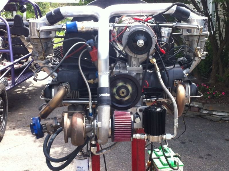

petevw December 12th 2012 18:50
Looky here: 2332T for this '52.
Next up, tear it down, plumb car and wire all for EFI. :D
Will she all fit? Thats the million dollar question i should know the answer to this spring! :lmao:

What pump are you using to scavenge the oil from the turbocharger?
petevw December 24th 2012 03:48
Turbowerx:
http://turbowerx.com/Scavenge_Pumps/.../Exa-Pump.html
Bug@5speed(US) December 24th 2012 22:39
So please school me on these scavenger pumps.
Assuming since turbo is below th pan, there is no way for gravity to help with allowing turbo oil to drain properly?
Is it common to have the out let drain to where the oil dipstick or vent would go? Need some clarification on why, the outlet does not feed into oil pan area? Can this be used this way with a dry sump setup?
Pondering this approach for a type 4 in my bug down the road.
Thanks in advance,
Ps last question before Xmas �� with regard to the hours discusses on the pumps website, are these rebuildable or does one need to send out for 10k hr intervals?
Thanks in advance,
Hi Alex,
I wouldn't know if this pump can be used as a dry sump pump. Decided to drop the oil back into the engine fr the filler spout because it was convenient. There is way to much going on around the sump with this type of header. As for the pump being rebuildable? Don't know. This pump was suggested to be used be a engine builder friend. He has had good experience with them, with no failures.

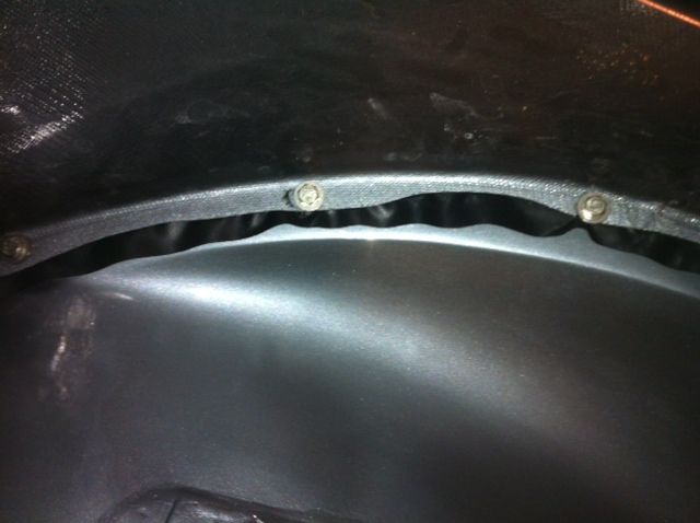

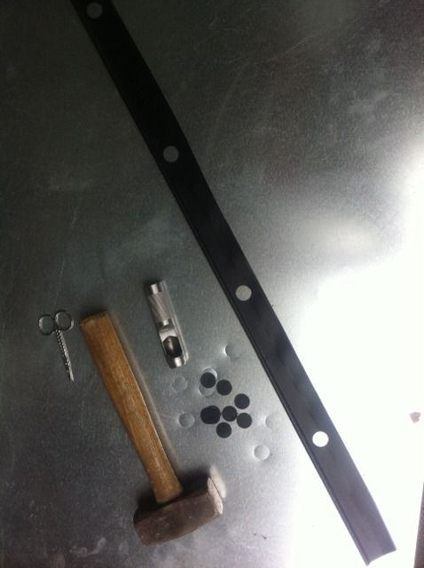

Never liked the plastic fender to body gasket. Ordered up the cloth fender welting many years ago and finally got to swapping it in. I didn't like the pre-cutouts of the plastic for the bolt locations. So I punched holes instead and installed. With the holes, it bunches up around the radius which I don't mind as the cloth is in contact all around.
Last night installed the Uniball plates I made. Took pic as I was installing so as you can see bolt missing and loose. It is completely bolted up now.

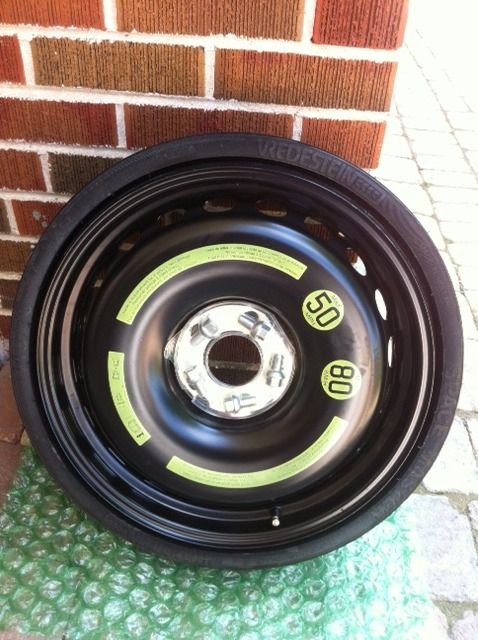

Have been looking for this MB SLK 55/65 spare wheel for awhile. Have an idea that I want to try. We'll see how it plays out.

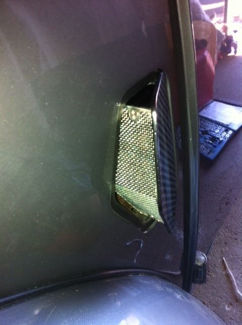

Carbon crotch coolers installed:
