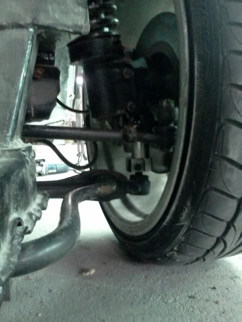

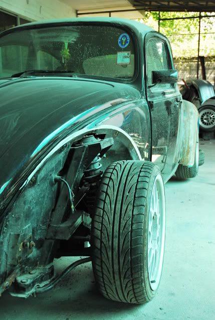

I notice that your using 2 bolt struts on the brown car, do you prefer them over the 3 bolt? Is that because your fitting 944 stubs?
I find the 2 bolts have limitations with lowering and you cant fit a flip kit to the tie rods unless you reposition the inner tie rod mounting.
Hi Steve, I've flipped tie rods and made the balljoint extender to lower control arms (it hit steering rack). Now I can lower the car about 1.5-2 inches more. I haven't tested it on the road yet but I think it will work well. :)
PS. typ4boy, sorry for hijacking your thread :)
typ4boy, your oval project is very interesting, I'm converting 1303 pan into standard beatle too. I've been doing this project for more than 2 years, it's almost done now :)
Steve C September 23rd 2011 22:48
Hi x_hodhoo
This very interesting stuff. Maybe you should start another thread on this, I'm sure that you will get heaps of comments on this.
You would need to be careful with ball joint to wheel clearance issues, the 3 bolt strut is much easier to space the ball joint on.
Wally September 28th 2011 15:33
Really like the ball-joint extender thing! Makes for a much better reaction arm geometry with more then normal lowering.
