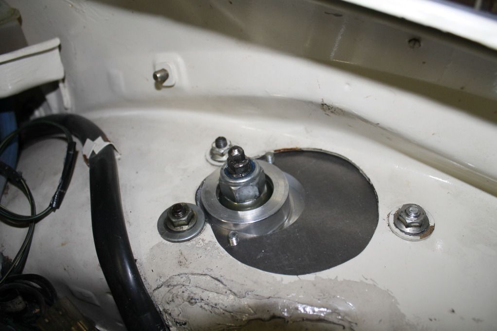

My CNC-wizzard friend made a cool adjustable caster top strut bearing housing (what a word..) so I could finally set the caster equal left-right and give it some more at the same time :)
Had a full alignment afterwards and car is sooo ready for Spa and I am looking sooo forward to it!

Nice!! That should improve grip and corner speed quite a bit! Isn't there something missing though? Nuts? Another plate?

Nope, its just an other, simpler design just made for me by www.mebejo.nl
I only needed a small adjustability range (1cm which aquates to about 1 degree) to set left-right equal as I knew I wanted maximum setting in general anyways. With the small range and the bearing holder having the edge at the underside, only two small bolts are needed to prevent movement as all the car weight already is on the sliding part. The thread is in the alu plate itself which is from extremely strong alu (7075-something I believe).
Only downside is I need to lift the front at the alignment shop to loosen the bolts from the underside. I have a friendly alignment shop over here, so that was no problem ;)
