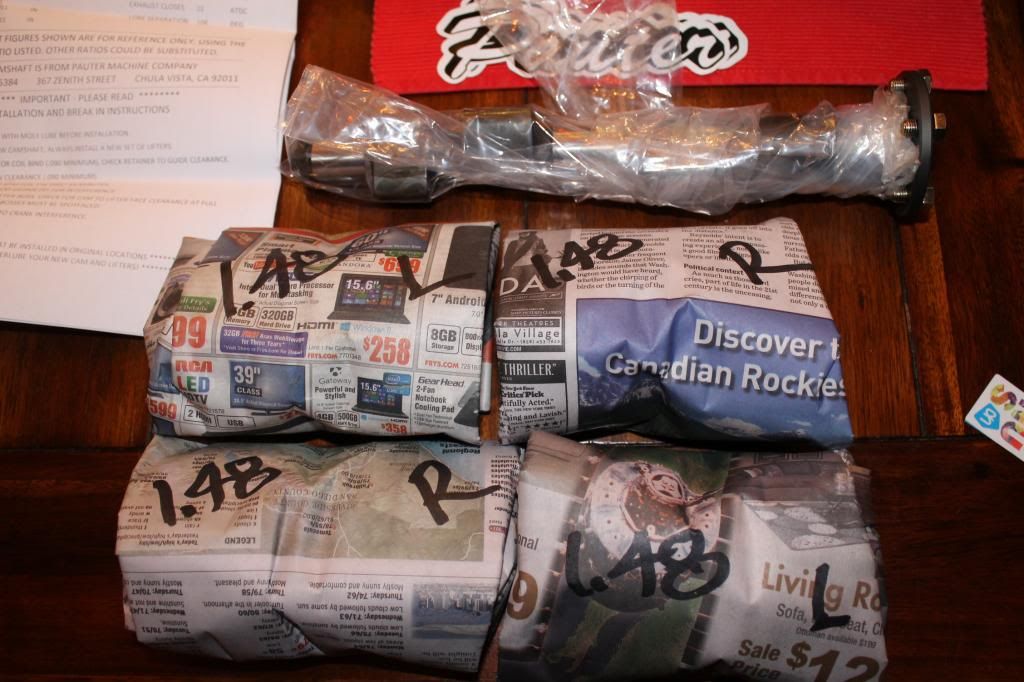

A hint of some of the parts that came in today :D
spannermanager November 16th 2013 17:22
finer thread pitch= more clamping force= use less torque for same clamping force.

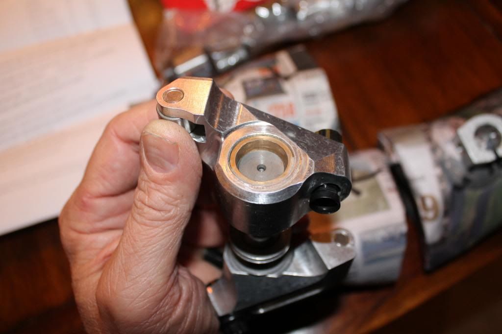

Hay,I was looking at Pauters website,I noticed that he's making his rockers without needle bearings or bushings for shaft support; just aluminium rockers to shaft. I wonder why he has not stated why. This is a sharp turn from needle bearings, bushings, to nothing:eek:
They are not without bushings and not 'just aluminium rockers to shaft' as you stated. What gave you that idea?
http://i174.photobucket.com/albums/w...b.jpg~original

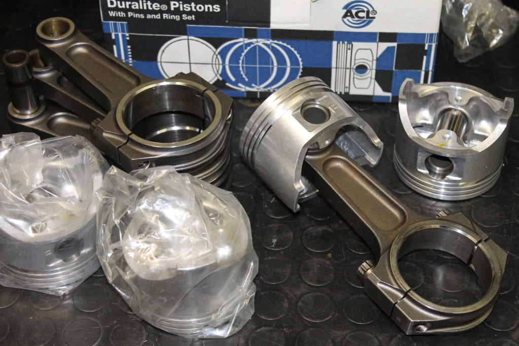

I already have the rods, they were a test set from R&R through Jake. Here coupled to a set of 77,50m pistons from the 1200T project (testfit for the 20mm pins):
http://i174.photobucket.com/albums/w...a.jpg~original
Good morning Walter, sorry I mis read pauters web site, only the rockers using needle bearings, will not have any bushing just hardened aluminum.
Those rods look plenty strong enough.
