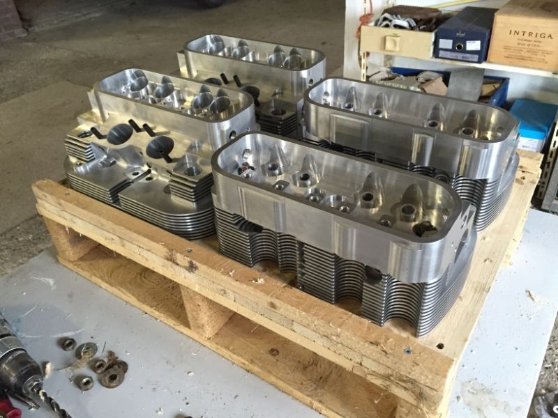

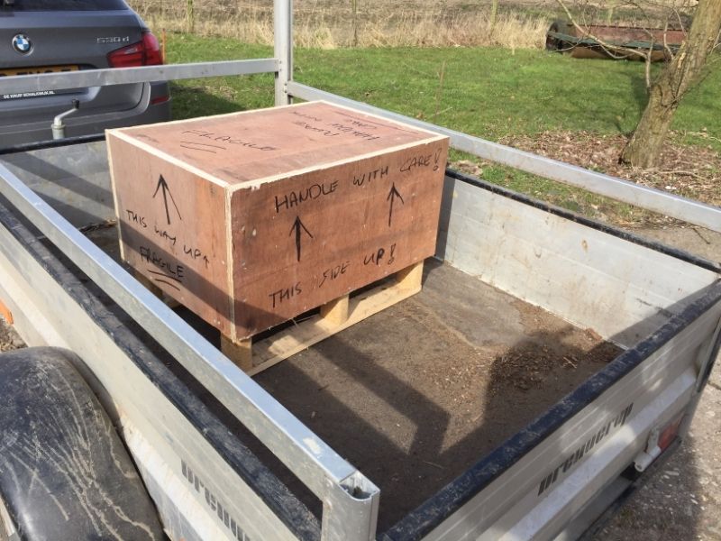

Today I send out a big box for some extremely important work (installing seats, guides and maching the ti valves to fit :cool:
http://i174.photobucket.com/albums/w...l.jpg~original
containing these (mine and a friend of mine's):

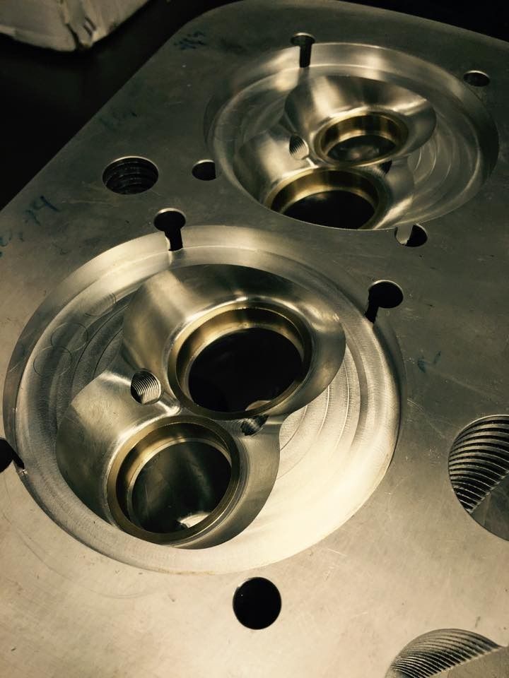

Valve size will be 48x41 and that in just a 98mm bore...:shocked:

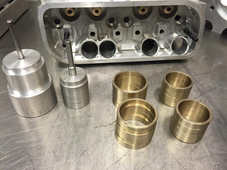

Alu-bronze seats have been made:

Question, I note that you are at the stud holes, what's the max cylinder size those heads can go up to?
Wally March 26th 2015 14:40
http://i174.photobucket.com/albums/w...ps4xpoonk0.jpg
http://i174.photobucket.com/albums/w...ps4cqbjpeh.jpg
http://i174.photobucket.com/albums/w...psmfnbir7w.jpg
Mark, my valve size (remember mine is just a 98mm bore engine) will be 48x41. Nigel's engine (103x82, as you see in the above pics) has 50x41mm valves.
Francelle, these have stock type 4 pattern and size holes, so what you think is smart/safe to use as a max bore size is entirely up to you. same goes for valve size..
