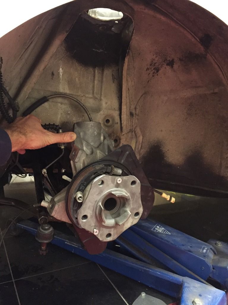

Well, since the rods aren't still here yet, I'll thought to start om making the yellow calipers work.
It didn't.. the bolt spacing is bigger (142mm as opposed to the regular 130mm).
So, I started thinking of other solutions.
I kinda strayed towards using the original 996GT3 bearing carriers so the whole thing would fit. That just means adapting all other 3 fixation points: (shocks, tie rod and lower control arm).
Here was a test fit with a rear 996/986 wheel bearing carrier (front and rear are basically the same casting):
http://i174.photobucket.com/albums/w...v.jpg~original

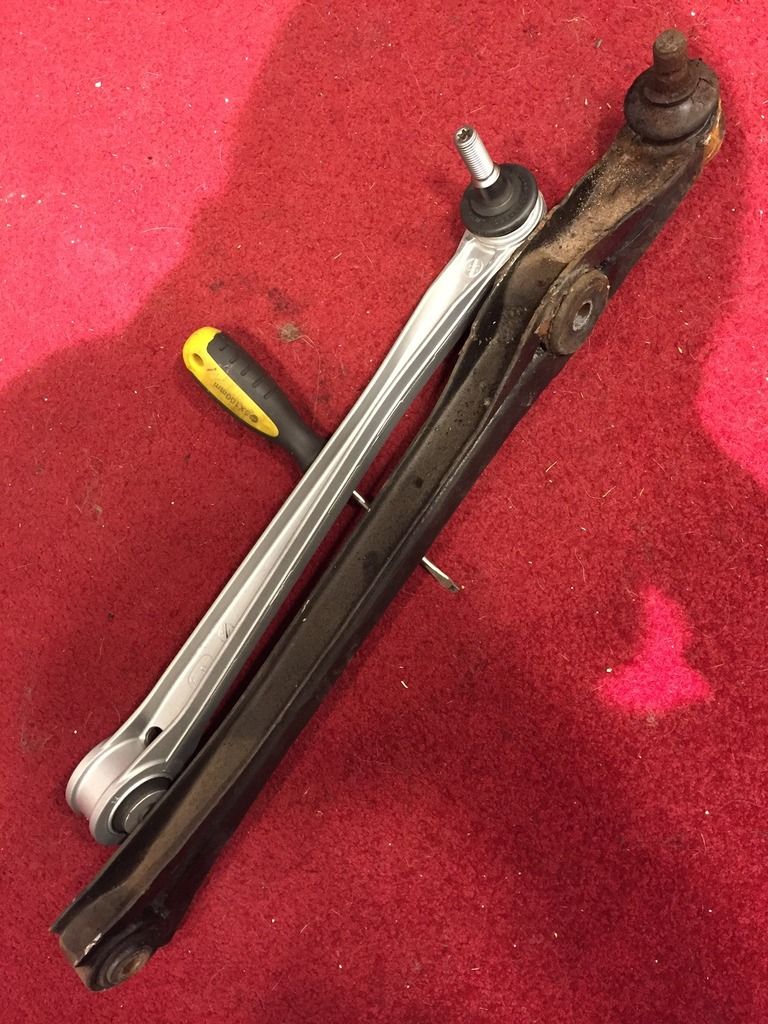

Wally December 18th 2016 16:40
http://i174.photobucket.com/albums/w...t.jpg~original
This would be nice, but unfortunately it doesn't fit...
Alu one is porsche GT3 rear and just 0,5 kg
Original lower control arm is 2 kg!
H2OSB December 22nd 2016 20:00
Wally--
I like the look of those arms, though having the Porsche moniker would immediately make them too expensive for me, most likely.
I have always believed the LCAs and their inner mounts are the weak point of the 1302/03 front suspension. The mount hangs down a bit, ripe to be smacked into oblivion during an unfortunate off. I think one could create a more stout inner attachment meant for those Porsche rear arms that would accommodate the shorter length. The only immediate issue I see is the lack of mounting for the sway bar, or, better yet, a trailing arm to isolate the sway bar.
If you were to create a mount to use those arms, how would to attach the sway bar?

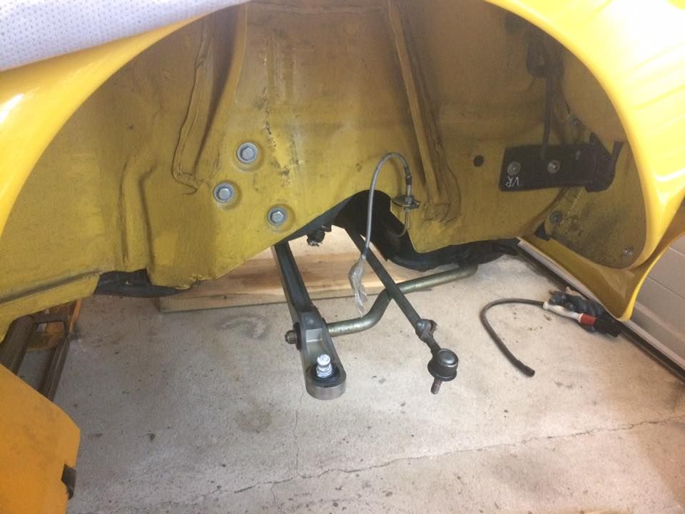

Wally January 9th 2017 15:32
Good points!
Actually although many have deemed the original LCA's a weak point, I think the construction is pretty solid and a nice combination of a wishbone kind of way combining the sway bar into the suspension set-up.
There is indeed no way to use the pictured porsche parts due to lack of sway bar attachment.
Sooo, I have come upon a small company in germany that makes an aluminium LCA for the late 1303 out of 7075 aluminium. However, his small batch was already sold out. Next weekend I am able to see one of those sets on a new years VW event in germany (Herford).
Of course, I'll try to make a picture of said arms.
Here's the set on Mario Asstmann's reincarnation of a GSR:
http://i174.photobucket.com/albums/w...y.jpg~original
and the rest of his car on FB:
https://www.facebook.com/pg/gelb.sch...=page_internal
H2OSB January 10th 2017 00:02
I like the look of those. Is that something still available? Are they super (no pun intended) expensive? Oh I saw the link. I will go look.
There is no doubt the original forged arms are plenty strong, but the stamped welded later arms are a weak point. You can stand on them and make them flex. Doesn't mean I won't get them sandblasted, prime then paint with black epoxy paint and use them...I'm just sayin.
