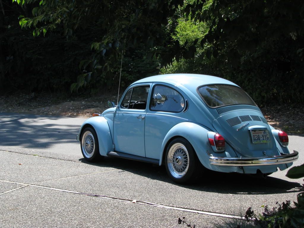

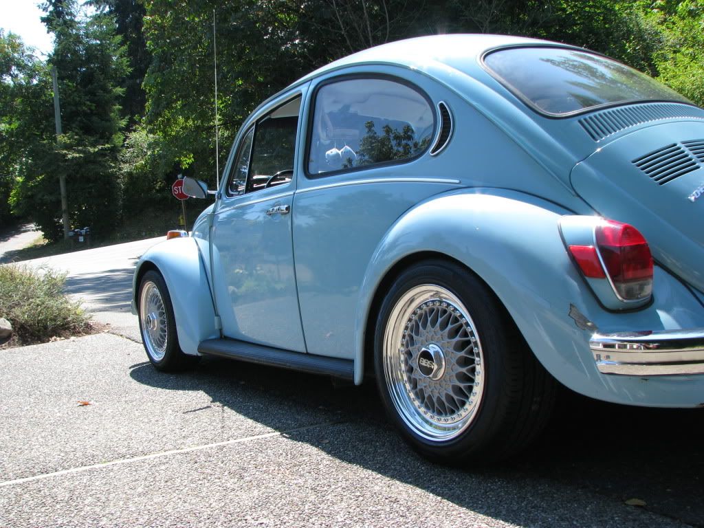

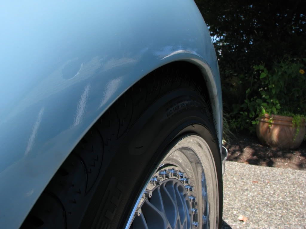

BBS RS's Mounted
I love it.

What size and offset did you use?
72marinablue July 28th 2009 14:50
They are 16x7 and 16x8 et49 all the way around. I have drop spindles in the fron that push the wheels out 6mm on each side. I am also running 15mm spacers in the rear. They do not rub at all. I had to take the stock swaybar off because the fronts were rubbing the clamps but other than that its good. Slightly smaller turning radius.
