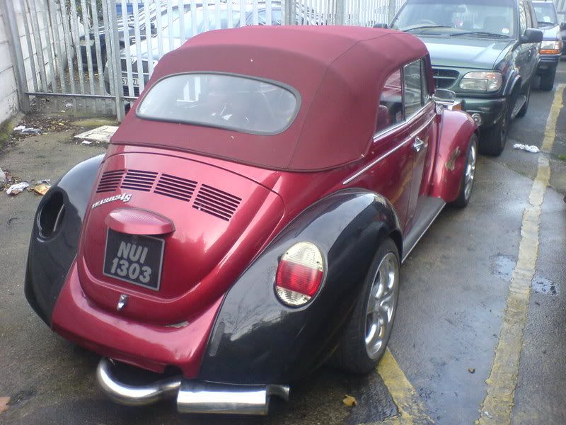

T151 December 13th 2007 10:32
I have polished C4 alloys on mine,
7x17 ET55 on the front, 9x17 ET55 on the back...
But I'm running late ali 944 arms with 944 Turbo brakes, No spacers - flits nicely under a 60mm oversized rear wing...
http://i58.photobucket.com/albums/g2...0.jpg~original
Still a work in progres...
