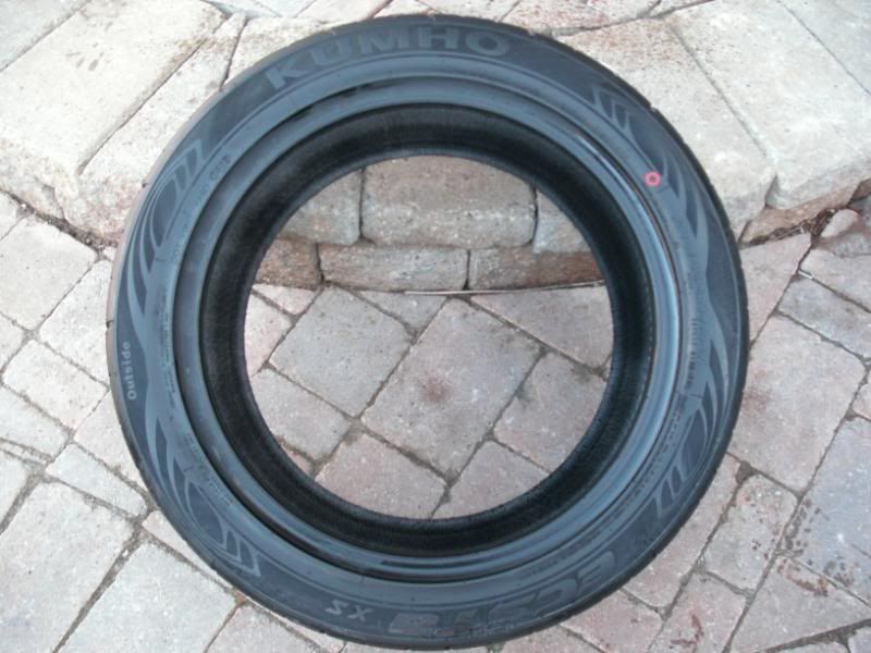

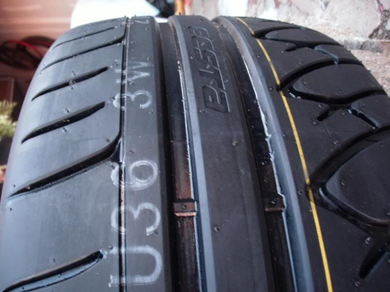

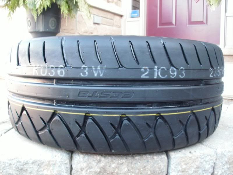

chug_A_bug March 8th 2010 18:53
So I ended up getting a Set of Kumho XS
F 225/45R17
R 235/45R17
