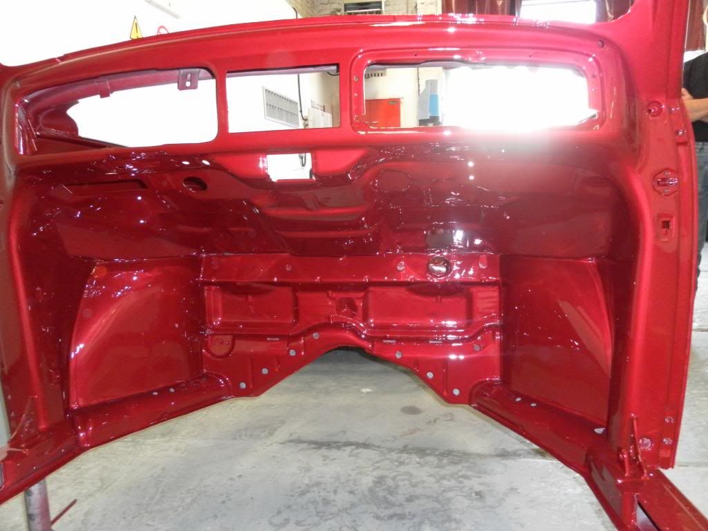

strokeit January 13th 2011 17:44
Hi Folks.
Just thought I would post up some pics of Daves progress, plans are to get it back to this years Volksworld show, not completed but well worth a look.
Enjoy:)
http://i210.photobucket.com/albums/b...8.jpg~original
http://i210.photobucket.com/albums/b...0.jpg~original
http://i210.photobucket.com/albums/b...1.jpg~original
http://i210.photobucket.com/albums/b...7.jpg~original
http://i210.photobucket.com/albums/b...9.jpg~original

volkdent January 14th 2011 13:19
That's so weird, it's like deja vu when I look at the cuts he's made to the body, I even have the rear air intake area opened up almost identically. Of course you can eat of his and you might get a little dirty trying on mine! What is planned for the engine? That's a lot of space for 'something'.....

dub_crazee January 14th 2011 16:00
some really nice details on this car! mexico side trays and tabs in the door shuts are cool.
is it goin to be a water pumper?
lookin forward to seein it at volksworld - think this will get more interest than mine lol
dave forder January 15th 2011 17:21
Thanks Dan for posting the pics. Will get some more on when the Wife can be bothered!
To bring everyone up to date the engine will be Type 1 Air Cooled and Water Cooled (water jackets over the heads) so I can run decent boost without it getting too hot. 2332 turbo autocraft case, superflow heads, big holset turbo, charge cooled. Should be good for over 400 hp. The car is built to go up the quarter mile pretty quick and to be rapid round the twisty bits. Will get some more pictures on soon to get you all going.
