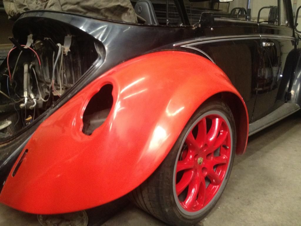

Bugged January 1st 2013 02:07
Hey guys, still waiting on them... The holidays has pushed my shipment back repeatedly. Should arrive soon and you know I will post pics here and in my project build.
SuperRSi January 2nd 2013 16:58
It took over a month for my Kerscher rear coil-over shocks to make it from Germany to New Mexico. By DHL, so it is what it is on shipping.
Bugged January 4th 2013 08:41
Fenders arrived!!! Fitment is pretty sweet! Will post soon, need to get ready for bed now.
Actually... One teaser.
http://farm9.staticflickr.com/8212/8...37400883_b.jpg
Ok maybe 2.
http://farm9.staticflickr.com/8351/8...3d6bf7e6_b.jpg
I was worried the tires wouldn't tuck nicely, but seems like the fitment couldn't be any more perfect!

I just took a wild stab and ordered the 11 inside out rear and 6 inside out front. $1600 shipped to New Mexico! I better like them...
This is what the wheels look like on the car. And yes it has been in storage 10 years!
http://i1119.photobucket.com/albums/....jpeg~original
SuperRSi July 3rd 2013 21:28
I would show you pictures but United Airlines lost the paper work for over a week, so I cannot clear them through Customs!
SuperRSi July 21st 2013 15:22
Only had to pay $31. in duty! Took them two weeks to find paperwork but pretty cheap.
So here is an 11cm inside and outside Kerscher fender on a 79 Beetle with late aluminum rear arms and 2004 NB Porsche OEM 11 inch GT3 wheels. There is not a rear brake disc on yet so the wheel will move out a little on its own. Will run spacers if necessary to bring them right. Sorry the light was bad for the cell phone picture.
