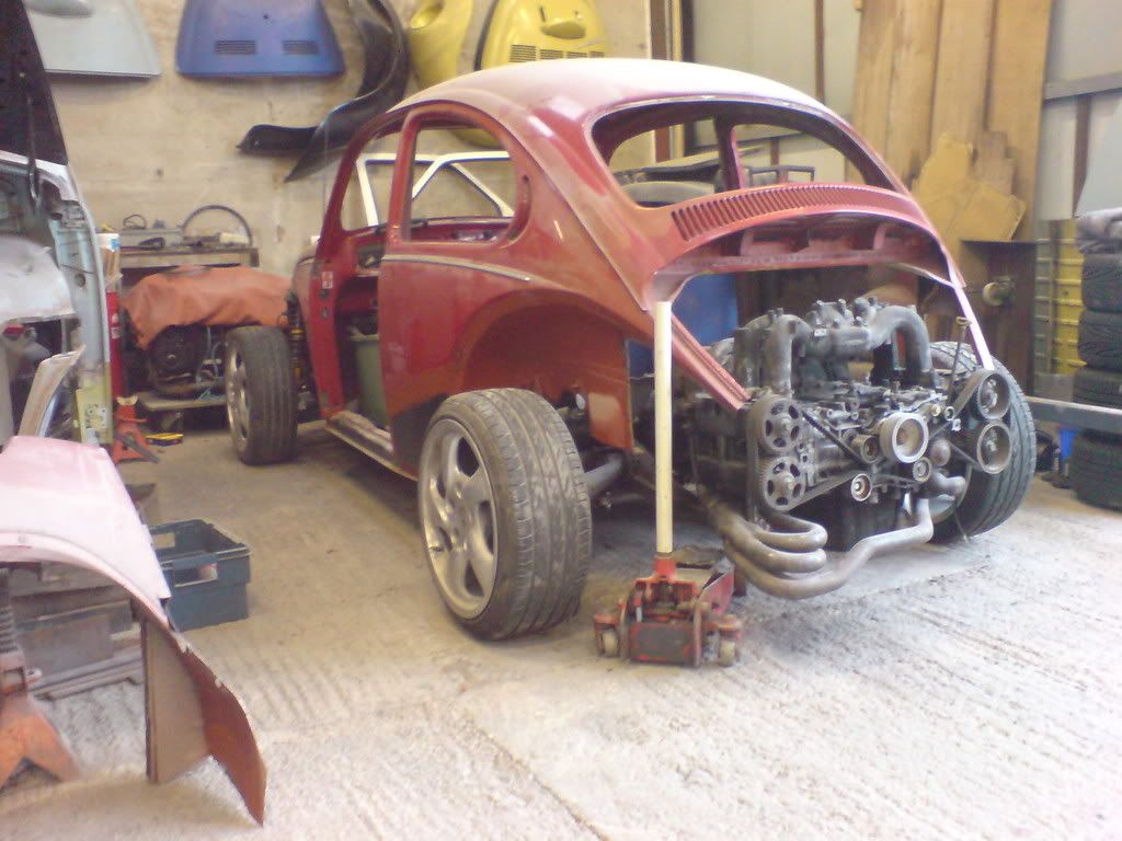

Got started mocking the bug up over the past month.
Chopped my fire wall out.
http://i178.photobucket.com/albums/w...8.jpg~original
Mounted 944 arms.
http://i178.photobucket.com/albums/w...1.jpg~original
Built up a motor and gearbox to get all mountings and body mods sorted.
http://i178.photobucket.com/albums/w...6.jpg~original

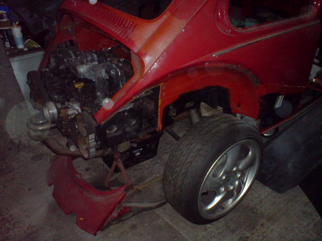

Got some more done last night, more chopping with my trusty grinder i must be mad hoping to hang the engine in this weekend/next week to get the mounts fab'ed up.
http://i178.photobucket.com/albums/w...0.jpg~original
http://i178.photobucket.com/albums/w...9.jpg~original
http://i178.photobucket.com/albums/w...5.jpg~original

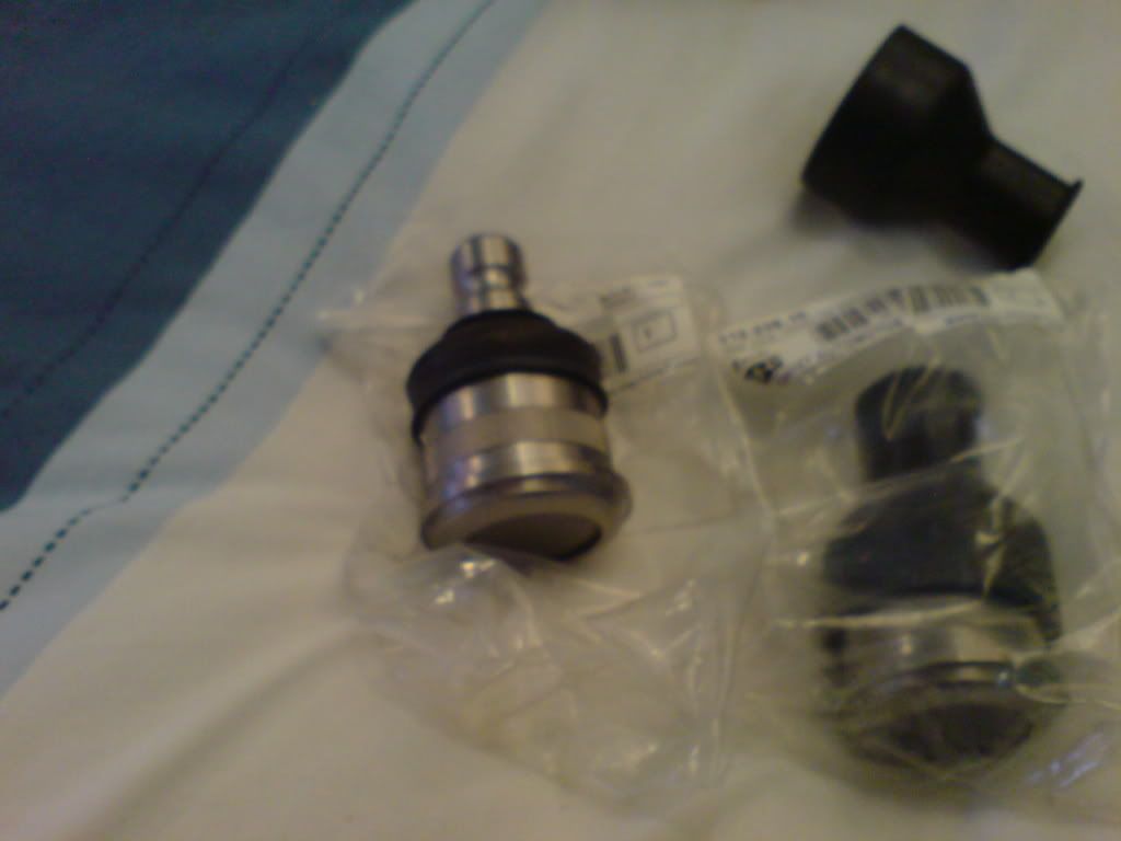

Think its time for my yearly update LoL progress has been a little slow seem to be doing more to my daily drivers than my big projects but heres a few new pics i have made some progress abit slower than i would like tho. My new 17mm ball joints came today early crimbo present for myself.

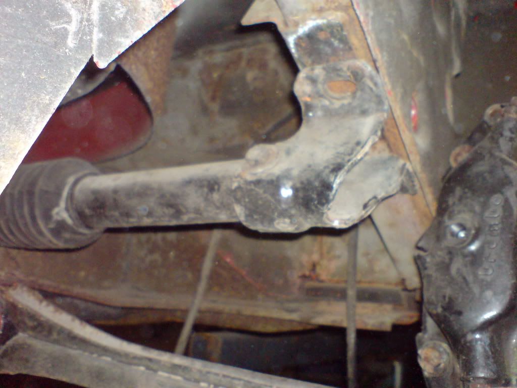

Heres some from before i made the front mount ive removed the centre of the torsion bar so i could raise the whole lot up still very much a work in progress though. Naturally i will be fully bracing the area around the torsion bar.
Hope these are some help i will take some more later today. Have you done anymore to your cab yet ricola?

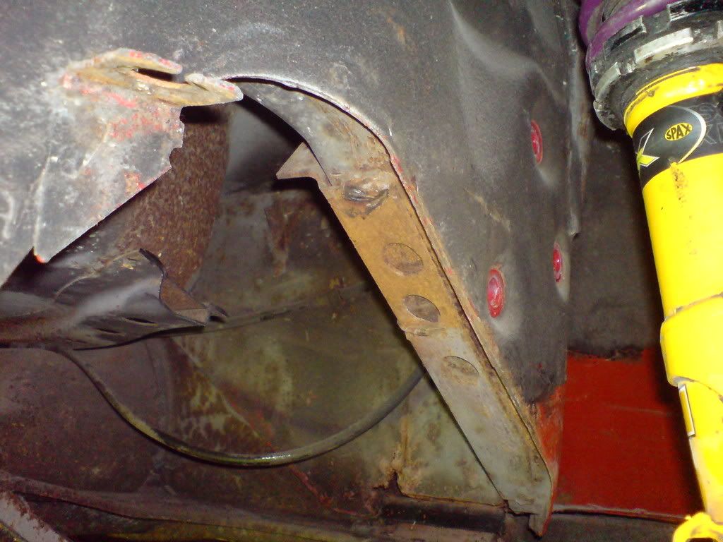

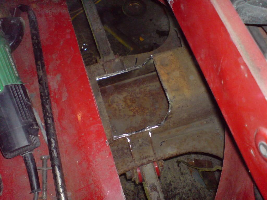

Got cracking on the rack conversion yesterday started taking some step by step photos didn't think i would need to cut so much out but least its in there just got to plate up the chassis now and mount the rack on the body.
http://i178.photobucket.com/albums/w...3.jpg~original
mccarthy500. I will need to clearance the wings because the engine is higer up than usual the cam belt pulleys will be outside of the bodywork. When i remove the rear mounting for more bracing i will take some more detailed pictures for you. Thanks for the postitive feed back.
