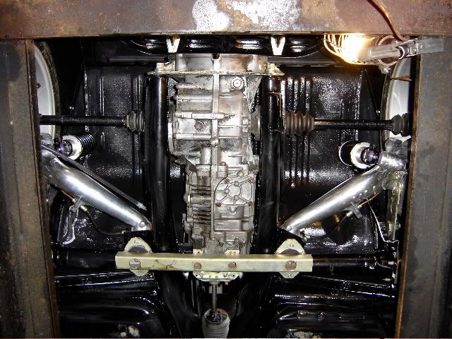

im going to install a 915 transmission of a 76' porsche 911 i am running the 86' 944 turbo aluminum trailing arms with the 86' 944turbo axles my question is will these work on the 915? if not then what axles do i use?

That depends on what CV's size the 915 had. Its not the axles, but the CV's that need matching. Some 915's had 100mm CV's, like mine. 944 is always 100mm...

I used early 944 axles and CVs on my 915 and they bolted straight on, not all 915 flanges are the same. FYI, mine was from an SC..

Well, if this helps any. I've got a '86 915 out of a Carrera, and '87 944S CV's and shafts with '87 ali arms. They bolt to the 915 flanges.

Then you were really, really lucky, as most late 915's have 110mm flanges/CV's and the 100mm 944 CV don't go with that.

Wally, I thought it was kind of strange too. The axles are marked '87 944S, but may be wrong (written with paint marker from salvage yard) I had one of the axles with me when I went to pick up the tranny, and the CV bolt holes matched the 915's.
wrenchnride247 March 15th 2008 22:16
I looked at my axles again today, and noticed that they are marked 944 S2 (not 944 S). This maybe why they bolt to the 915 flanges.

Basically all 100mm joints are the same bolt pattern. The early 944 (83-85), T4's, Thing and bay window bus CV's all are 100mm with the fine spline (33). They will fit onto a T1 shaft, but they are wider (thatn T1) so you will have to machine the shoulder on a T1 shaft to accomadate the extra width of the joint for the retaining clip. Alternatively, you could leave the clip off...? The 944/T4 joints have smaller balls than the bay window joints, so the 944/T4 ones can handle more misalignment.
I think for your setup the ideal solution is to get a complete early 944 axle with joints, and then change your stub axles on the wheel side to 944 early aswell, so you have 100mm joints everywhere.
The later 944 (86+) are also 100mm, but they are coarse spline and do not fit onto a T1 axle-shaft.
The big 930's are 108mm I believe...

I got drastic and cut the entire rear torsion out to put a custom one in. I'm cutting about 9" from the middle so I can move the tranny up and forward. I don't have to worry about clearance as it's in a kit car. I took a rear torsion adjuster and split it in half and will weld each end on the inside of the torsion housing then fab up a mount for the tranny and engine support. Lots of fabbing but I still need to calc how far up and forward I can go without the 930 CVs binding. I think it's about 4" forward and up. ANyone else do this?
