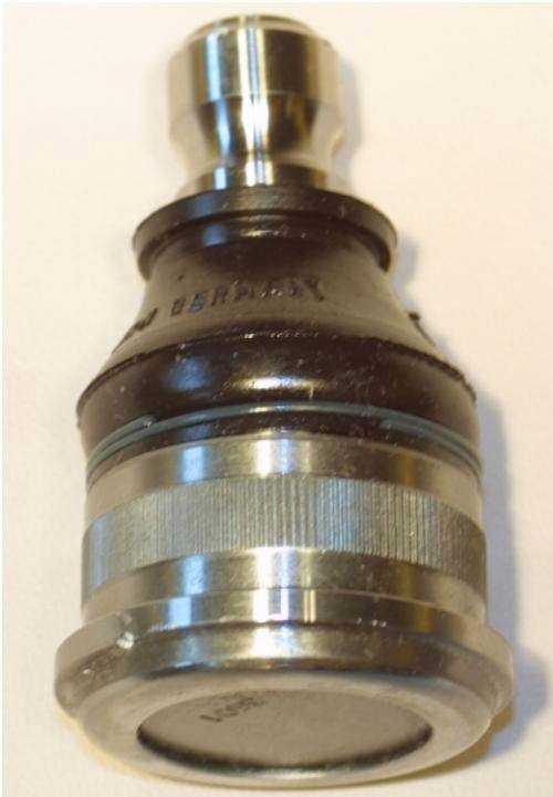

I think that the way to get a 1302 ('70 to early'73 SB) to work with 944 spindles is to get a pair of lower control arms from a 1303 (late '73 on up) I just found a set in Durham NC. 1303 control arms have ball joints that press into the control arms from the bottom, and have the ball stud pointing upwards.
944 spindles look much like late SB spindles, except they have provisions for mounting a caliper directly to the steering knuckle instead of to an adapter. I intend to use the 944 struts as well, except with SB springs as the 944 springs are much too stiff for a rear engine car, and with stock 1302 strut crowns.
The problem I am experiencing is the difference in the ball joint ball stud diameter. 944 ball joint ball studs are larger than 1303's.
Same is true with the tie-rod end ball studs. Anybody know what ball joints, and tie-rod ends to use?
yetibone

Thanks for the link Mike. I've contacted them and just heard back today.
The closest fit I could find for those ball joints are ones for a Dodge Omni (EEK!):toilet:
Oh... yeah, I also found out that the spindles and hubs we are using are from an '86 944, not an '87 like I thought before (I've honestly never dealt with any Porsche parts before other than working on a '76 914 2.0, so I didn't know) The brake rotors bolt on the back of the hubs we are using. I don't think this should cause any problem though.

Anyone have the OD for the stock 1303 ball joint handy?
(and perhaps the length of the late arm)
The ~1980 version of the Omni BJ looks close... As does a Chrysler minivan.
Same style as the 1303s, but retained with a snap ring.
I'm wondering if I could stick them in some Chromemoly plate and weld to the existing 1302 arm, wrap around style.
Not looking at one at the moment, not sure if that's even practical, but would be able to set the width a little longer to cure any positive camber issue.
A extended/welded early steel (forged?) arm could almost certainly be stronger than the stamped steel 1303 arms, and could be easily designed to take the common Omni or perhaps minivan BJ.
Another possibility is add just a tab of CrMo and bolt on a Golf/944 BJ, seems to be more common and cheaper, same basic concept, depends on dimensions,.
Saves having to buy a late sway bar, too.
The bit of steel I'm visualizing would only cost a few bucks. Have a good welder handy, and the 1302 arms will be no loss if I have to use the 1303s.
Have a spare set anyway...

http://www.kerscher-tuning.de/images...cGc=&width=500
http://i10.ebayimg.com/02/i/001/0f/87/122f_1.JPG
http://i9.ebayimg.com/01/i/001/0b/c2/803a_1.JPG
http://i14.ebayimg.com/07/i/000/d9/01/6ce0_1.JPG
got to be a vag part
Simon October 11th 2008 13:06
Why do you think so?
