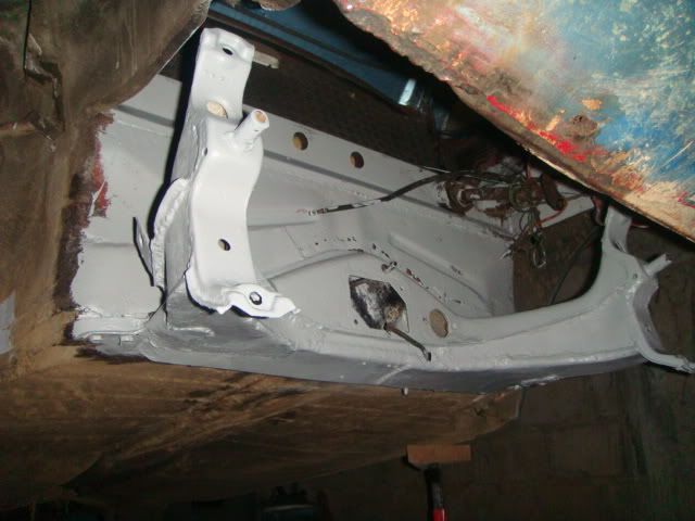

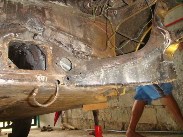

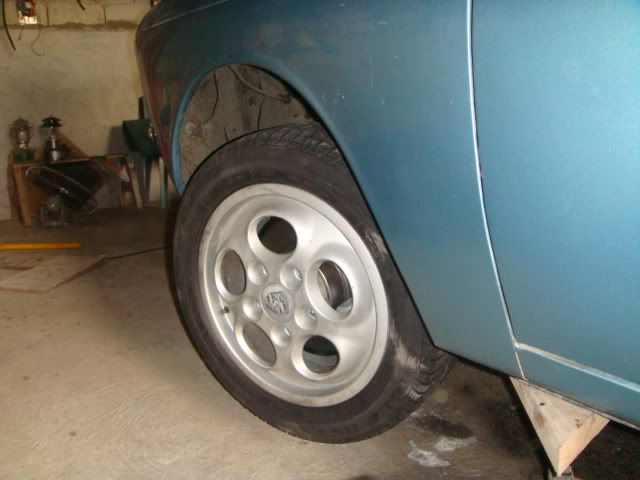

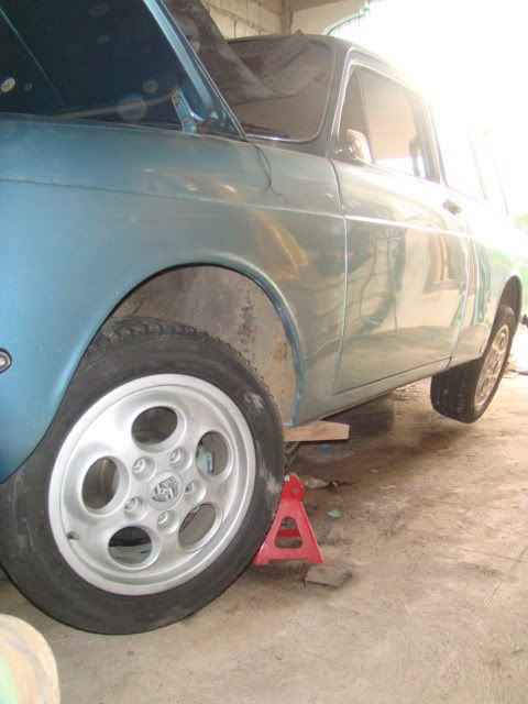

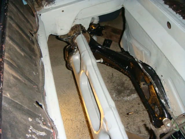

here the start of my german look square just spent the last 2 months rebuilding the frame head and replacing alkl the suspension and brake parts just got my rotors and drums redrilled and test fitting my 16' phone dials
still got a long way to go plan on add bug eyes so i can install early 911 lens, irs conversion, and a color change

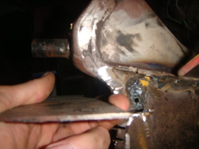

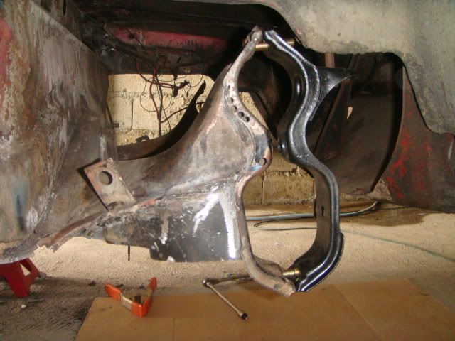

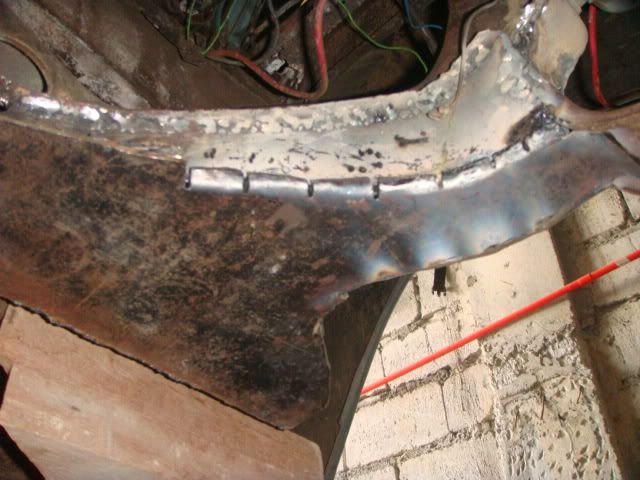

when i rebuilt the frame head i used 1/8 steel should stiffen up the ride alot.

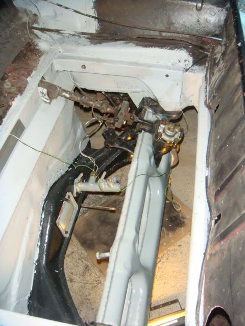

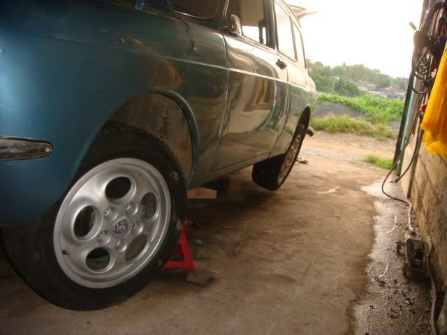

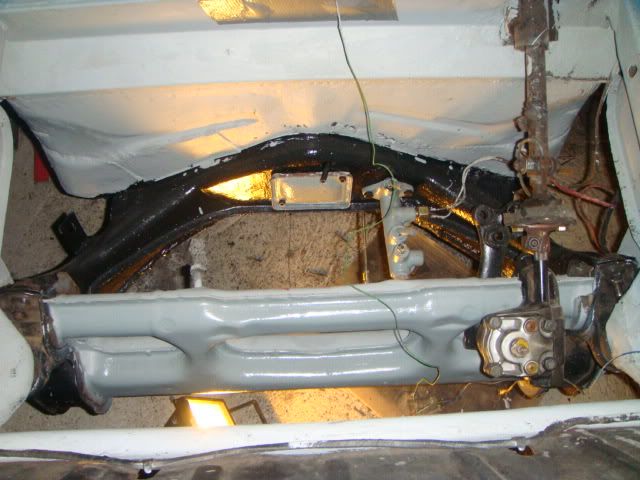

finally getting to the end everything is back together greased the front end put it back on the ground. just need to put the tank in and do up so little thing car should be rolling today
12mm spacers i had made
http://i154.photobucket.com/albums/s...e/IMG_5801.jpg
the wheel guides are inner tie rods from my polo classic that i just cut down
http://i154.photobucket.com/albums/s...e/IMG_5800.jpg
http://i154.photobucket.com/albums/s...e/IMG_5802.jpg
