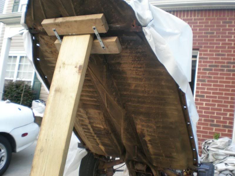

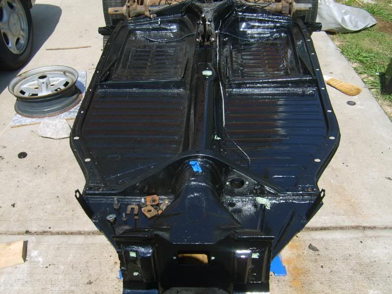

1970 original pan w/ one dime size hole in battery tray area, stripped, por-15 top and bottom
http://i11.photobucket.com/albums/a1...5.jpg~original
http://i11.photobucket.com/albums/a1...4.jpg~original

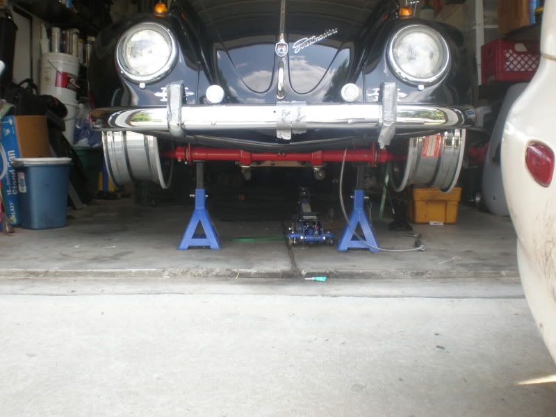

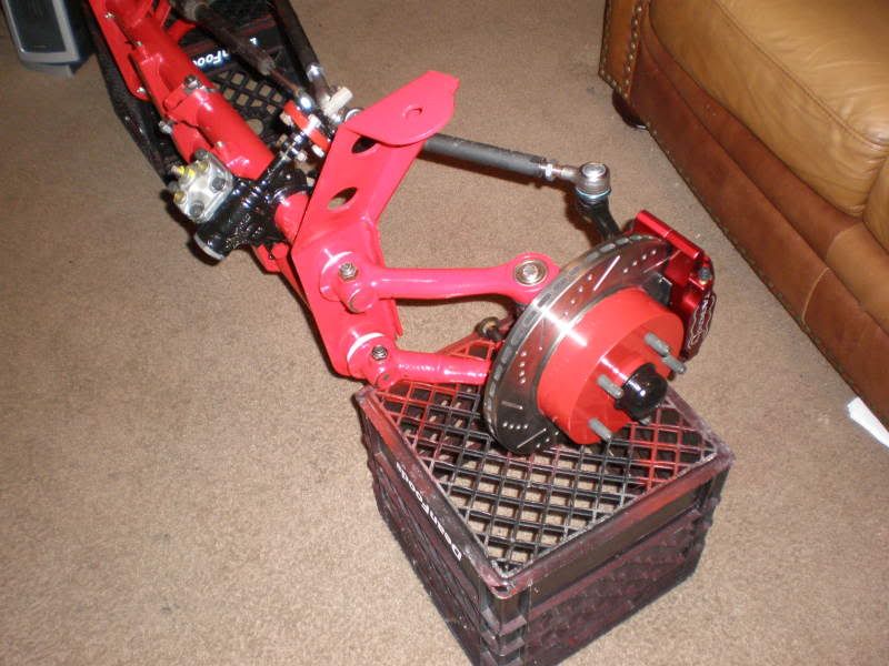

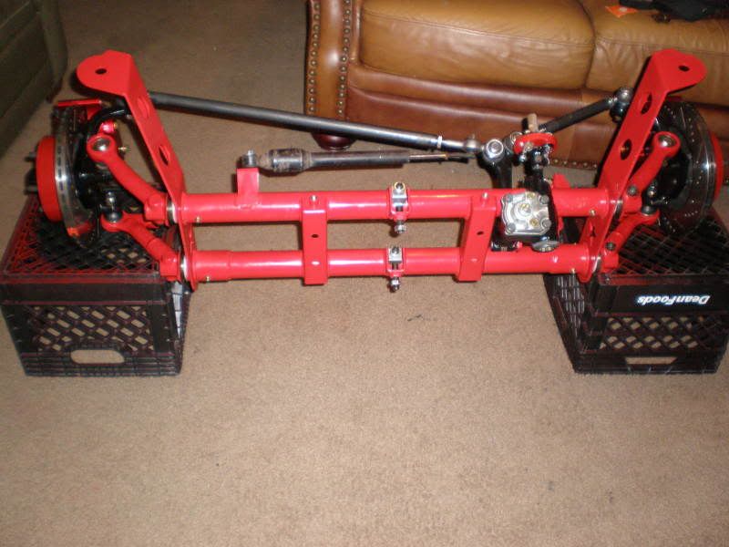

Bullet proof Front end:
4 in. narrowed beam from airkewld.com, then I added the steering damper mount and turn stop bracket from the original beam

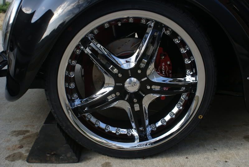

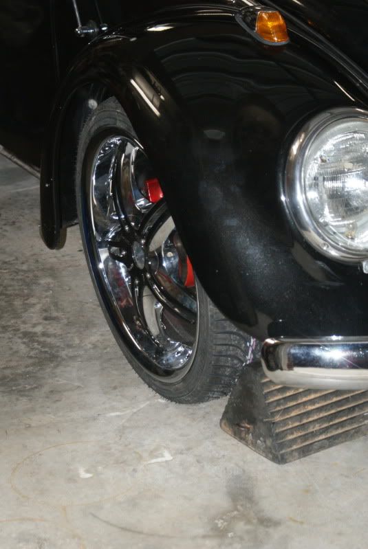

Tar-ox 6 pistons disc brakes front drilled and stud to 4.5x5 at vdubengineering, then cryod,slotted and dimpled at frozenrotors,I painted the rotors, the calipers came in red, steel braided brake lines,new steering box,
Superduty narrowed tie rods from vdubengineering, new tie rod ends, and new lowered balljoints
http://i11.photobucket.com/albums/a1...0.jpg~original
http://i11.photobucket.com/albums/a1...1.jpg~original

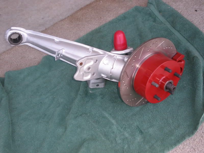

Rear end:
Reconditioned and painted stock trailing arms, all rubber replaced with urethane
Cb performance rear disc brake, drilled and stud at vdubengineering, then cryod,slotted and dimpled at frozenrotors, I painted the calipers and rotors
http://i11.photobucket.com/albums/a1...7.jpg~original

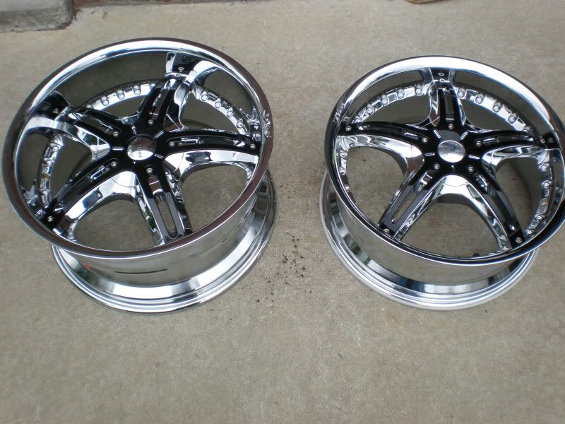

Wheels and tires:
D'vinci Attivo's front 18x7.5, ET.43mm, 215/35/18, rear 19x9.5 ET. 30mm, 265/30/19
http://i11.photobucket.com/albums/a1...9.jpg~original
http://i11.photobucket.com/albums/a1...8.jpg~original
http://i11.photobucket.com/albums/a1...3.jpg~original

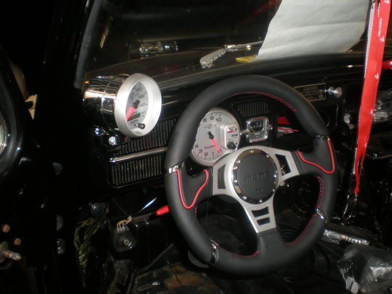

Interior: Momo steering wheel, AutoMeter UltraLight II gauges.

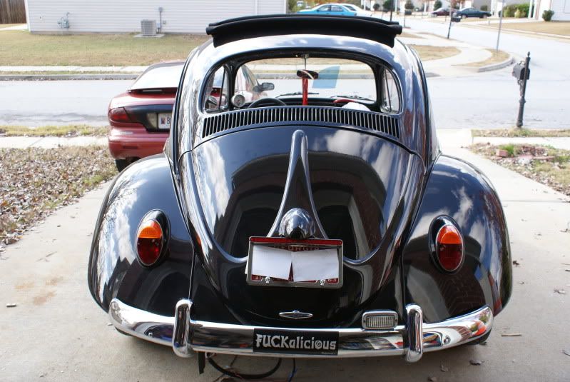

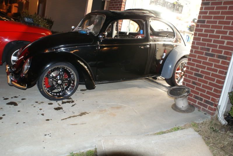

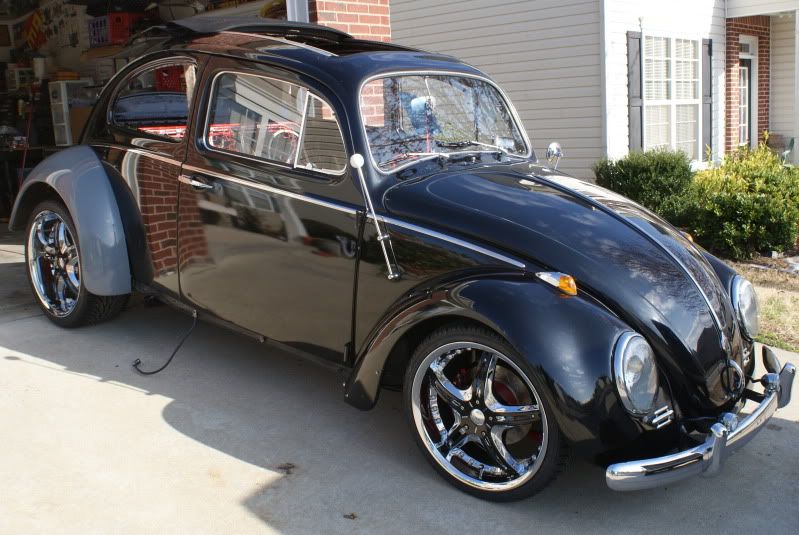

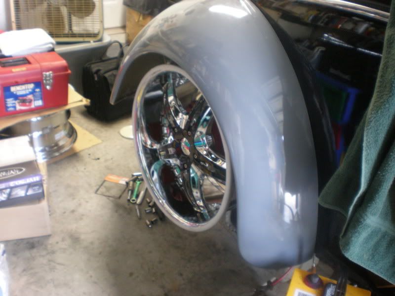

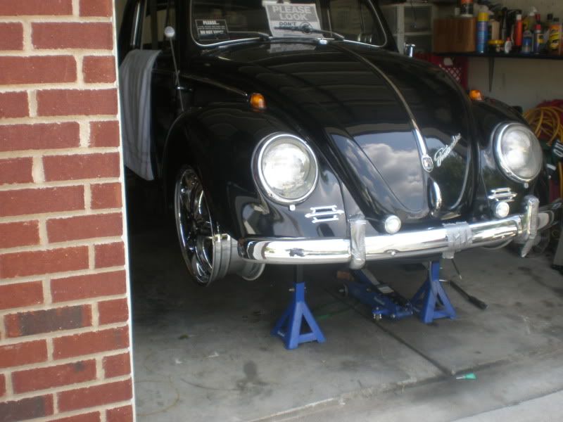

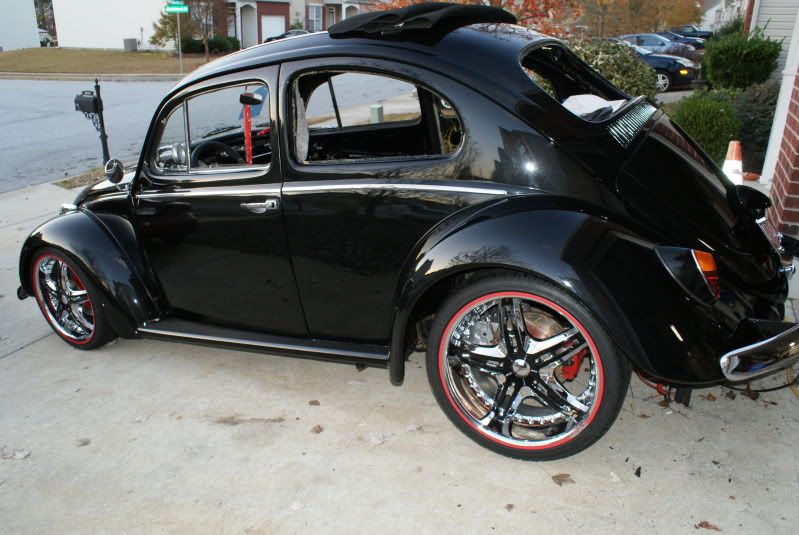

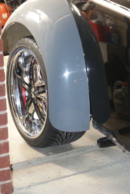

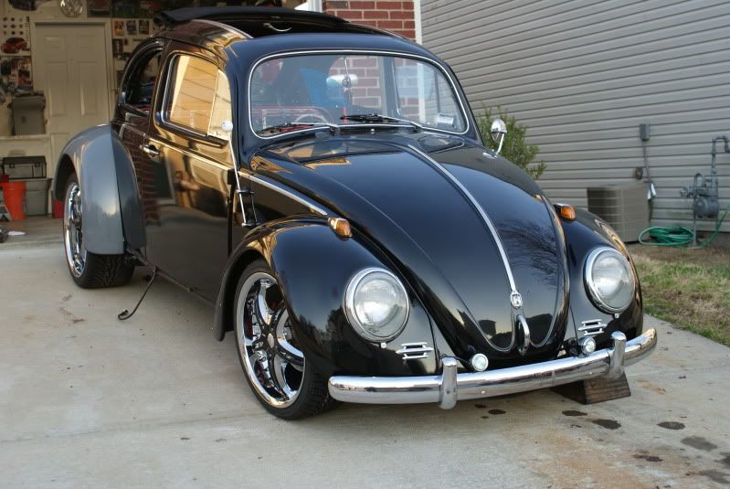

The only major change to the body was to add 3 in wider fenders from CCC. I had to redrill new holes in the bumper bracket in order to slide the bumpers rearward 40mm. I wanted big fenders and a rear bumper. This also cleared up some clearance issues I was having with the W decklid that Im using. Other changes were very minor such as script emblem on hood from volkswagen to street machince, fog lights, etc. By the way the car has a factory 3 fold ragtop, sorry none of the pics show it. The cover is black canvas. http://i11.photobucket.com/albums/a1...1.jpg~original

You should have posted sooner, we love to follow along, even if it is slow!!! I'll make a suggestion, and that is to build a sort of "strut bar" for the tops of the front shocks. I've been consistantly amazed at how Airkewled seems to ignore various stress points and the towers will flex quite a bit IMHO. A link between the 2 shock tops and maybe a tie in to the body would be good.

Thanks Jason I didnt know that. Its not too late. The body is just sitting on the pan. I haven't bolted it down, because at the rear I plan to install a torque bar from Lanner at vdubenginering.com. I will also talk to him about suggestions on a front strut bar for the beam. I plan to also use the the lower beam to pan braces. And mc-500 I agree the scat stealth seats are sweeet, I think they are the best in the scat procar seat line up.

Lanner would be a very good reference point, and for sure he'd be able to help you out if you decide to go that way.
