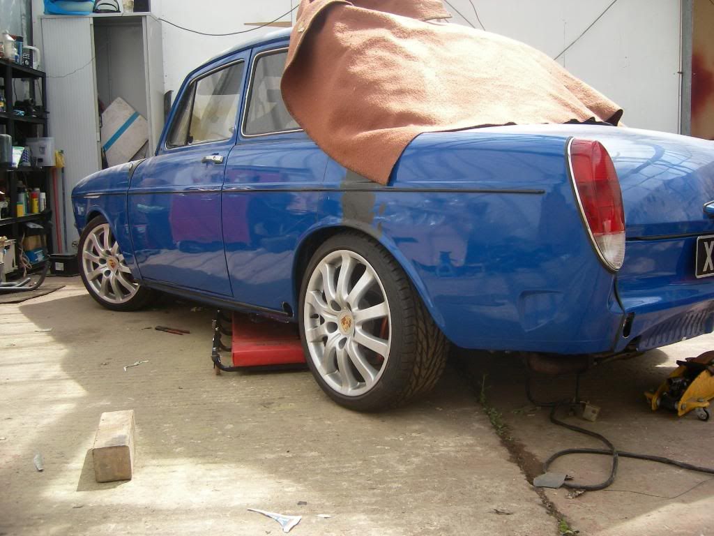

I got the full 17 X 7.5" wheels all round on my type three. (Sorry no lovely scenic photo from me:eek:)
http://i16.photobucket.com/albums/b3...3.jpg~original
Krukab
Your car is HOT :lmao:
