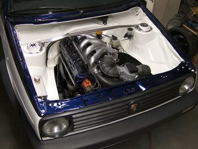

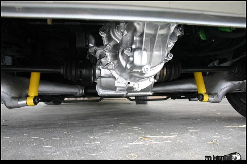

I also built/own this. Complete 944 drive train. 944 hand brake installed to the left of the drivers seat, same as the 944. Hand brake works excellent.

Thanks guys. More here at my web site. http://www.badassdubs.com/
I do have to agree with Clive. Something was probably set up wrong.
