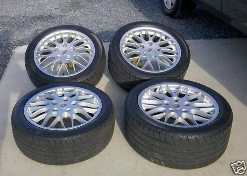

BBS Sport Design 17"
So I've wanted these 'hard to find' wheels for years and finally landed a set :cool:
http://img.photobucket.com/albums/v2...n.jpg~original
http://photos-h.ak.fbcdn.net/hphotos...n.jpg~original
8.5" ET50 / 7" ET55 front
255/40
205/50
I think I'll end up buying new tires eventually and go with 195/45 & 245/45

Those are smart looking wheels -- always a favorite of mine. Are you tweaking the tire sizes for clearance issues, or do need new rubber anyway and figure that's the best size for your application?

These tires have legal tread depth - but they certainly need replacing...Right now they're 25" F/R and I'm looking at getting something a little taller in back to fill the fender, while going just a little shorter in front. Have had D90's on for many miles with 195/50's - and like the <24" tire...I would be interested in seeing a 195/50-17 - but I know of no manufacture creating such a size.

Those wheels are hot.
When you posted the sizes & ETs I put them into to a online wheel offset calculator. Using a 7 inch x 23 ET Fuchs as a base line because I know these fit under stock rear fenders/guards, the 8.5 would have 46mm less inner clearance and 8 mm more outer clearance than a 7 inch wheel, so with stock fenders they might just work.

Obviously I like the BBS Sport Design line as well :D
