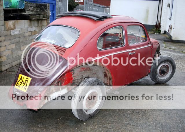

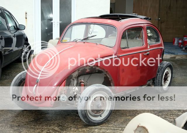

Here's some photos of how the car looked when I acquired it:
http://i535.photobucket.com/albums/e...4.jpg~original

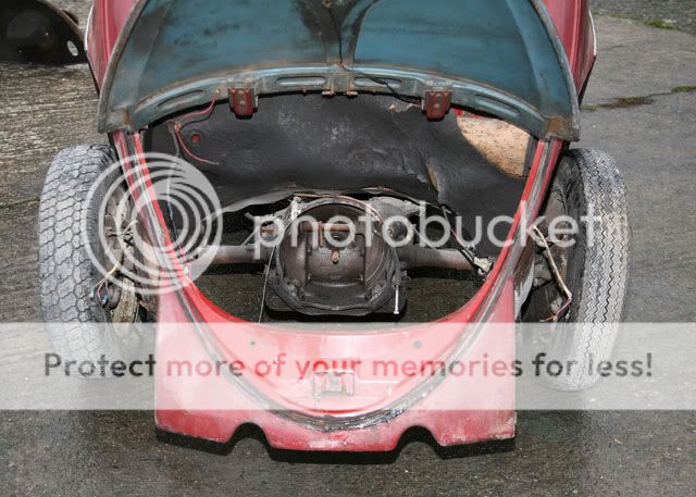

At some point in its life it has received a bump in the rear so it doesn't have its original decklid (nor its original number plate! :mad:). No problem as this one is rusted out and I've already acquired a replacement:
http://i535.photobucket.com/albums/e...6.jpg~original

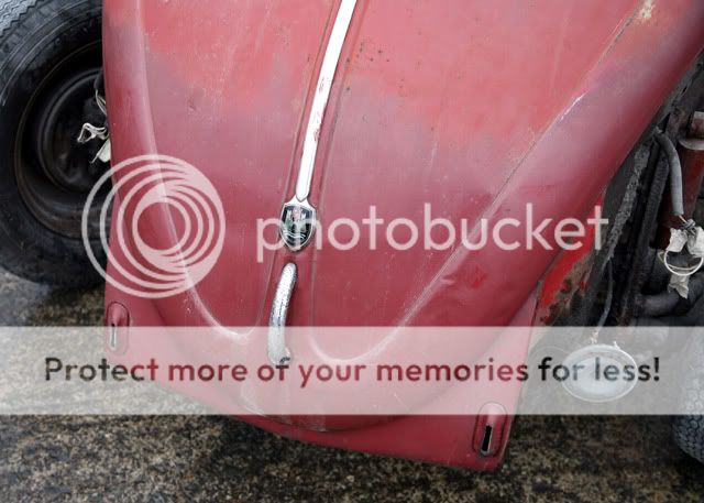

Bonnet is original and can luckily be saved with a bit of remedial work here and there:

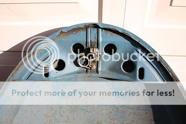

Front valance is good as is the panel below the fuel tank but it needs a spare wheel well:
http://i535.photobucket.com/albums/e...2.jpg~original
http://i535.photobucket.com/albums/e...5.jpg~original

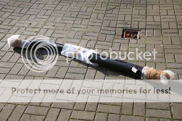

Needs a rear valance and rear bumper hangers:
http://i535.photobucket.com/albums/e...0.jpg~original

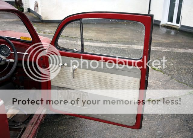

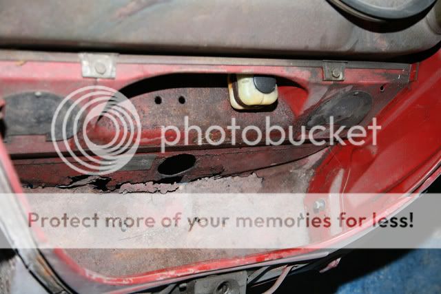

Doors are original and at least one of them can be saved. Not sure about the other one yet:
http://i535.photobucket.com/albums/e...1.jpg~original

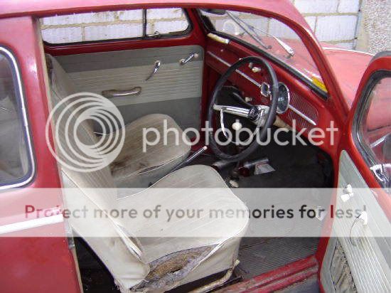

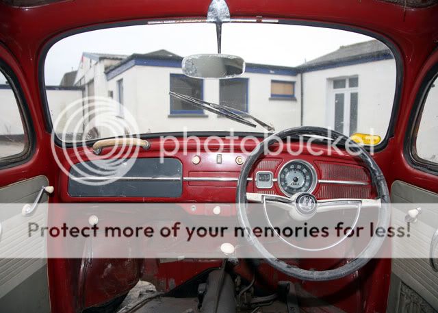

Dash is reasonably good:
http://i535.photobucket.com/albums/e...8.jpg~original

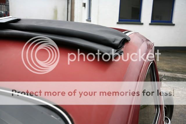

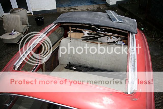

Ragtop is all there and open and closes perfectly:
http://i535.photobucket.com/albums/e...9.jpg~original

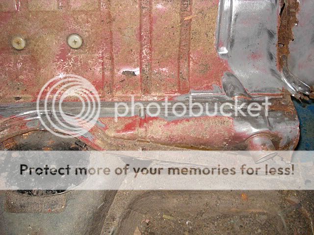

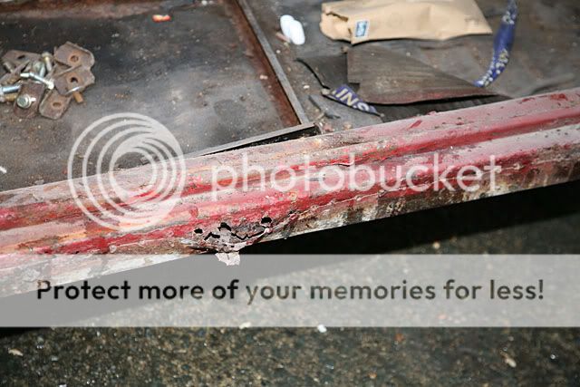

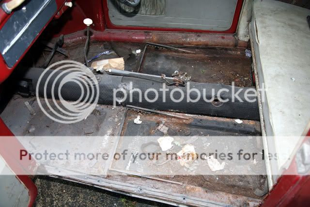

Needs both pan halves. You can see in this photo where a previous owner cut out the nearside heater channel in readiness for replacement:

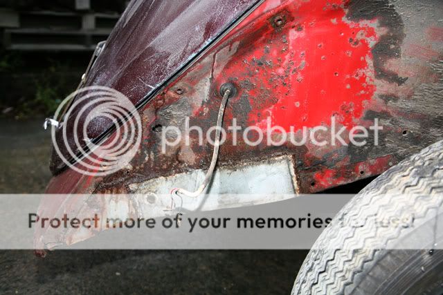

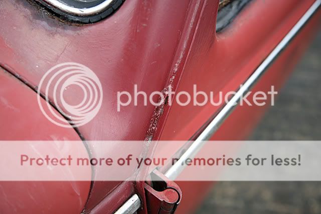

The offside channel needs replacing too as does the front of the inner wings:

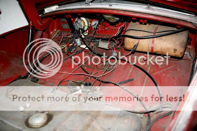

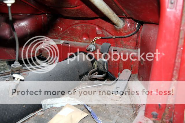

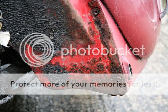

Rear is nasty. Need both lower quarters, closing panels, inner rear wings and both cross members:
http://i535.photobucket.com/albums/e...3.jpg~original

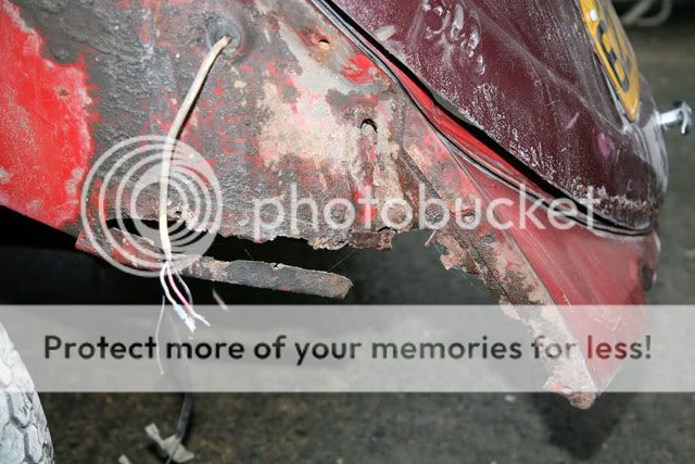

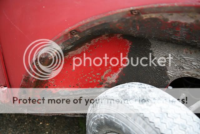

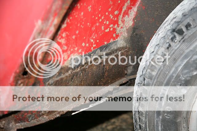

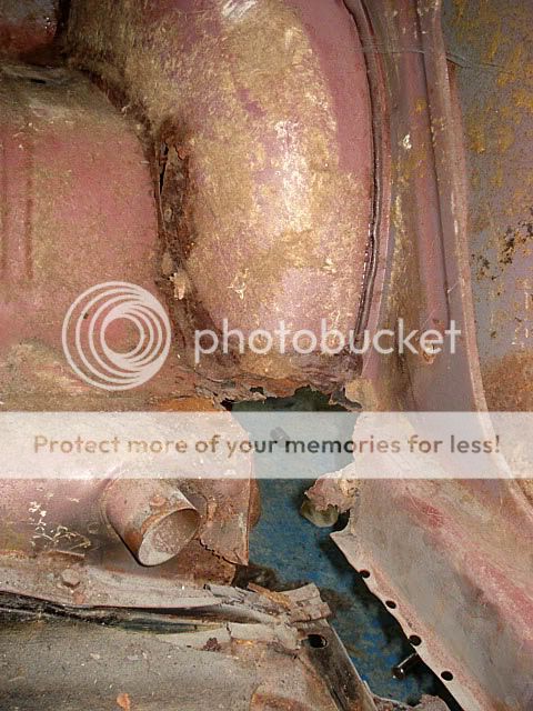

Few more pics of the corrosion. The bottom's of the front inner wings where they meet the valance look ok:
http://i535.photobucket.com/albums/e...7.jpg~original

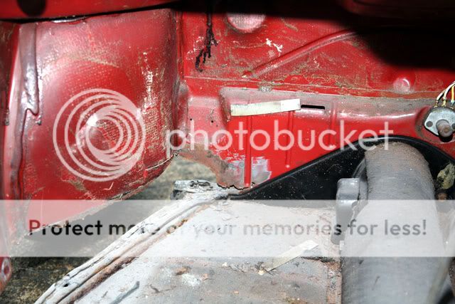

Original Ruby Red paint in the inner wings:

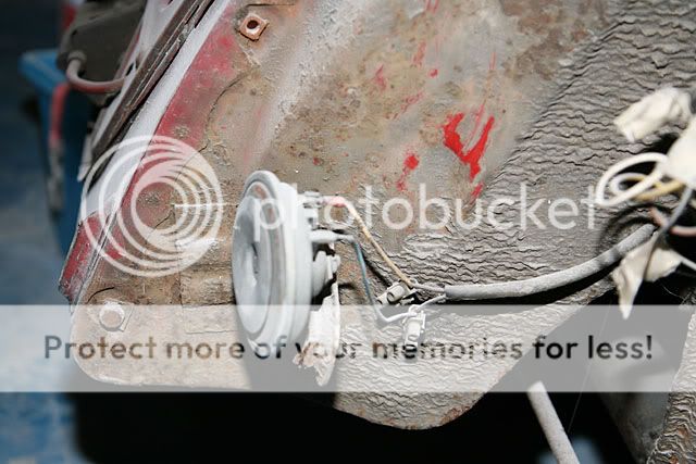

Note the creased inner wing from the bump it's had at some point:

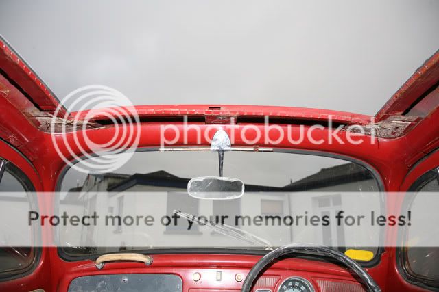

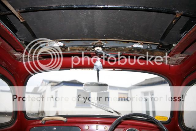

Metal around the sunroof opening pretty good:

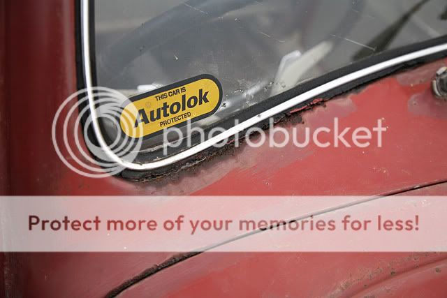

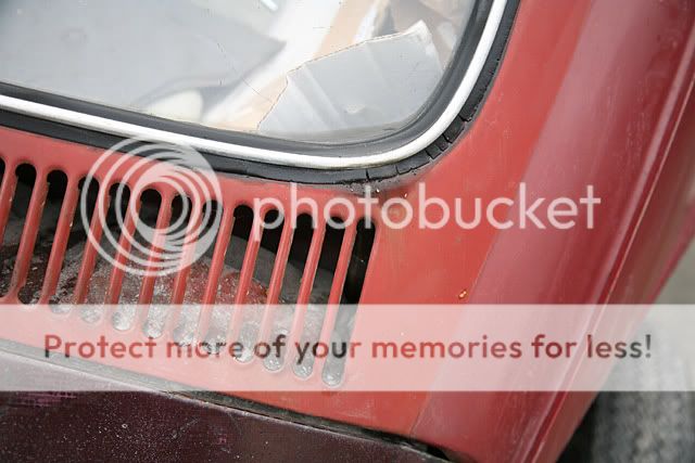

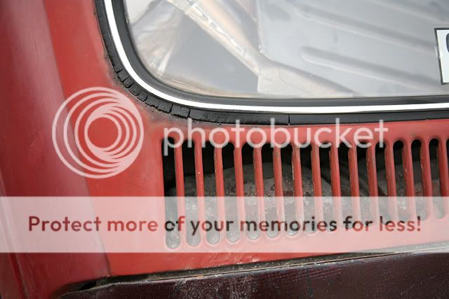

Corners of the windscreen will need looking at:

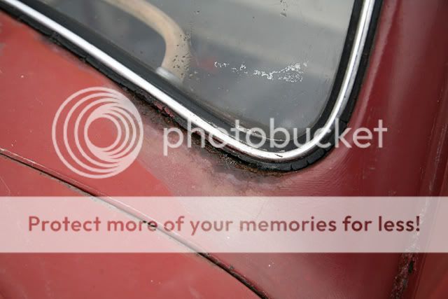

As will the corners of the rear window:

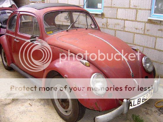

Here are some pics of the car taken not long after it had been purchased by a previous owner, presumably just after it had stopped being used:

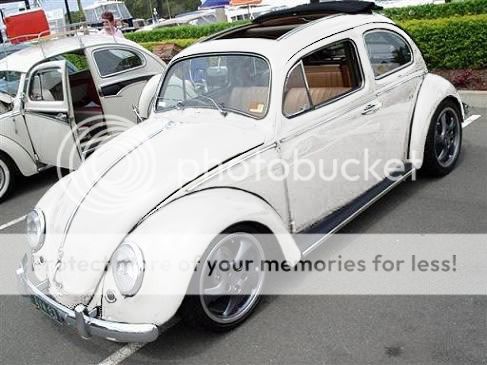

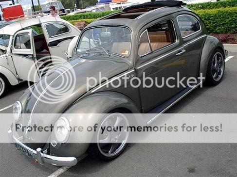

And here's a pic of the fantastic Bug built by Alan Agyik which has provided the inspiration to build this car:
http://i535.photobucket.com/albums/e...a.jpg~original

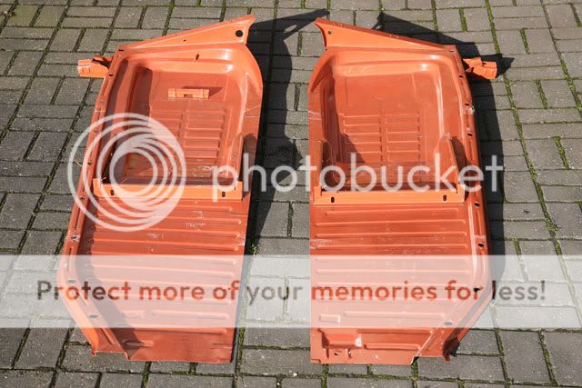

Pair of Heritage floorpan halves. I've actually since sold these as I discovered via my other project these are a bit thin. So I went out and bought some of the grey WW ones:

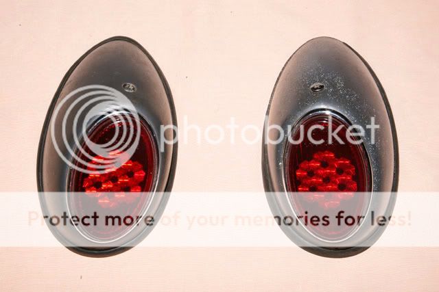

A pair of NOS 56-61 tail-lights. Not correct for the car but I prefer them to the 62 on units:

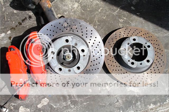

Boxster S front discs and calipers, a steal from ebay:

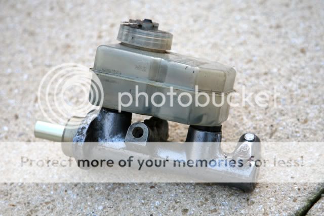

1985 year 2.5 944 master cylinder:

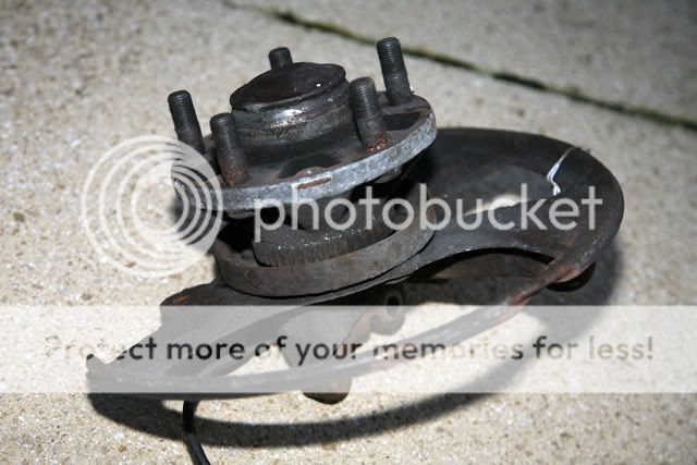

One 944 S2 wheel hub from ebay. Need to find another now!

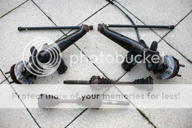

And complete IRS (steel) rear end from the same 85 2.5 944:

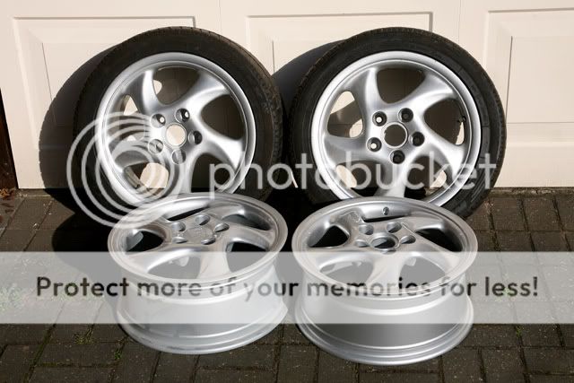

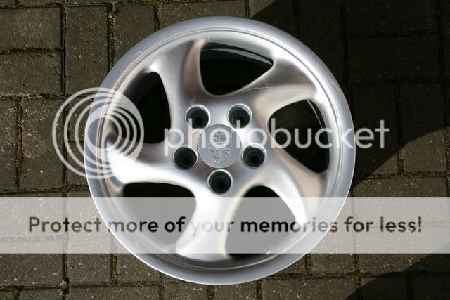

Managed to track down four never fitted 17" Cup 3's all with the required ET52:
All in pretty good shape with light scuff marks from storage but only one centre cap so if anyone has any please let me know. In fact I'm looking for another couple of wheels so again, let me know if you have any or know of any:

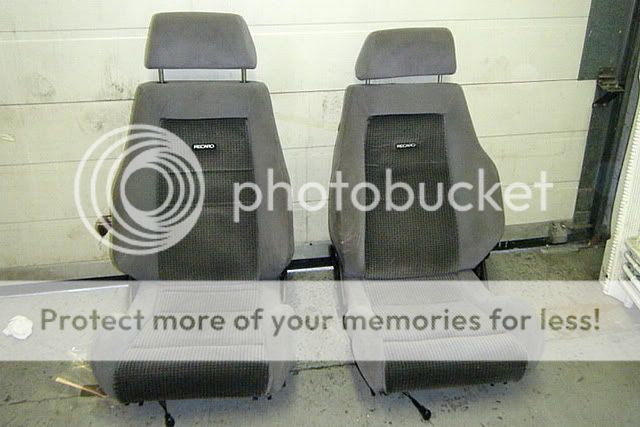

And finally a pair of 80's Recaro's from I think an RS Turbo Escort. Not sure though about these as I' m thinking a pair of 911 highback's or more race like Recaro's would look better:

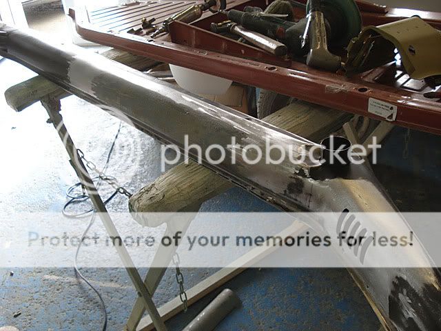

Also made a start on the welding. Not being done by me, I've entrusted the work to Gavin Jones at Trailer Queen Restos as not only is Gav one of the best VW painters in the scene he's also fantastically gifted when it comes to metal and bodywork. Here's what's been done so far, not much but it's a start:
First job is to replace both pan halves and channels so with the nearside channel already cut out Gav decided to start on that side first. Before actually starting on the pan he decided to replace the cross member. Factory spot welds drilled out to remove the corroded lower inner quarter metal:

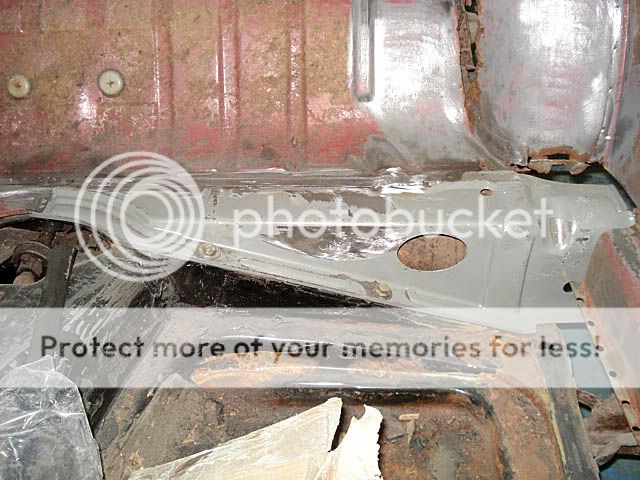

Factory spot welds exposed along the top of the old cross member ready to drill out and remove the metal:
New cross member bolted and welded into place. As you can see, being a new type panel it doesn't match the shape of the original but with so many modifications being done on the car I wasn't worried about not having the correct shape cross members! :lmao:

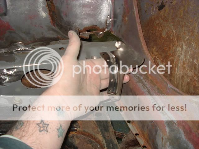

Small closing panel Gav fabbed up in order to reconnect the inner lower quarter to the cross member:

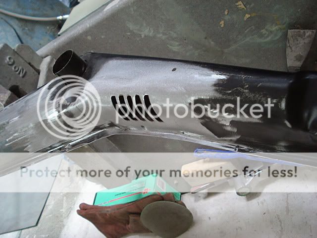

With the repro heater channel's being made for a later Bug Gav modified both the heater outlet and the inner skin in order for it to look like a 60's item:
