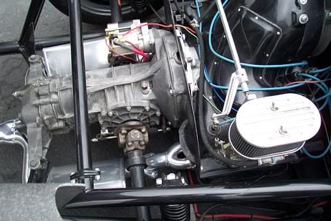

GS guy January 18th 2010 11:08
This is a Folts conversion on a 914 trans - in a Porsche Spyder kit car. Not mine, but I did discuss the conversion with the owner. Said it was expensive - basically a one-off done by Folts, and overall worked well except for some slight vibrations at lower speeds. So it can be done, just takes $$$!
IMHO, much better route is to convert chassis to IRS.....
http://i140.photobucket.com/albums/r...A.jpg~original
