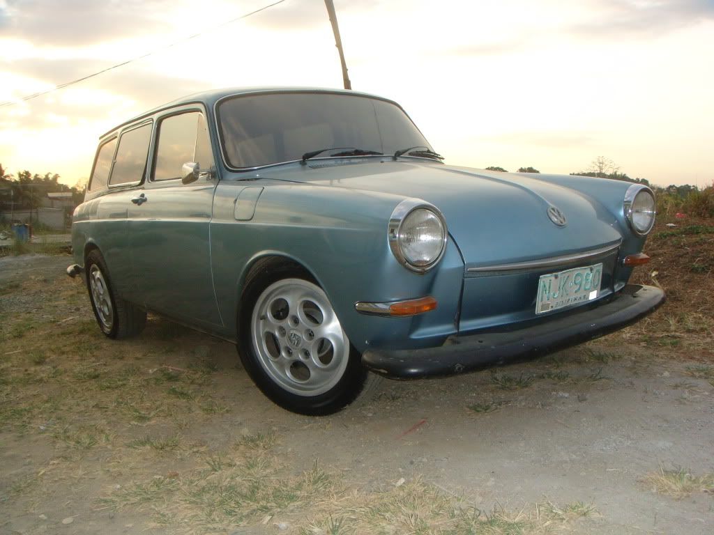

I have started adding a brembo brake upgrade on my squareback. 944 front hubs,993 front and rear rotors and brembo calipers from a 944t
I started the front as soon as I am done there will be moving to the back and doing a irs conversion and adding the alum arms from a 944,

Humble March 12th 2010 20:36
Looks great! How's the fit, any rubbing?
kombi211 March 13th 2010 11:37
Thanks everything fits nicely. the only rubbing i have is if i crank the wheels hard they tend to rub on the inner fender. but its not that bad. going to try spacing the wheels out a little more and see if that helps
72marinablue March 16th 2010 13:09
Great idea welding the 944 caliper mounts to the stock spindles. Looks great!
