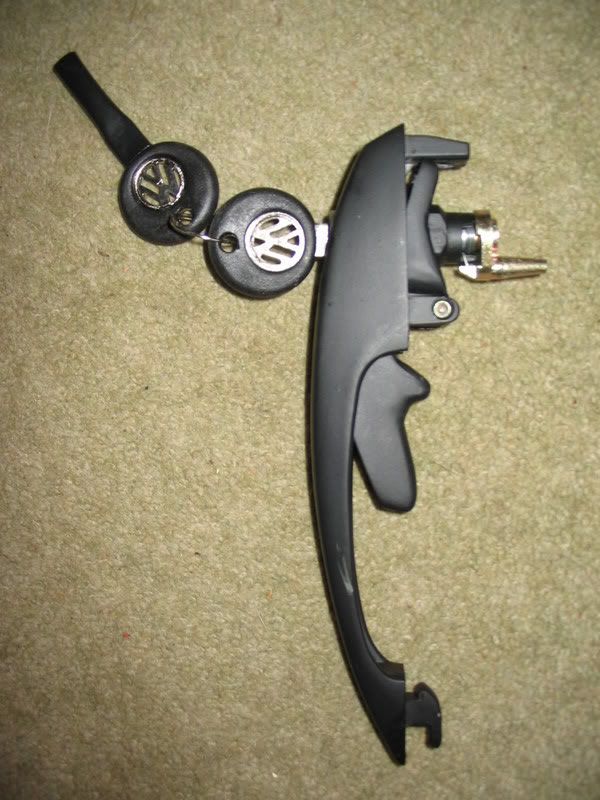

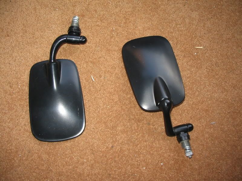

They do come up. I have some "raw" (primed in factory black) mirrors, door handles all brand new which I got from ebay.
Volkswarenhaus has quite a bit of stuff, from like what I have to window frames like the Jeans, but it'd probably be cheaper to get down the platers and have them stripped if the parts you have are good.
http://i61.photobucket.com/albums/h6...1.jpg~original
