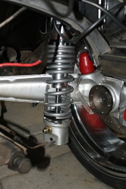

Qa1 Coilovers do not fit Stock trailing arms!
:confused:I did my research here on the QA1 coilovers. I purchased the 4855B model with 10 inch springs. They don't fit. The will not clear the shock mounting cup on stock irs trailing arms. Pics coming soon. So maybe Im doing something wrong. Does anyone have QA1 coilovers being used with STOCK IRS trailing arms?

Sandeep February 24th 2010 12:15
You just need to drill a lower mounting hole higher in the bottom cup. I will post pics tonight as I am now using the DDR4855P model now.
evilC February 24th 2010 13:36
If you do that I would carefully check the closed height of the damper to make sure that it doesn't bottom out.
Speed Dreamer February 24th 2010 13:39
OMG! WTF! :eek: Sandeep I ran to garage the when I read what you said. I honestly can not believe I didnt see that! Once again germanlook.net saves the day! Thanks so much Sandeep! I really see how simple that is, but then again please go ahead and post the pics because Im still recovering from one the largest brain farts in history!
EvilC thats a valid point. I will make sure I check that using a spare trailing arm.

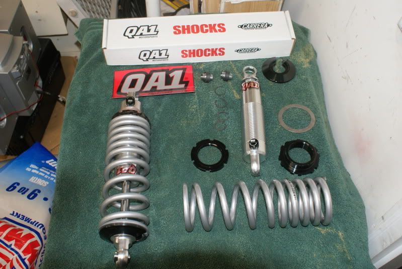

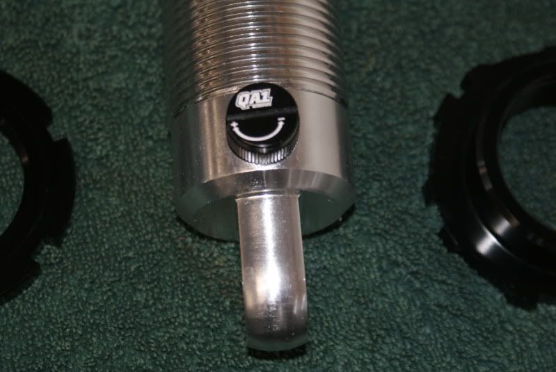

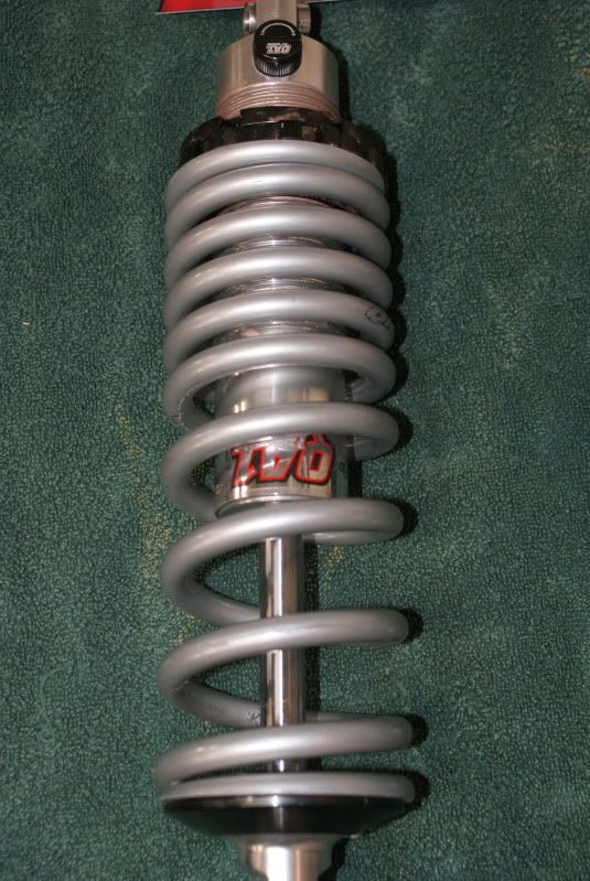

Speed Dreamer March 10th 2010 06:55
Opps!! Qa1 coilover do fit irs
Sandeep enlighted me on how the fit qa1 coilovers. I had to grind just a little clearance ( 5 to 7mm) around the edge the of shock mounting cup, in order to prevent any binding of the spring and spring perch. Check out the pics

Bug@5speed(US) March 11th 2010 22:04
Speed,
What did you do about the bolt size difference?
Did you open up to 1/2" and use same size bolt..
When I was looking at these, the thing I did not like was the fact that the eyelets were about 1mm to large for the standard bolts..

Alex, the eyelets are 1/2" and the only ways to get around it to sleeve the bore or upgrade to larger bolts. I upgraded to 1/2" hardware on my car and drilled out the upper shock mounts.
