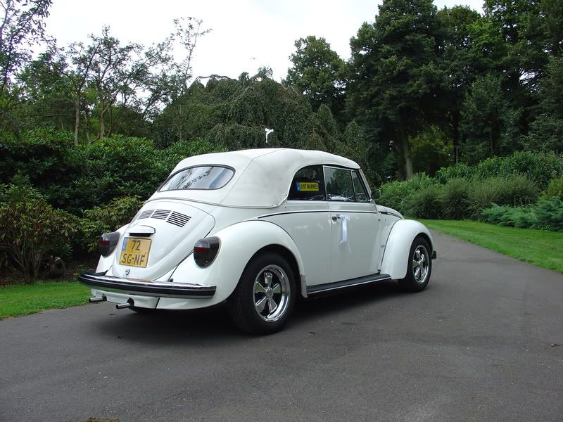

Hello, GL fan's. I'm Erik aka Blizzard from the Netherlands. I got this nickname because of my white aircooled rides.:cool: Like this '79 vert of mine.
http://i129.photobucket.com/albums/p...1.jpg~original
http://i129.photobucket.com/albums/p...4.jpg~original

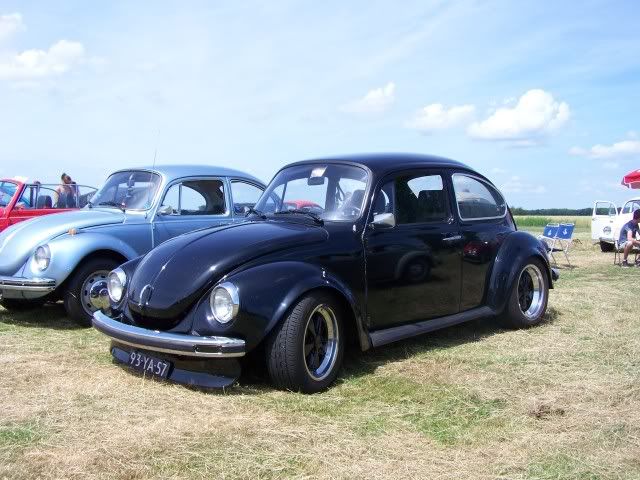

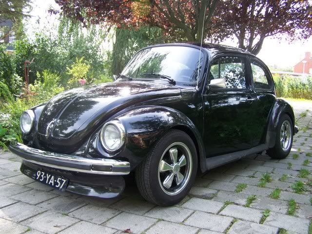

However, the 1303 in this topic is Black.:D
I've learned alot about upgrading a bug on this forum. Now it's time to start my own topic here on the GL forum. I already have a topic on a dutch site but there I won't find the right feedback and knowhow Everybody gets here.
In april 2008 I bought the ultimate basis for a GL beetle. A '75 1303.

In good company on the dragstip in Brunstem Belgium 2008.
http://i129.photobucket.com/albums/p...lding021-1.jpg
http://i129.photobucket.com/albums/p...eelding022.jpg
http://i129.photobucket.com/albums/p...lding023-1.jpg
http://i129.photobucket.com/albums/p...eelding025.jpg
http://i129.photobucket.com/albums/p...eelding024.jpg

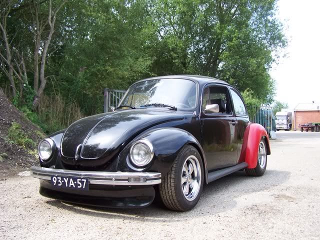

With the (new) used flared wings it looked like this with the 15" fuchs wheels.
http://i129.photobucket.com/albums/p...7.jpg~original
I did not like the look of the 15" fuchs under the flared fenders so I swaped an other set of 4 fully polished 8J x 15 fuchs wheels that I had for a set of 16" Fuchs that I polished and painted myself.
The edge of the wings needed some trimming to fit the wheels without rubbing.

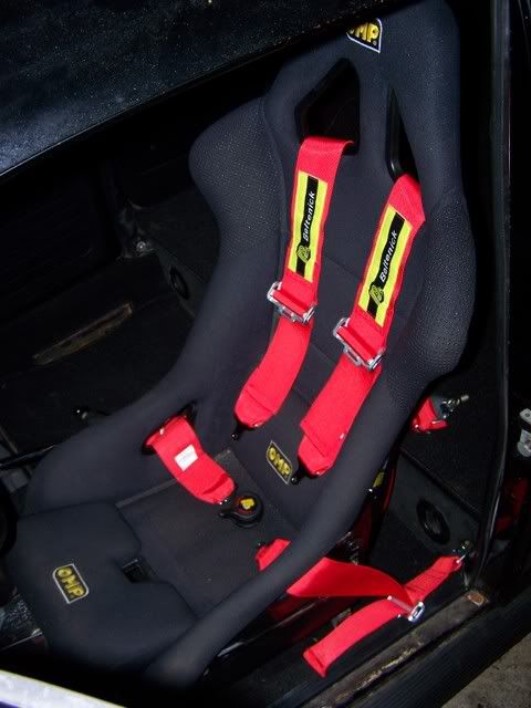

The next thing I did was detail the interior. New carpet and a pair of OMP seats and a 5 point harness.
http://i129.photobucket.com/albums/p...3.jpg~original

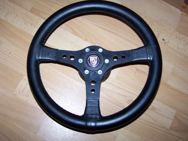

Porsche steeringwheel and a 944 tach. under the dash.

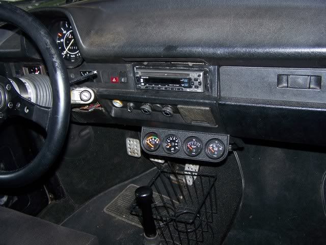

New panel under the dash for 4 gauges. I added a voltmeter and a tach.

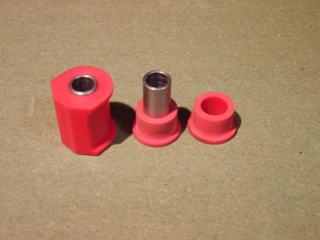

To fit the yellow Koni's (which were made for an IRS beetle) on the 944 turbo arms I made a bushing from an unused urethane bussing for a 19 mm. front anti rollbar. The 12 mm. hole is to small as you all know for the 14 mm. Bold for the 944 turbo arms. So I made a 2,5 mm thick steel insert outside 19 mm. inside 14 mm.
http://i129.photobucket.com/albums/p...8.jpg~original

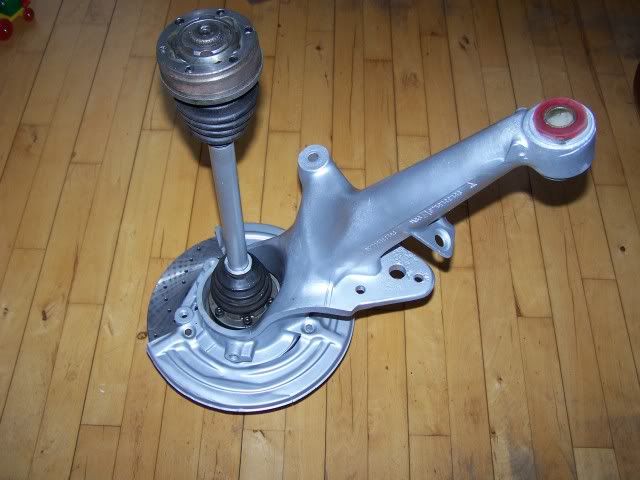

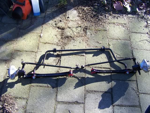

Rear arm complete with driveshaft and disk.
http://i129.photobucket.com/albums/p...5.jpg~original

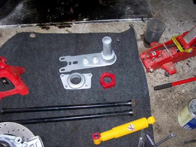

All the parts for the rear suspension before assembly.
http://i129.photobucket.com/albums/p...6.jpg~original

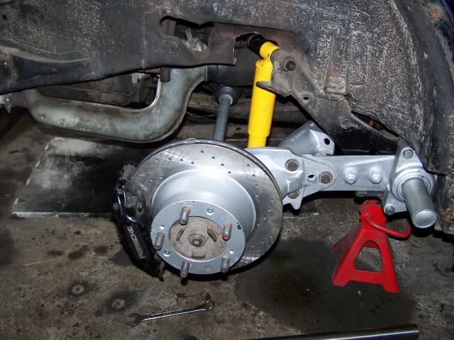

The rear suspension and brake parts on the car.
http://i129.photobucket.com/albums/p...2.jpg~original

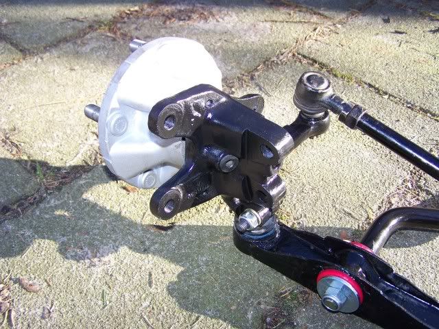

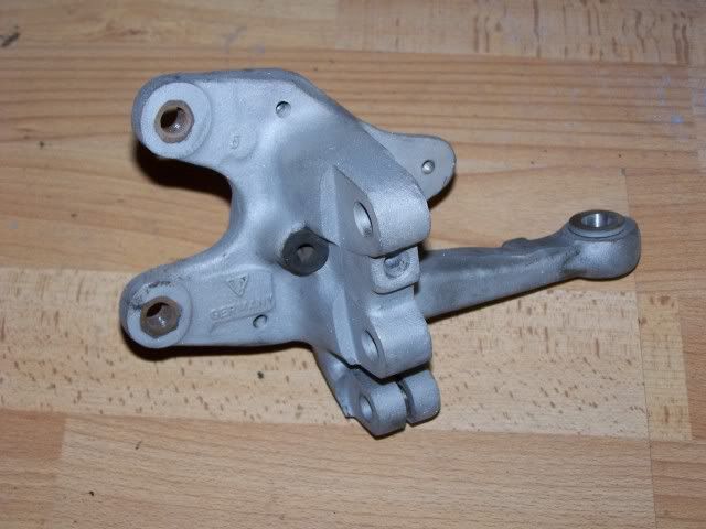

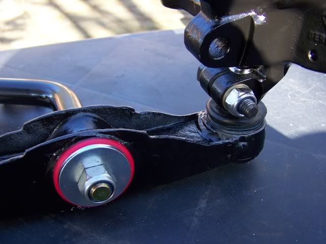

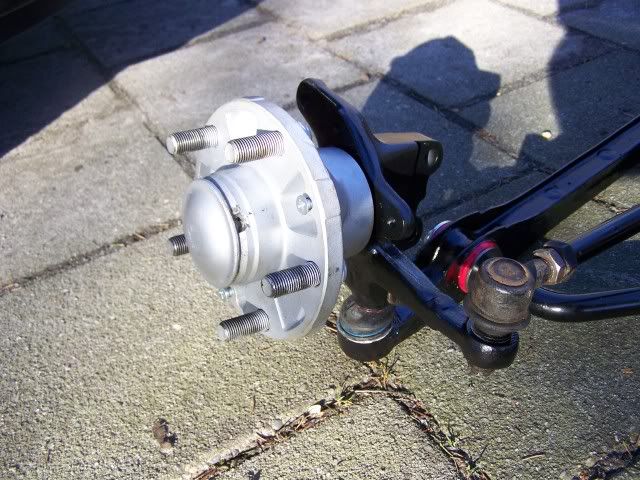

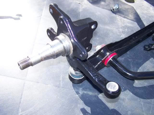

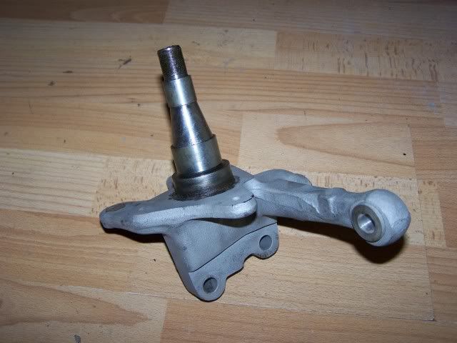

Front is still under construction. This is what I can show you so far.

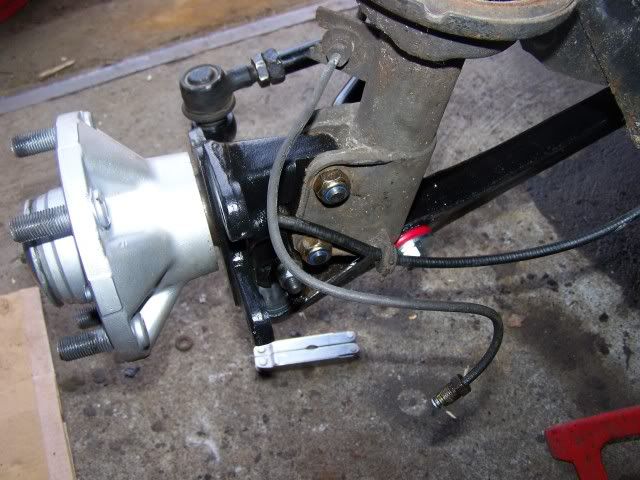

944 NA spindels with custom bearing bushes for the S2 bearings and a custom bushing to mount the steering rod on the top of the steering arm on the spindel.
http://i129.photobucket.com/albums/p...9.jpg~original

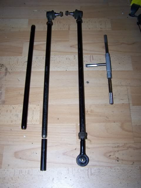

I shortened 2 long (LHD right side) steering rods from a regular beetle to use with the 944 NA spindels and a rack and pignon steeringbox which is standard in a '75 super.
On the left is a standard length '75 > steeringrod. In the middle is a shortened rod and on the right the complete custom length rod.
