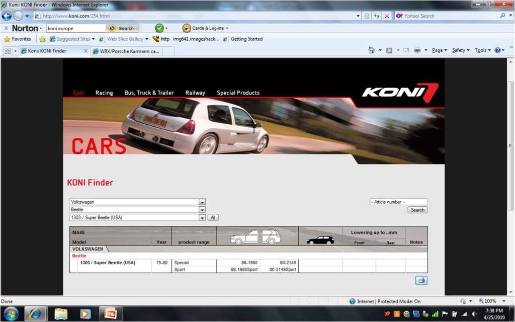

Was at Borders the other day, and I noticed in one of the mags that Koni europe had a sport yellow application for the 1303.
Was curious if anyone else was familiar with these struts and if they have used them.
Pic from the Koni site with part numbers:
1303 / Super Beetle (USA) Sport Yellows
Front: 86-1980Sport
Rear: 80-2149Sport
When I searched on the web the part number it came up as a 924 strut.. I am familiar with a short version, but was unsure if the threaded section was similiar and usuable with the VW topmount..
http://www.dcdezign.com/cheap/315759...1980sport.html
I also checked the usa site and they had the part as a 1303 part.
http://www.koni-na.com/pdfcatalogs/2008_Full.pdf
Has anyone use these, as they are single adjustable.. assume rebound and with a little dremel action, I can put some collars and coilover springs and run these instead of the maxx struts I have.. I would assume these would be lighter and I would not have to worry about machining rabbit inserts for the beetle..
I called about a pair of yellow I had from a 944, and I will assume like those are NOT rebuildable.. but when I have time will call and double check..
VR
ALex

From the catalogue I thing the Koni's are all inserts for the front, whether Classic or Sport. I would be surprised if either reference referred to a coil over strut.

Last time I was in europe i picked up a set of each. Got a good price. Yes they are adjustable. although not top adjustable, must compress the rod and turn clockwise or counterclockwise. I was talking to a Koni rep and he told me that these koni sports part # are still hydraulic shocks not gas. They have a stiffer setup than the equivalent red's. He also stated that they are excellent for lowering since the start rate is equivalent at any height in the shock. Apparently they are rebuildable, also becareful not to bottom them out as this would probably damage the adjusting mechanism.
sbeetle73 April 30th 2010 12:23
Sorry forgot to mention, that they are inserts in the front. Actually the same part # is used for the early 944's.
Bug@5speed(US) May 1st 2010 18:38
Sbeetle,
Thanks for the heads up.. Clive's assumptions were correct..
@clive.. no issues with inserts... just looking for something different.. Guess I will be going down this route.. with a can of School bus yellow :)
