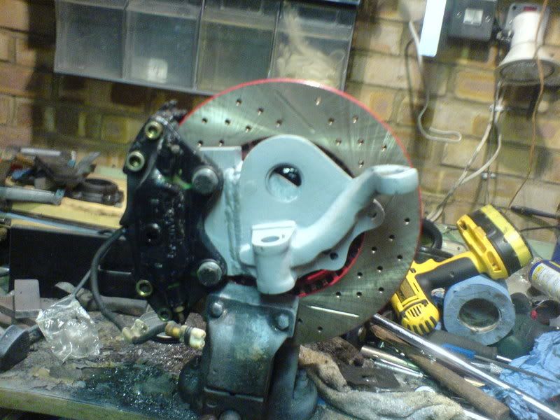

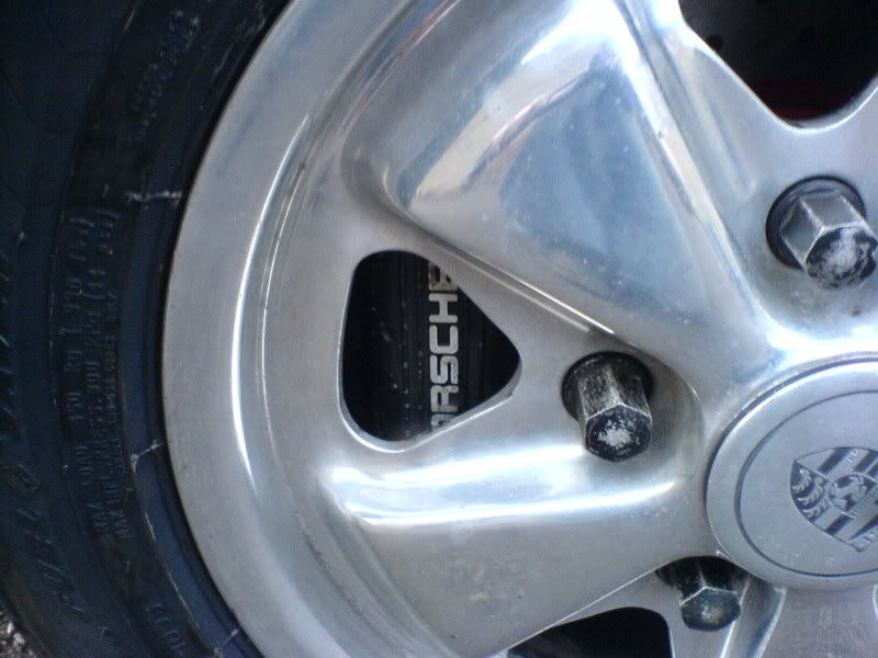

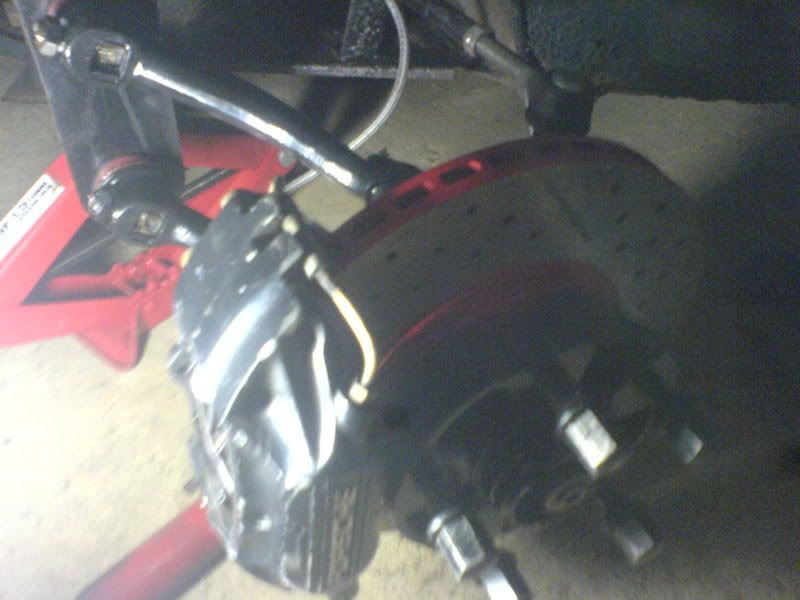

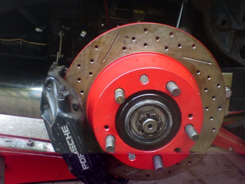

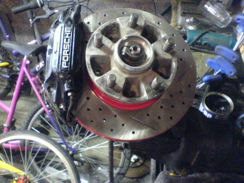

Fast65 September 13th 2010 16:26
Hi good work, i did the same to my 65 slightly different though
http://i71.photobucket.com/albums/i1...8.jpg~original
http://i71.photobucket.com/albums/i1...9.jpg~original
http://i71.photobucket.com/albums/i1...2.jpg~original
http://i71.photobucket.com/albums/i1...7.jpg~original
and the rears :)
http://i71.photobucket.com/albums/i1...0.jpg~original
cheers andy
