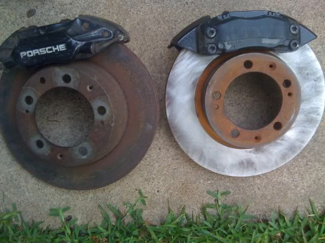

I also got a set of huge brembo front calipers/rotors off a ML430, but I need decide if I'm going to go with 5x130 or 5x112. Right now i'm leaning to 5x130 since the rear brakes would be a lot simpler to sort. I need wheels to, I have a soft spot in my heart for Cup 2 wheels.

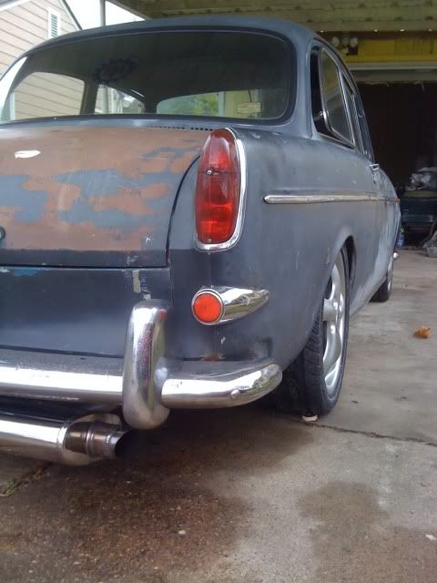

Damn it's been over 6 month's since I updated you guys. I think it was may when I finally got this thing running. The bus Ljet sucked so I ditched that and installed some 38mm gsxr throttle bodies...much better :D

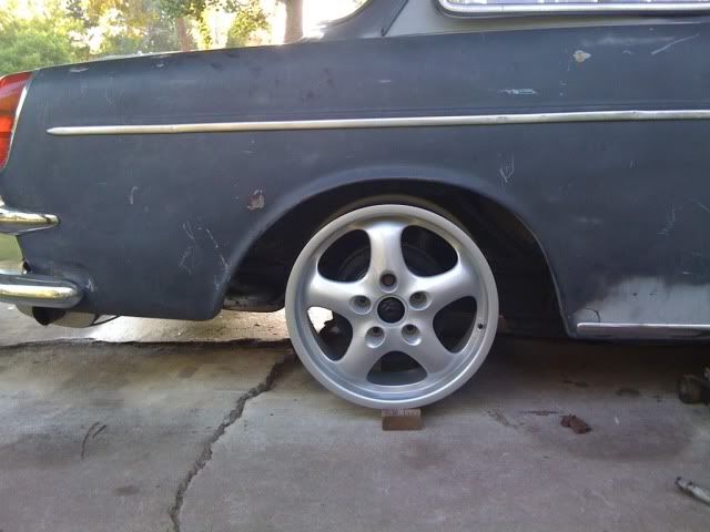

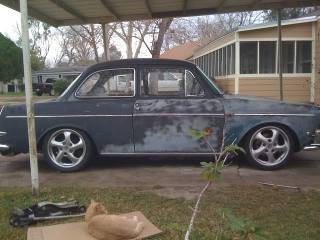

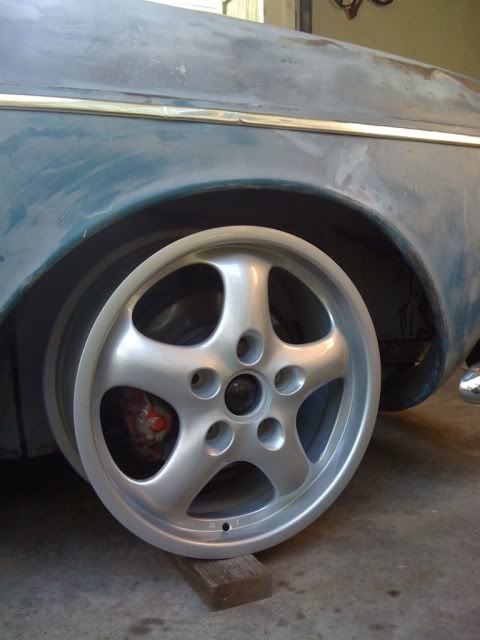

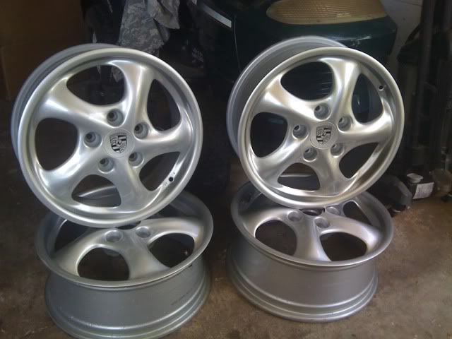

So I finally decided to plunge into the GL theme with this car, here's what I'm doing as far as brakes/suspension and wheels:
IRS subframe
944 S2 torsion bars
944 early Al control arms
944 turbo rear brakes
928 S4 front rotors
Mercedes ML430 front calipers
7" twists
http://i59.photobucket.com/albums/g2...d.jpg~original
http://i59.photobucket.com/albums/g2...6.jpg~original
http://i59.photobucket.com/albums/g2...e.jpg~original
I got a lot of work ahead of me this winter:)

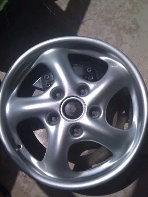

Supa Ninja October 5th 2011 19:04
Cleaned up the twists
http://i59.photobucket.com/albums/g2...f.jpg~original
