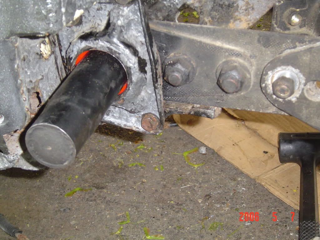

Removing the spring plate can be considered a thread onto itself, I will suggest anyone removing spring plates to invest the 20-30 dollars and buy the spring plate retaining tool, you will need this a few times so might as well be safe and do it right. There are a few threads covering this so I won't go into those details.

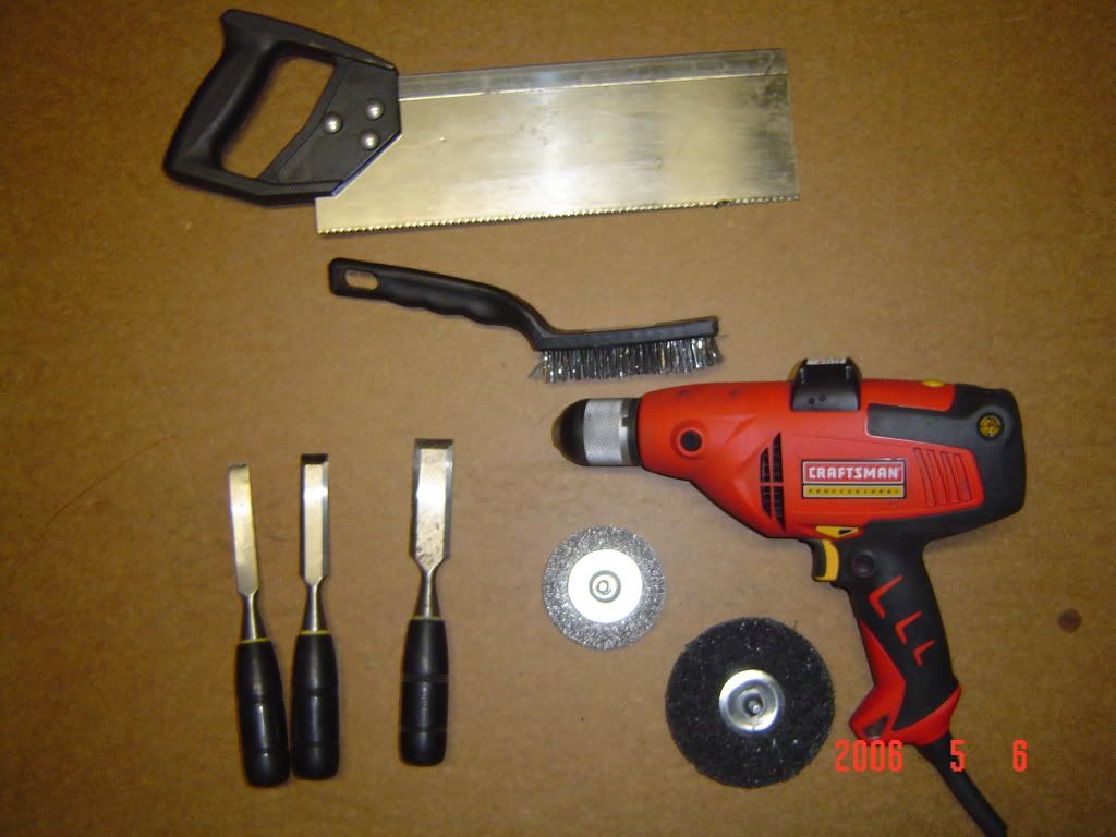

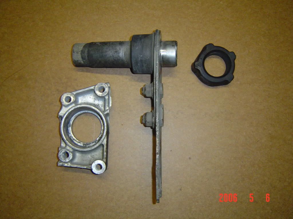

1. Equipment Needed- As far as what I used to remove the bushing from the plates can be seen in the below pic. Essentially, a saw to cut large chunks, a chissel set to remove smaller chunks. Just use caution to not score the spring plate, a few grinding wheel attachments. I believe one is a 3M pad from autozone for removing paint and the other was a scotch bright material pad. Lastly a brass or aluminium cleaning brush. Take your time and it will all come off.

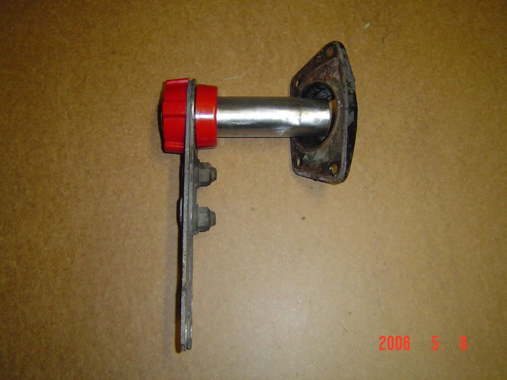

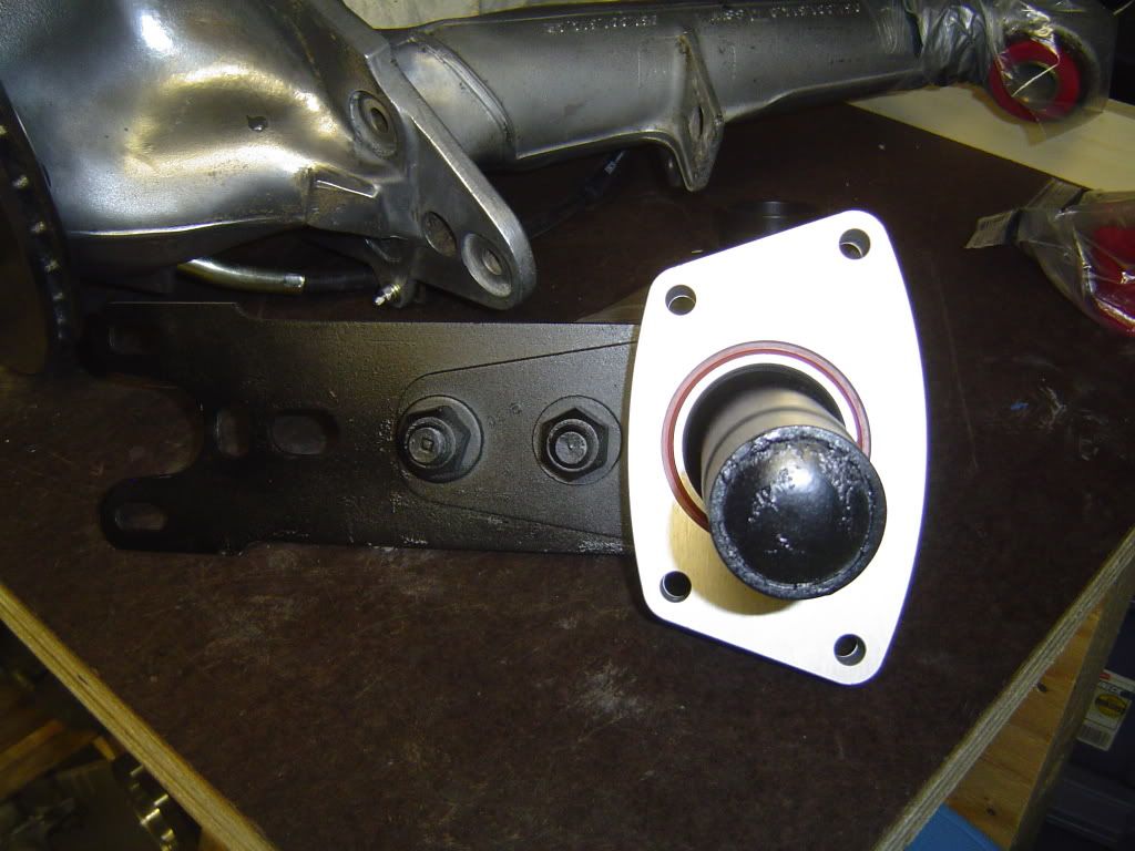

2. Spring plate options. Essentially there are three options that I am familiar with.
Option1 is utilize a cut down 944 torsion bar cover plate. This requires some trial and error to cut down just enough of the 944 cover to fit and not interfere in the bug wheel wheel. Essentially you will utilize (From left to right)- 944 cut down spring plate cover, 944 outer bushing, 944 Spring plate and VW bug inner bushing (OEM rubber style shown)

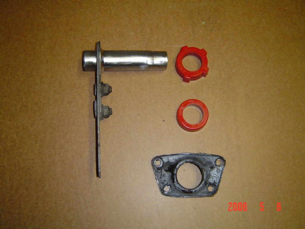

Option2 is utilizing VW OEM style torsion plate with VW beetle OEM or Poly Bushing. From right to left- Poly VW inner bushing>944 Spring Plate>VW Outer Bushing>OEM style cover

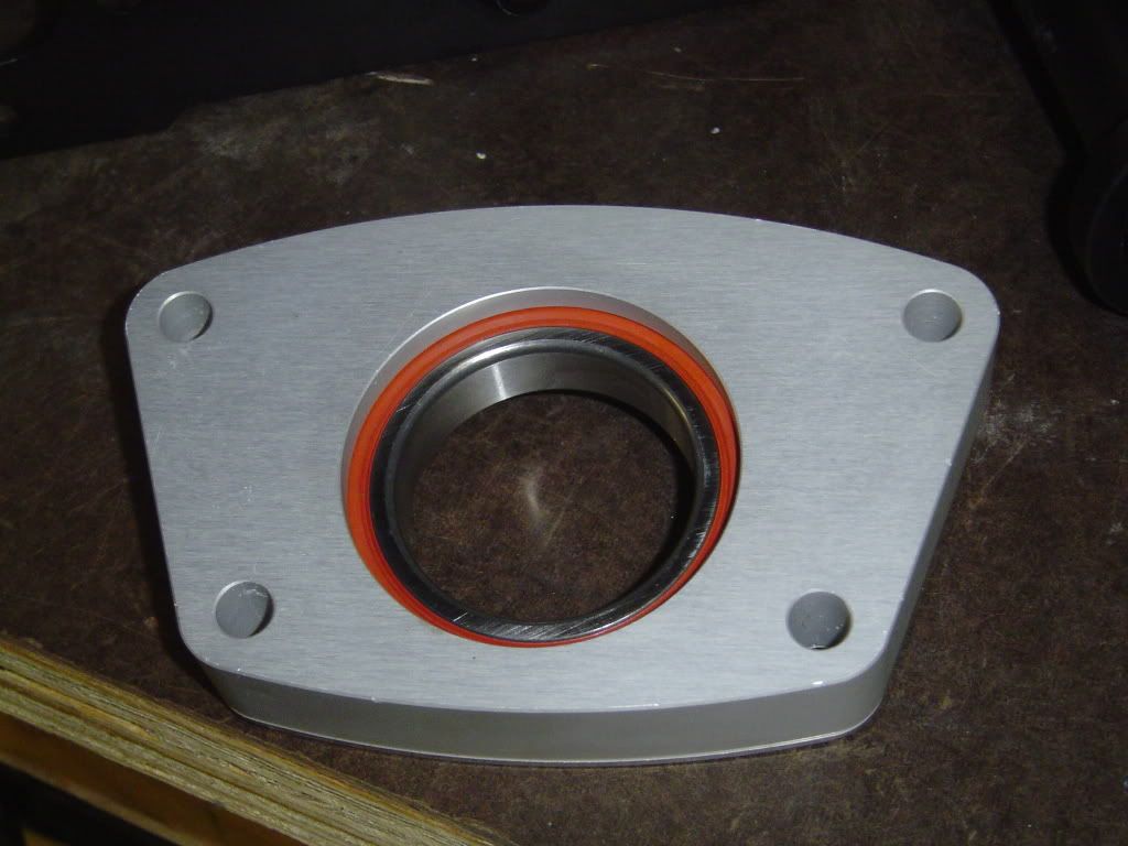

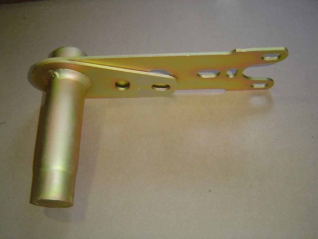

Option3- is utilizing a GWD torsion plate system. GWD is a german tuning company that specializes in bugs. They were part of the germanlook shootout that was in VW trends back in the day.. If interested I have scanned copies of that article somewhere.. Here are some pics, but essentially they use a delrin bushing that mates to the outer spring plate section, and they run through an alum housing that has a sealed bearing. Some grinding of the delrin bushing is needed to ensure a snug fit onto the spring plate but overall Pretty nifty.
http://i78.photobucket.com/albums/j1...9.jpg~original
These are the three popular approaches that can be utilized without going uniball style plates. Incidently the GWD can be utilized without Torsion Bars (TB) and coilovers if needed.

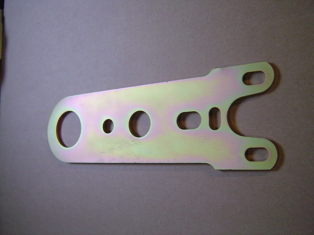

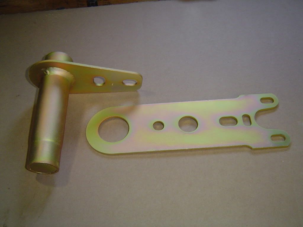

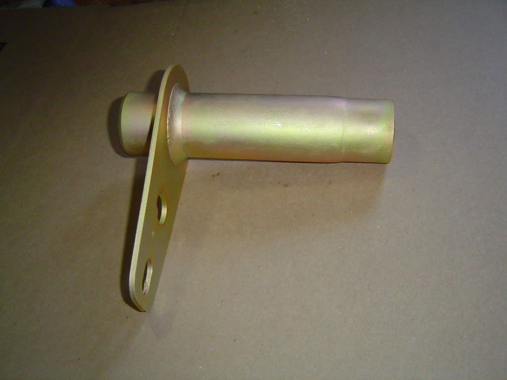

3. Now that you have determined which approach is best for you based on skill, budget and time, there are a few things to prep the spring plates.
Again a few options:
- remove them and wire brush them clean and replace. (Personnally if you made it this far, why not spend the extra time)
- Dissassemble and sand blast them and paint
- Or my personnal favorite, is dissassembley, sand blast and plate- For this project I utlized a Yellow Zinc plating. Not sure if there are variations but I think the OEM style that is shiny is better as this yellow is not to scratch resistant. So you want to know what the spring plate looks like when fully dissassembled :)

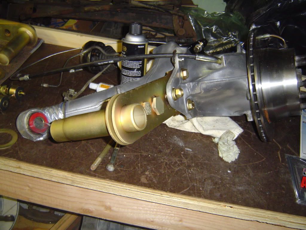

Here they are trial mounted on my polished 944 arms which I caught some hell for.. incidently I just finished cleaning and started polishing the other arm in preperation for brake assembly :P
More info coming

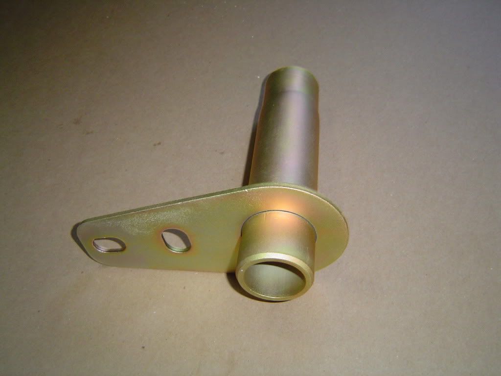

Bug@5speed(US) July 28th 2010 22:55
Last thing, since this took a little creativity and leveraging of ideas from folks like Clive (want to give credit here, since we were thinking the same thing at about the same time, but he posted the idea first)

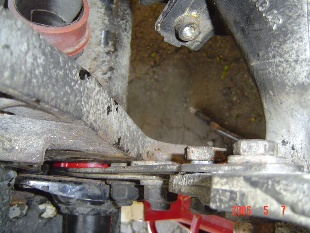

When utilizing 944 style spring plates you may encounter clearance or interference issues, these are well documented in older posts which discuss this issue. Some options to remedy this include grinding, cutting of the webbing for the TB housing and other creative ideas.
Clive and I both realized that by pushing the plates outward some how we may be able to clear the TB housing and not have any clearance issues. I believe he is or will be using plastic spacers of some sorts. I decided to go a different path and use some steel shims.

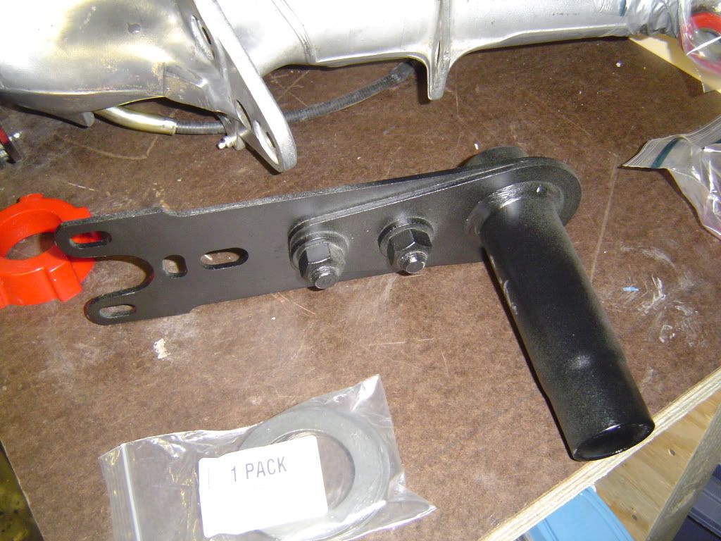

The company I used is called Mc Master's http://www.mcmaster.com (NJ location)
Pics of the shims, 2" ID, by 3" OD, and about 2mm thickness
Here is the spring plate, after sandblasting I realized that I should have loosened the two bolts, so I did not finish painting.
With 2 shims, you are about 4mm, with 3 shims you get 6mm, which is what the bolts height is. I will have to trial fit when the weather gets better and see how many it will take. May need to get longer bolts, but will see later on.
The shims are low carbon steal. I tried to find higher carbon, but was not available, as well as other materials. Since they are prone to rusting I took the liberty and had them yellow zinc plated also. I will utilize some good swepco grease to help prevent rust.

Bigbadbugga September 16th 2010 19:57
Where can I buy a pair of the GWD torsion covers?
I have tried to find their site but the only one I can find seems to not work very well:(
Bug@5speed(US) September 16th 2010 23:45
Did you try this site?
http://www.gwd-weiser.de/infocenter/
VR
Bigbadbugga September 17th 2010 05:41
Yes, that's the one.
Can't navigate the site at all, it just hilights the text you select. And yes I have tried google translate.
I'll email them I think and see if they can answer my query's that way, thanks for your help:)
Bug@5speed(US) September 17th 2010 08:11
I had a friend lend a hand, so I did not formally go through them..
Can't remember if they spoke english..
Let me know how it goes, if not I can check via my college if they got your email..

Simon November 17th 2010 19:12
Has anybody over here actually run the GWD torsion bar covers (in a daily)?
How do they compare to stock, urethane or a uni-ball setup? Is it too harsh for a daily driver?
Bug@5speed(US) November 17th 2010 23:52
I drove my college's car when I was in germany and as far as NVH I could not draw any direct conclusion that it was attributed to the spring plates.
Mind you he also has coilovers, low profile tires and kafer bar set up.
Car is driven by his wife at times.
Just a data point
