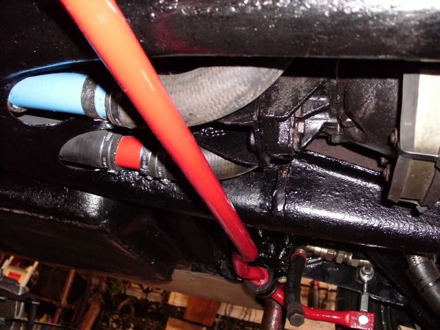

Steve C August 18th 2010 18:57
3 Attachment(s)
I kept these photos in my German Look folder, I think Kersher make them.

al_kaholik August 19th 2010 08:57
I have the set that Steve has pictured. They are on the Kerscher website http://www.kerscher-tuning.de/kaefer...Stabilisatoren
Good quality and you can swap out for the Porsche bushes - I'm planning that with my 16mm rear bar

Steve C August 19th 2010 10:22
On the 944 sway bar the outside clamp is from a 1302 or 1303 Beetle front sway bar.

Steve C August 19th 2010 23:04
I don't know about others but I've had the clamps on the torsion bar housings walk around, so once I'm happy where everything is sitting I put tack of weld on the mounting plates & torsion bar housing.
