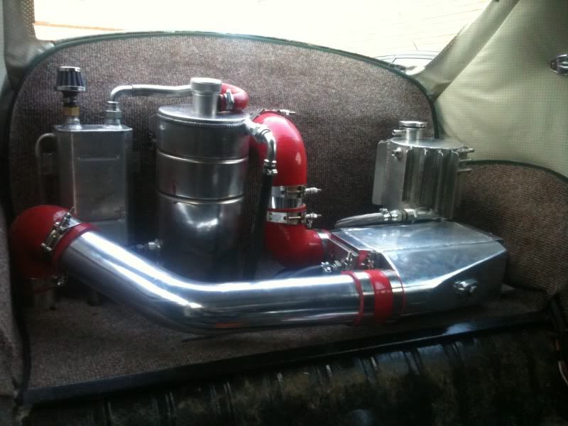

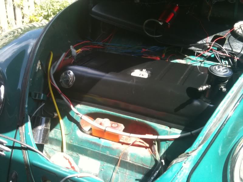

Oil Tank?
Hi, is that a oil tank behind your rear seat? If so, is it vented to the inside also?
Fast65 September 13th 2010 13:13
hi yes it is an oil tank it does vent out side, the breather was put there so i didnt loose it lol
cheers andy

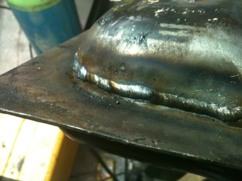

Did you weld a 944 spindle to a CB spindle?
yes and it is also bolted i have had the welds have been crack tested :)

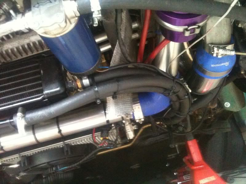

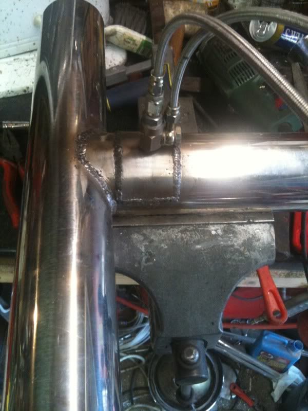

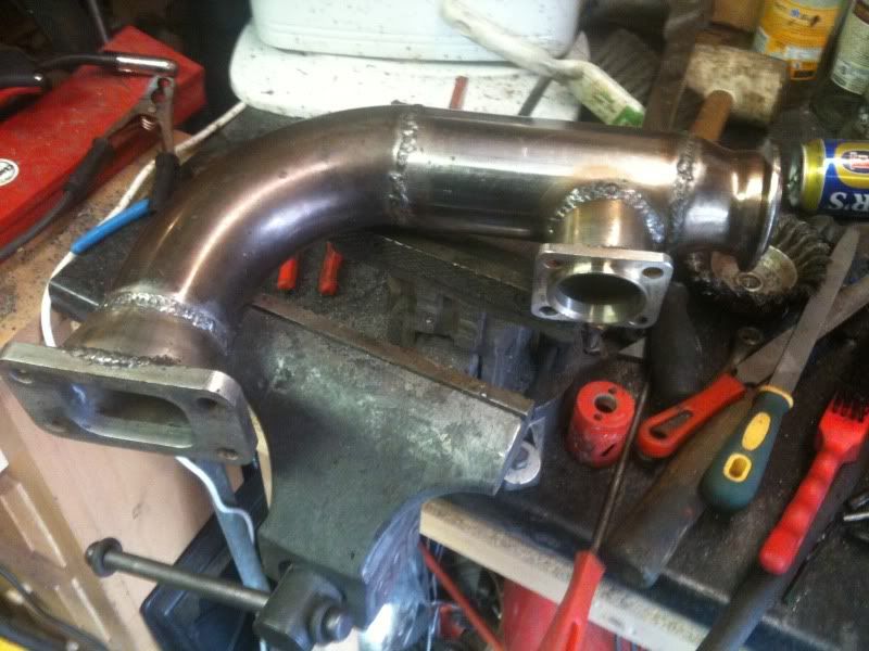

That would make it much nicer off boost, do you have any photos of the turbo pipe work after the A1s?
Fast65 September 14th 2010 13:00
hi yes
http://i71.photobucket.com/albums/i1...2.jpg~original
http://i71.photobucket.com/albums/i1...0.jpg~original
and the inlet
http://i71.photobucket.com/albums/i1...9.jpg~original

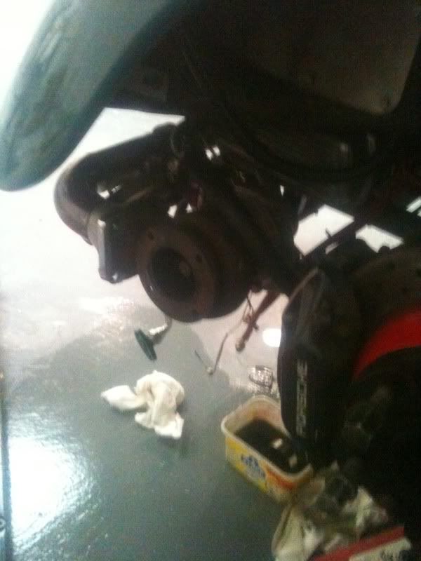

got to change alot of it now as the turbo oil seals failed :(
cheers andy

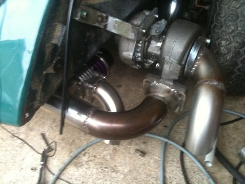

Fast65 September 14th 2010 13:22
old holset off and thers still oil coming out another pint
http://i71.photobucket.com/albums/i1...r/IMG_0746.jpg
the two together
holset is the top one, T4 is the bottom one the T4 has a smaller exhaust and larger compressor wooo :)
http://i71.photobucket.com/albums/i1...r/IMG_0747.jpg
turbo trial mounted it all looked good until I tried the wheel know its all got to move now but not sure were yet maybe under the boot floor
but thats for tmw
cheers andy

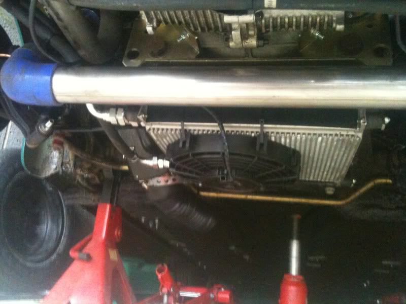

cheers thanks i cant wait to get some numbers i would love to get 400hp, and yes you soon run out of room
oil cooler here

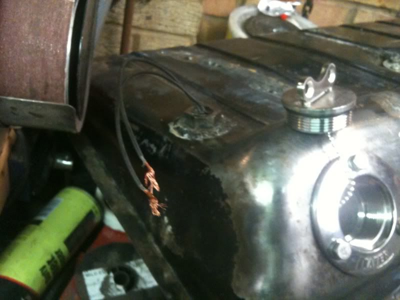

http://i71.photobucket.com/albums/i1...4.jpg~original

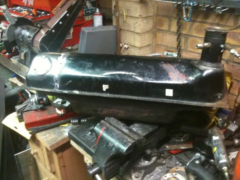

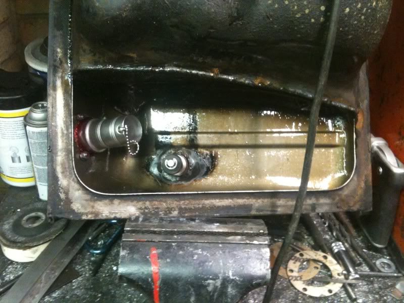

look what i did to fit a water injection tank :lmao:
http://i71.photobucket.com/albums/i1...6.jpg~original
http://i71.photobucket.com/albums/i1...8.jpg~original
http://i71.photobucket.com/albums/i1...5.jpg~original
and ive hidden the pump under the feul tank :)
cheers andy

ricola September 20th 2010 17:29
Love how you integrated the water tank, but wouldn't you have gained a lot more volume by putting the filler at the top?
