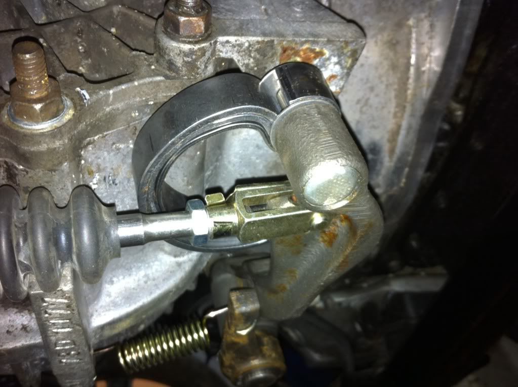

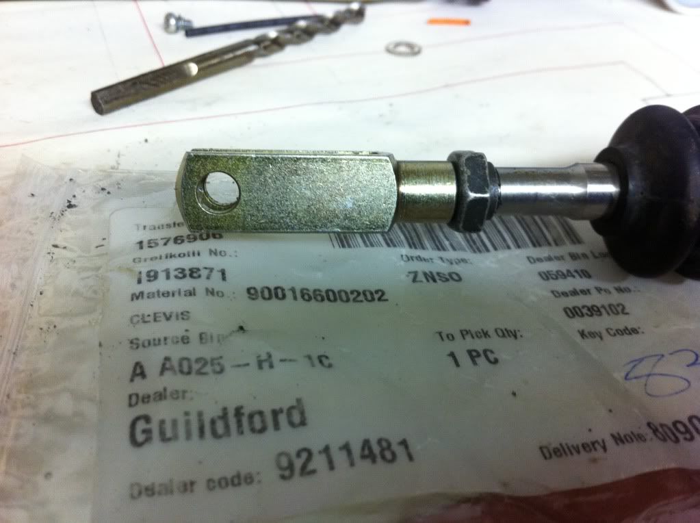

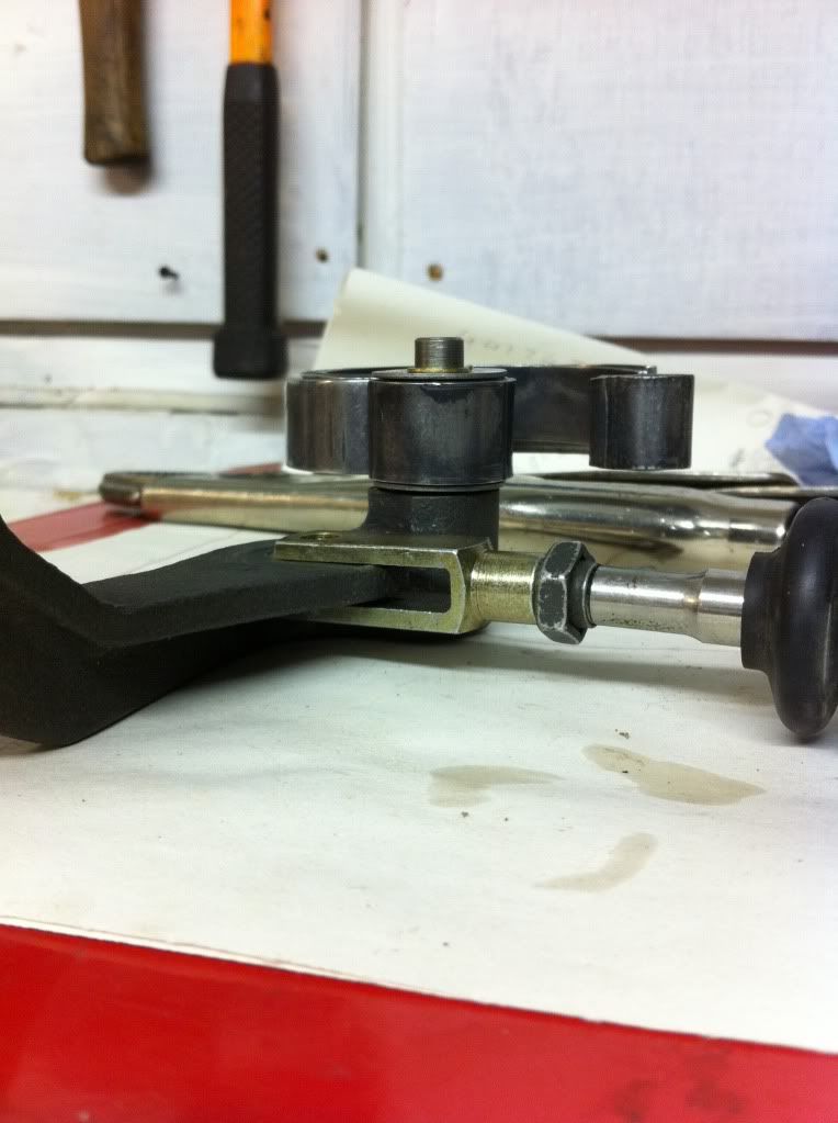

The clutch arm end has turned out to be easy. My neighbour made me a clevis pin which turned to to be overkill and was too big as it fowled onto the omega spring. I decided to talk to my local Porsche again to find out how how the cable was originally attached. Due to an error through our conversation over the phone I ordered A part which is the wrong part but has turned out to be perfect for what I'm after, just need to order the rest of the pin.

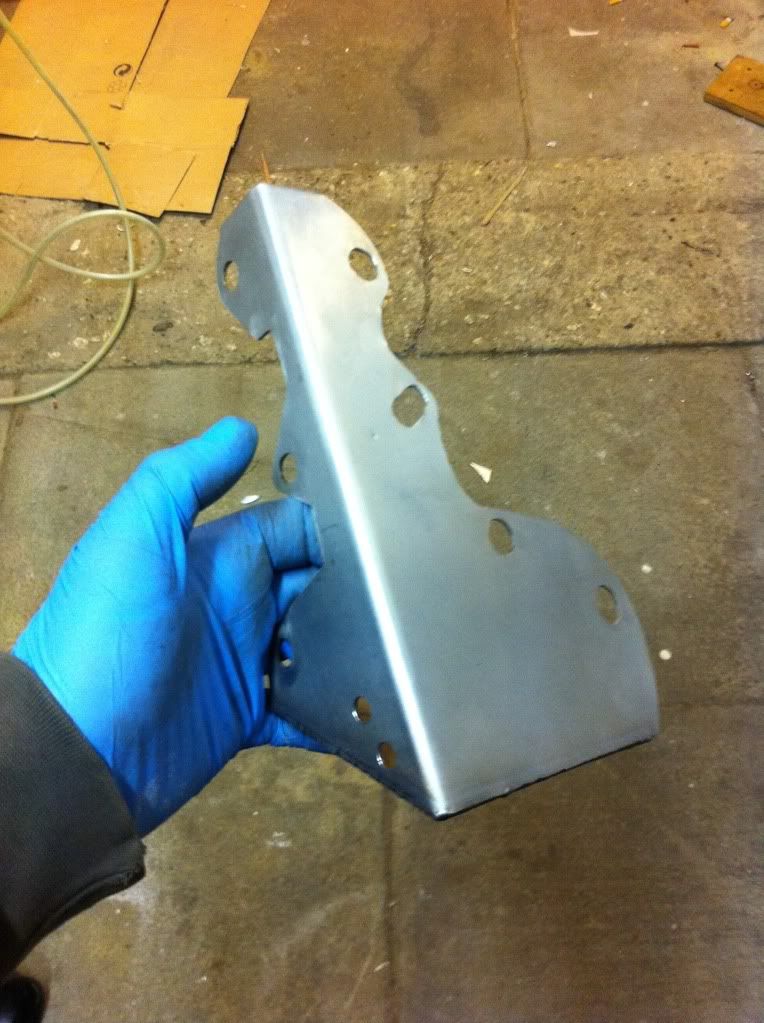

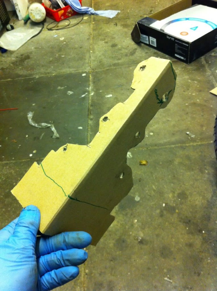

A bracket that'll resemble this

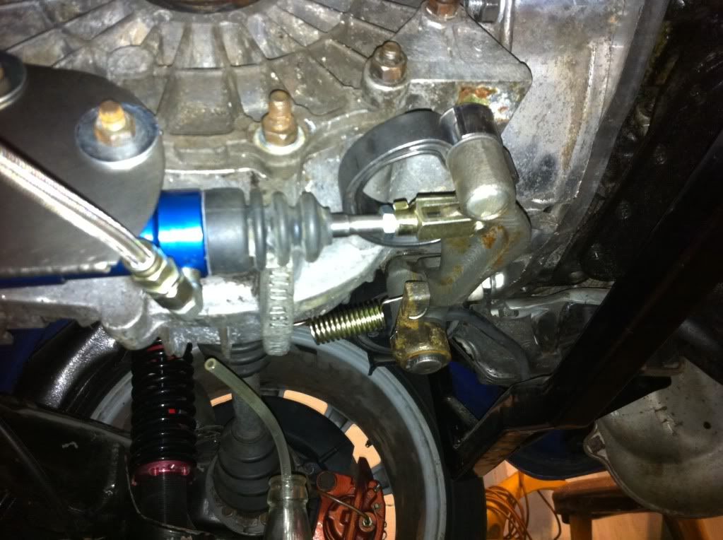

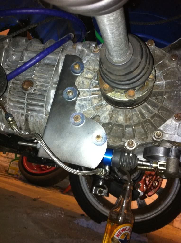

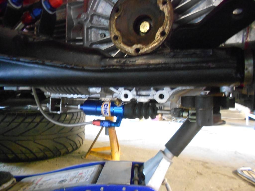

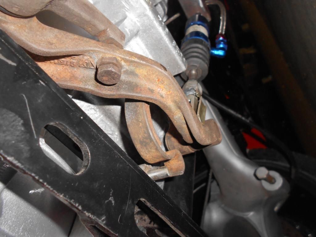

It would appear that I've nailed it. I've not road tested it and from what I can tell the slave and the arm are going through their full travel.
I've still got the 3-4mm line installed. The pedal is firm, feels exactly the same to my old cable set up with the type one box and stage 1 KEP pressure plate just alot smoother.

Wally November 12th 2010 17:00
Nice install! Very clean.

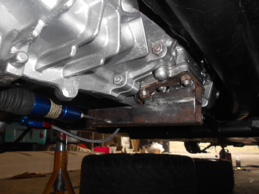

I have just mounted my slave in a similar way - from the gearbox housing - but being in a beetle with framehorns it;s not possible to use the diff housing/intermediate housing bolts the way you have. i'l find out tomorrow if it works once ive finished the hydraulic line! im not sure i understand how the omega spring works yet either :lmao:
dub_crazee March 1st 2012 17:25
http://i1104.photobucket.com/albums/...7.jpg~original
http://i1104.photobucket.com/albums/...9.jpg~original
bit crude but it seems to work for now. If i dont have any issues with it i'l make something a little better looking.
