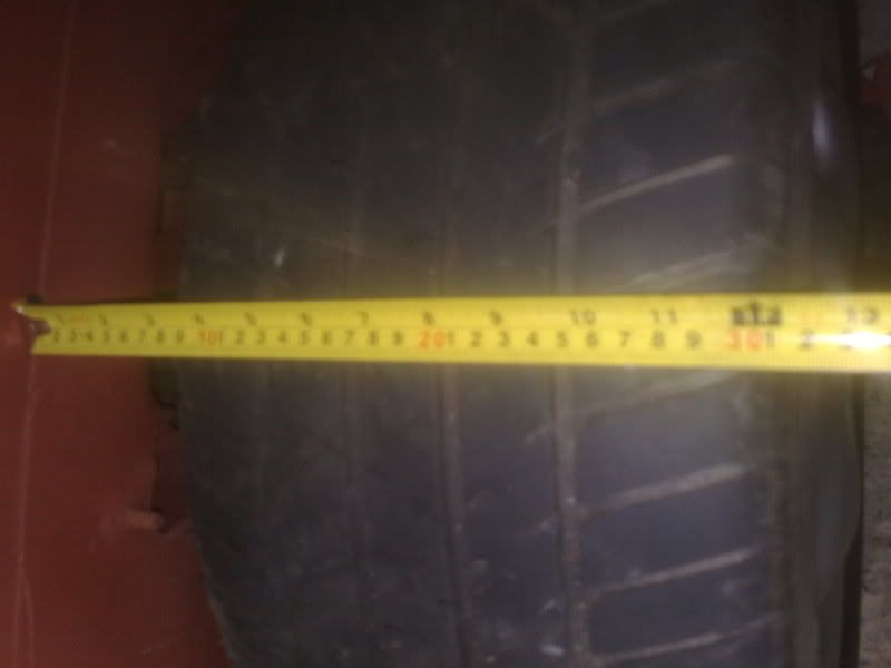

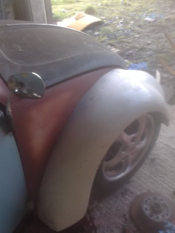

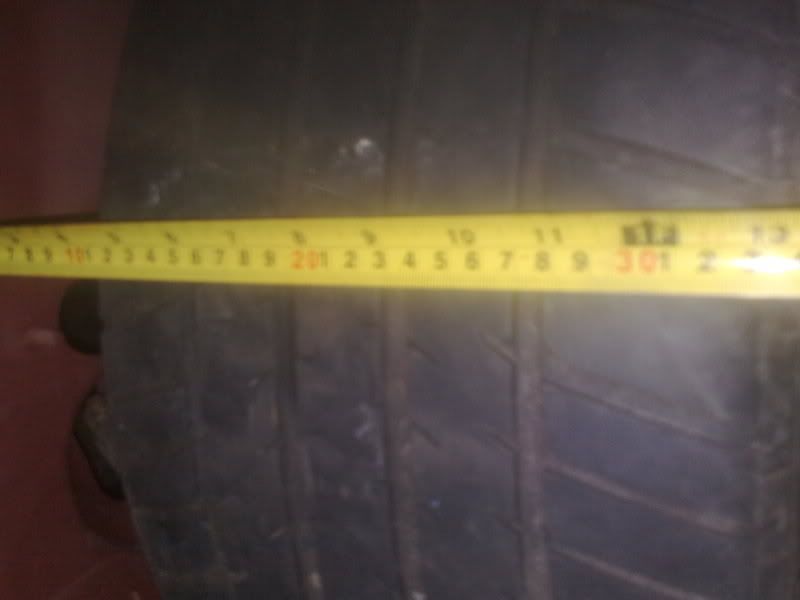

Heres the problem. i didnt notice until i put the wider wings on the back, but theres a big difference in measurement from outside of wheel to inner arch bodywork. this means the drivers side rear wheel is tucked in, approx 1 1/2 inches, where pass rear is nearly touching the wing? whats going on?
ive doubled checked offsets and widths are same etc, it seems to be bodywork.
on the pass side, from outside face of tyre, directly above centre of wheel it is approx 13 1/4 inches. on drivers side from outside of tyre to inner arch is 12 inches.

drivers side: wheel sits tucked under wing
[IMG]http://img.photobucket.com/albums/v3...3.jpg~original~original[/IMG]
pass side: wheel sits level with wing
http://img.photobucket.com/albums/v3...4.jpg~original

measure from the chassis somewhere if you can-shock bolt or spring plate bracket maybe? also are tyre sizes the same? guard widths? you have a few mm of play in body bolts as the holes in the floor are slotted slightly, also something to consider is the IRS arm bolts/bushing/washer combo may be different, the two washers are about 6-8mm thick together from memory so that may be a factor :)
buggyboyshane November 17th 2010 14:14
thanks for the reply, its swingaxle rear, ive measured from centre of gearbox drain plug to springplates and its the same on both sides, im thinking must be the bodywork.
