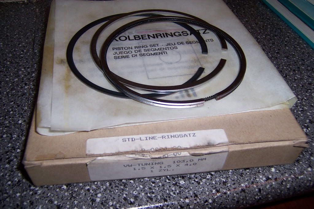

Wally January 20th 2011 16:53
As I expected somewhat, they are made by Goetze. See pic for sizes and shape. I think this is what you meant? I kept the original box these came in...yeah, I am a freak :lmao:
Did you break one while installing? What happened?
You can have this one free of charge. Lemme know if you can use it and I'll post it to you ;)
judgie January 21st 2011 04:29
Wally your a star. engine came to me to be built after being striped to put a bigger cam in it, that never happened and somewere along the line a oil ring got broke.
I'll PM my address over to you.
Cheers rob
judgie January 28th 2011 09:10
just want to say a big thank you to wally for sending me a ring. i can now finishing building this engine. seems you cant get new rings for these pistons.
