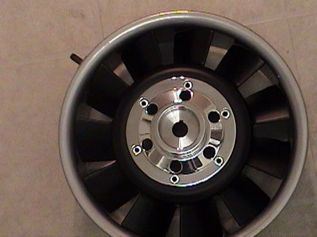

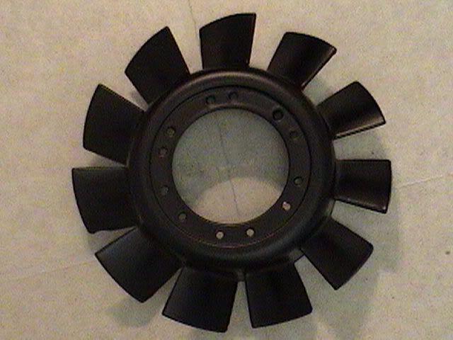

itHaKa April 25th 2011 15:36
finally we ended up machininig the fan so it can fit an earlier 911 housing

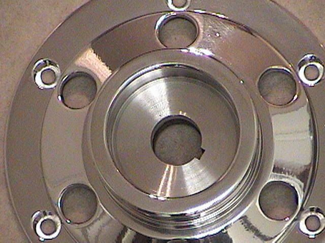

so we had to machine the alternator mounting , since the fan is wider , and decrease the fanīs diameter , also the hub had to be modified so it will accept the old key.
the good thing is that we can switch between fans on the same housing since all of them will fit

Hello, nice how you have over come the 12 issue. From what I have read, the 11 blade and it outter ring is bias to the 1&2 cylinder. Since you ommited the otter ring, you might have an even greater over shock of 1&2 cooling. I believe Wally did some work on the 11 blade and 12 blade. I don't know the in's and out's but try and ask him.
Lastly, I see your pullies, you may be loosing allot of why you are using the 12 blade setup, using the larger OD Alt pulley. Will the car be in cold climate? That fan needs to turn, even more at idle after coming to a stop in traffic and you engine has been working hard.
Just my 2 cents.

the problem with the housing is that it is a lot bigger, and we think there should be a poor amount of air to cilynders 2 and 4 ,we also doubt the deck lid will fully close, keep in mind our tests were done with a type 1 engine case , type 4 cases are very hard to find in Argentina.
As for the pulley, we can machine it to decrease the diameter, or we can put a bigger crank pulley . our crank pulley is a 5 inch diameter,just like the original Porsche diameter, we also have the option of a Scat Dry Sump power pulley or the usual 6 inch power pulley , we will measure the 4 cilynder cht and oil temps.

question, did you remove the fan center hub and chrome plated it ? , is that a custom center hub ?
it looks really nice, how did you bolt it again to the fan ?
regards

Fan Hub
Hi, the fan hub is custom due to I wanted to use a serpentine belt. I had my machinist create new holes and the hub bolts to the fan; it will have acorn nuts facing outward.
Please understand nothing is together as yet, I will start building in the next few months.
